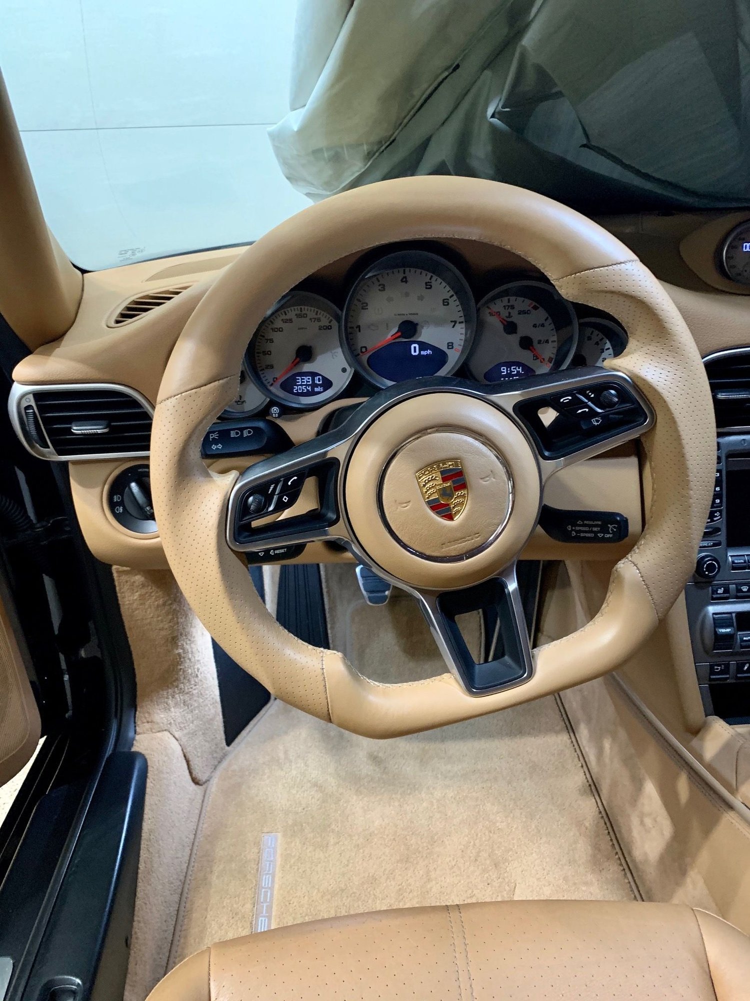

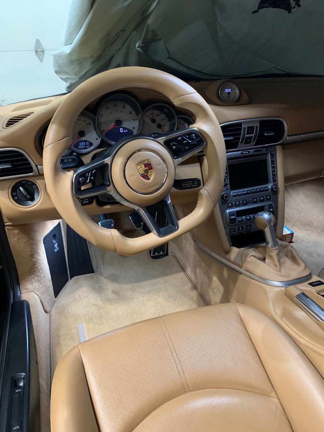

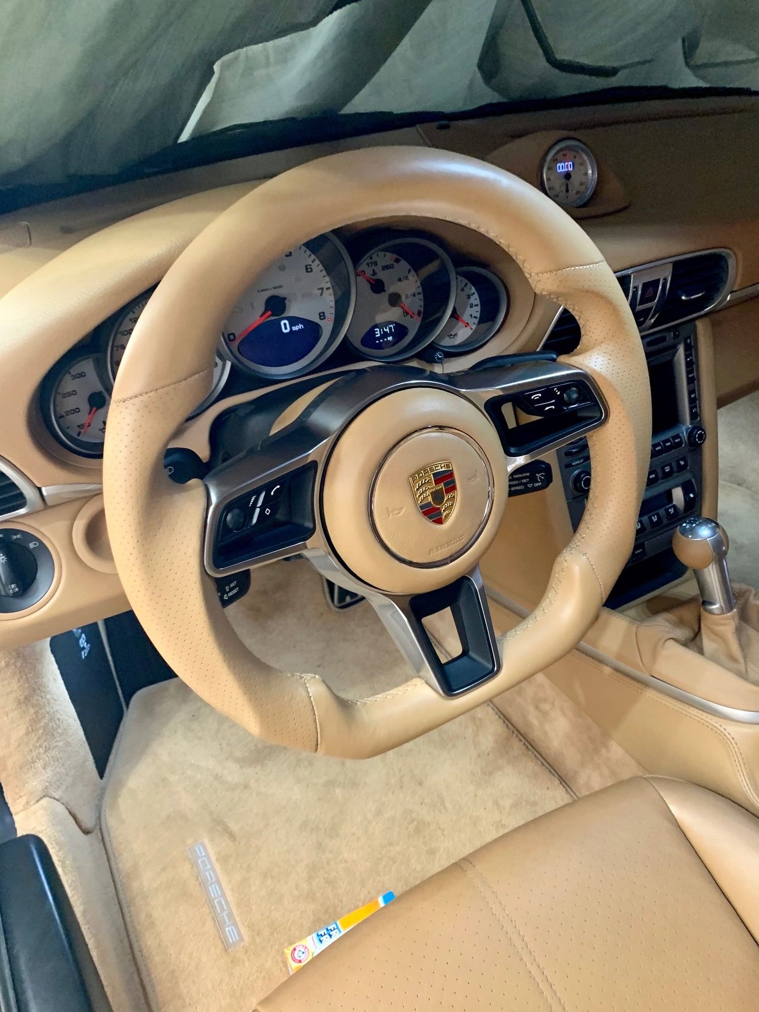

Ok, so i completed the swap and everything works including the horn. However, my airbag light stays on and when i pull the code i am getting "8007, Driver's front airbag stage 1 above upper limit". Anyone know what this code means?
Thanks in advance,
John
Old Mar 7, 2020 | 04:26 PM
  #203
jgoga's Avatar
Joined: Jul 2011
Posts: 12
jgoga is infamous around these parts
Thanks in advance,
John
All,
It was a pinched cable. Problem solved and airbag ligh is gone.
John
Old Mar 8, 2020 | 08:42 AM
  #204

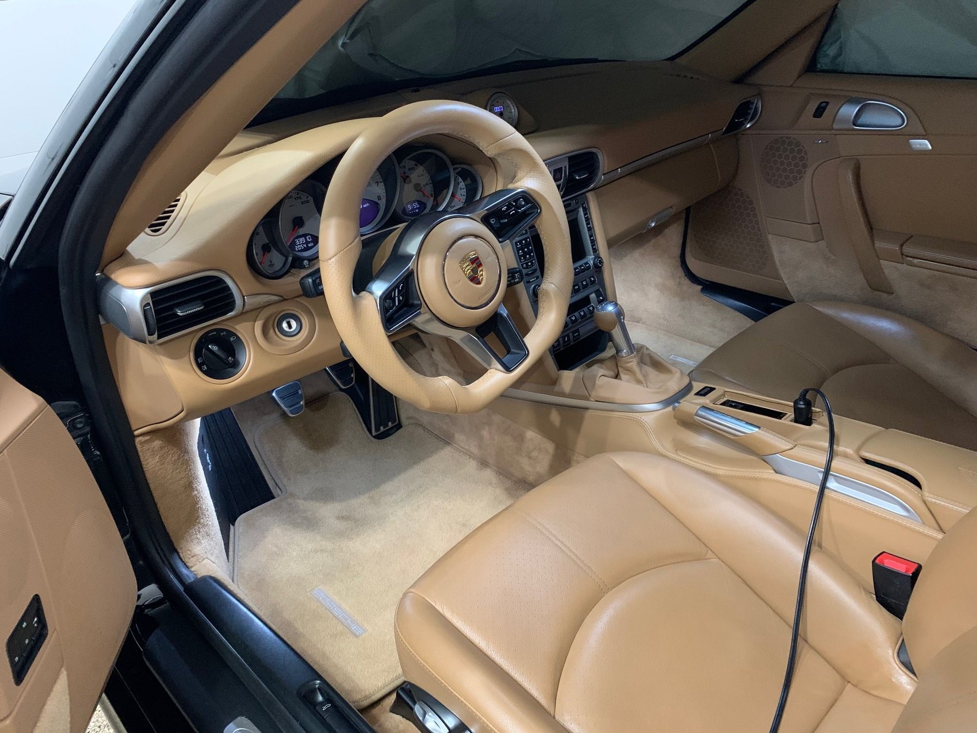

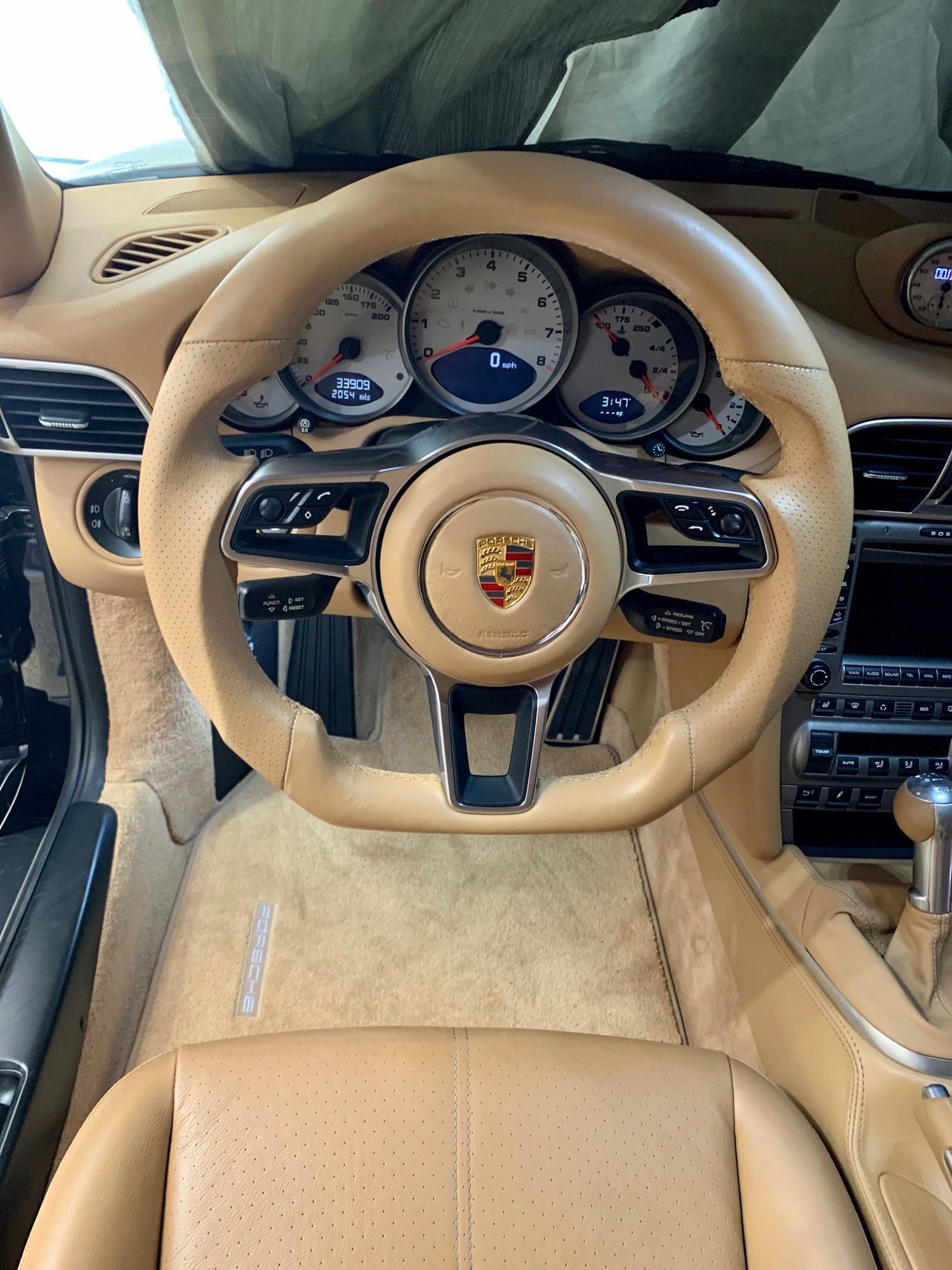

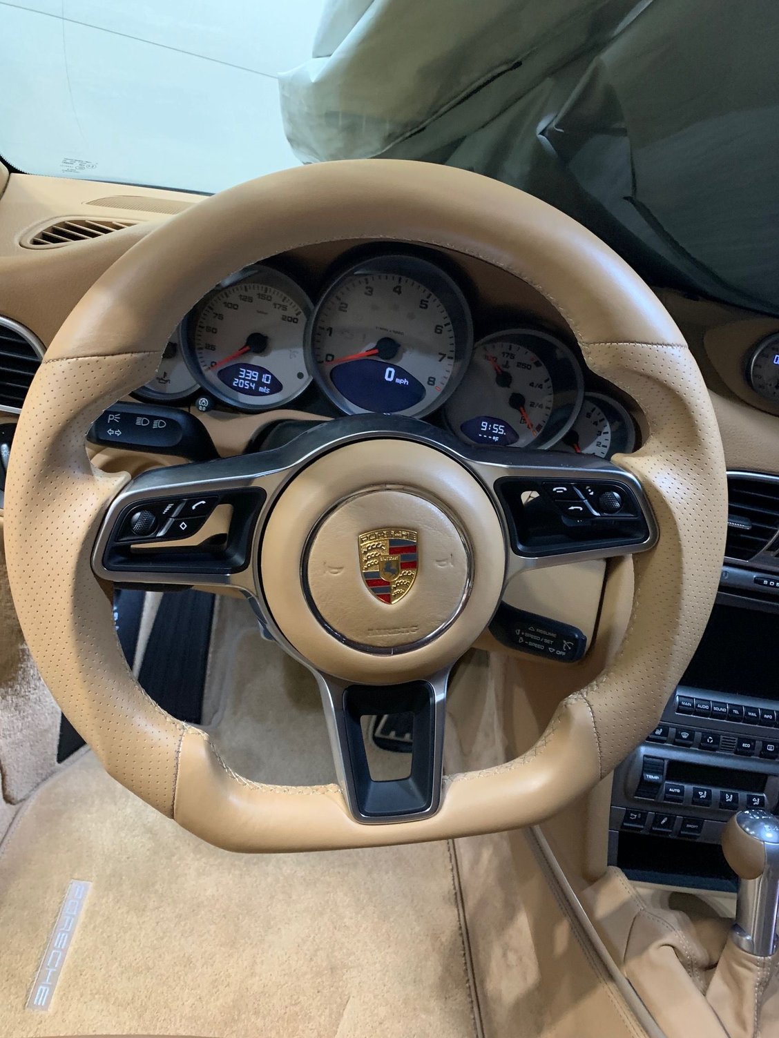

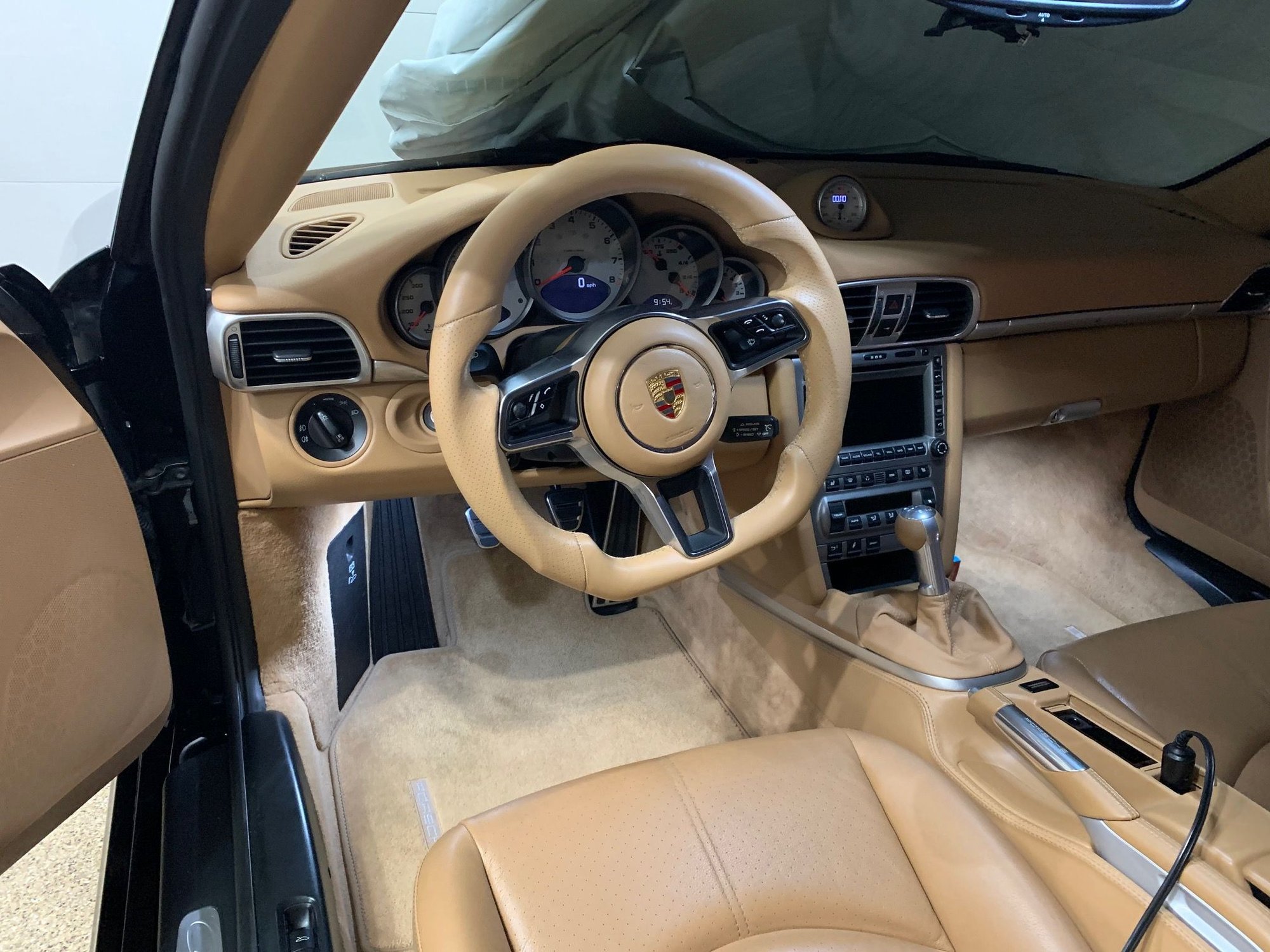

jgoga's Avatar
Joined: Jul 2011
Posts: 12
Some pics of the final product...
John

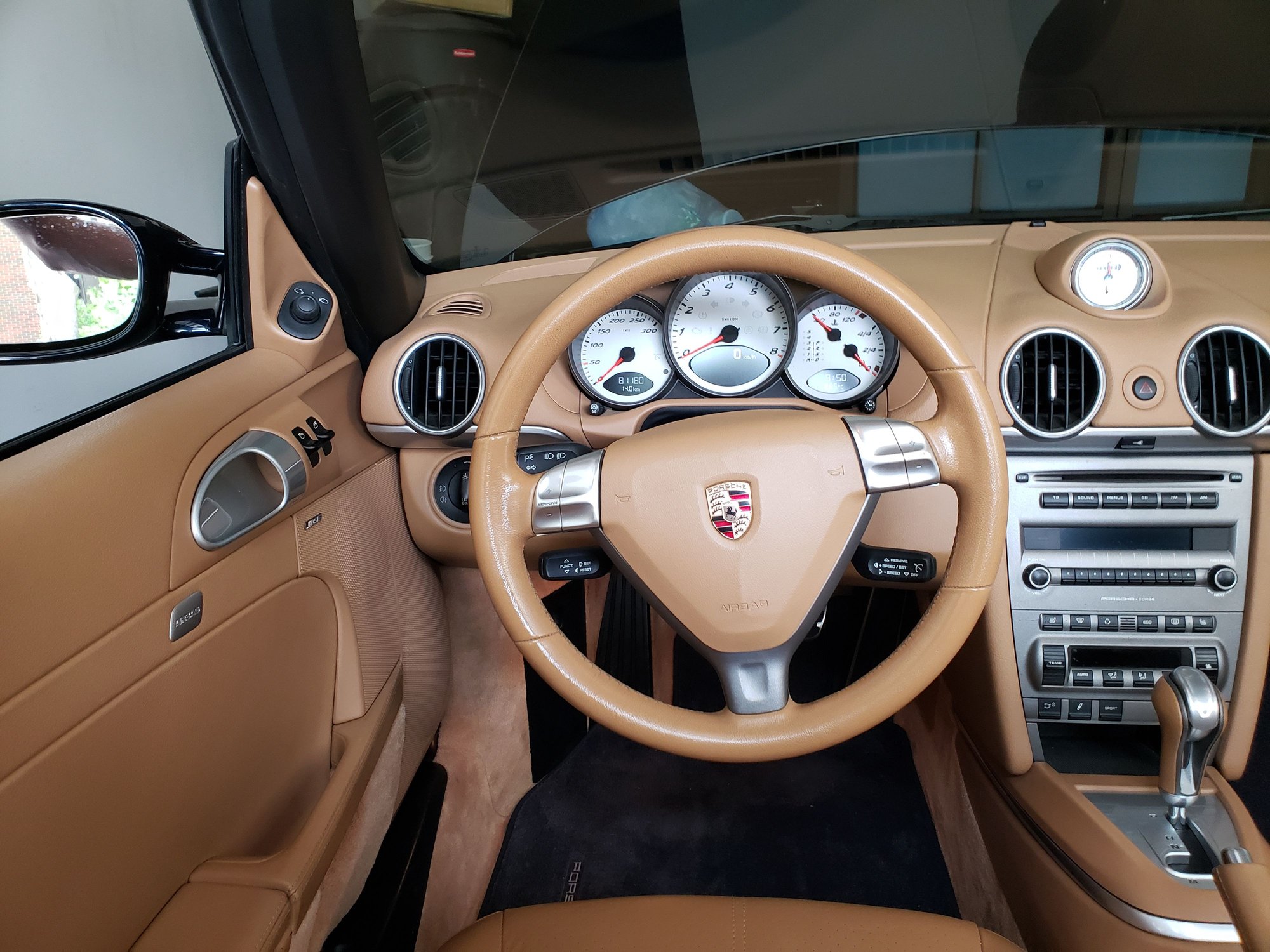

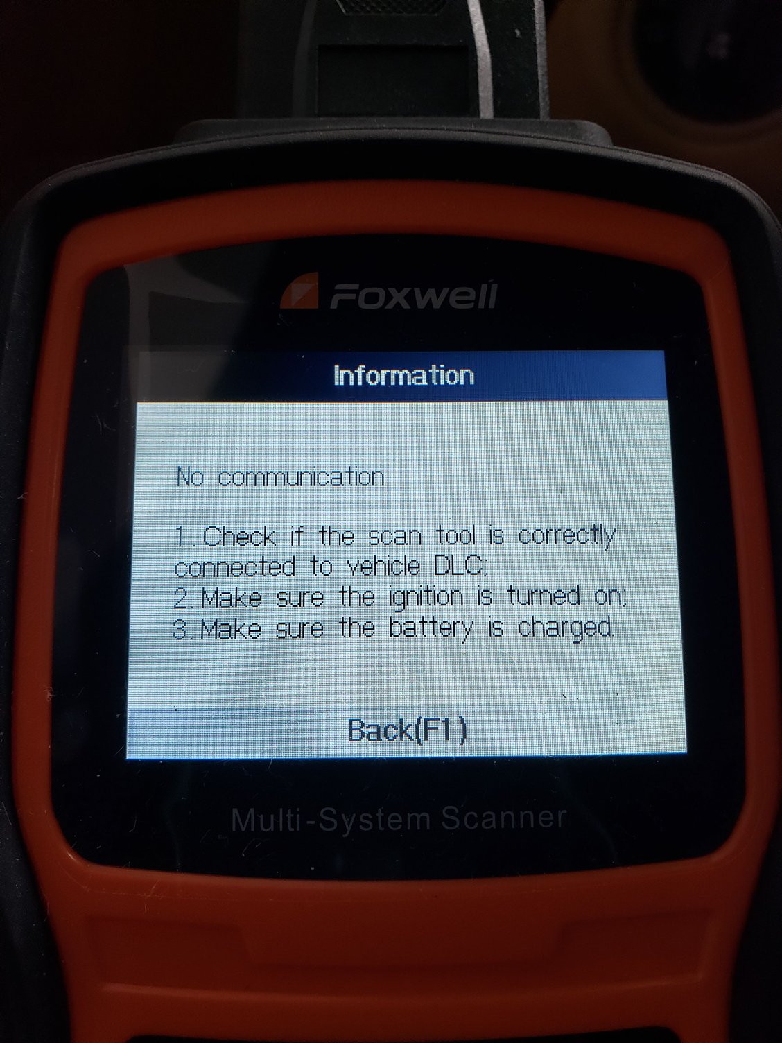

  #210
slngshot's Avatar
Joined: Mar 2021
Posts: 2
slngshot is infamous around these parts

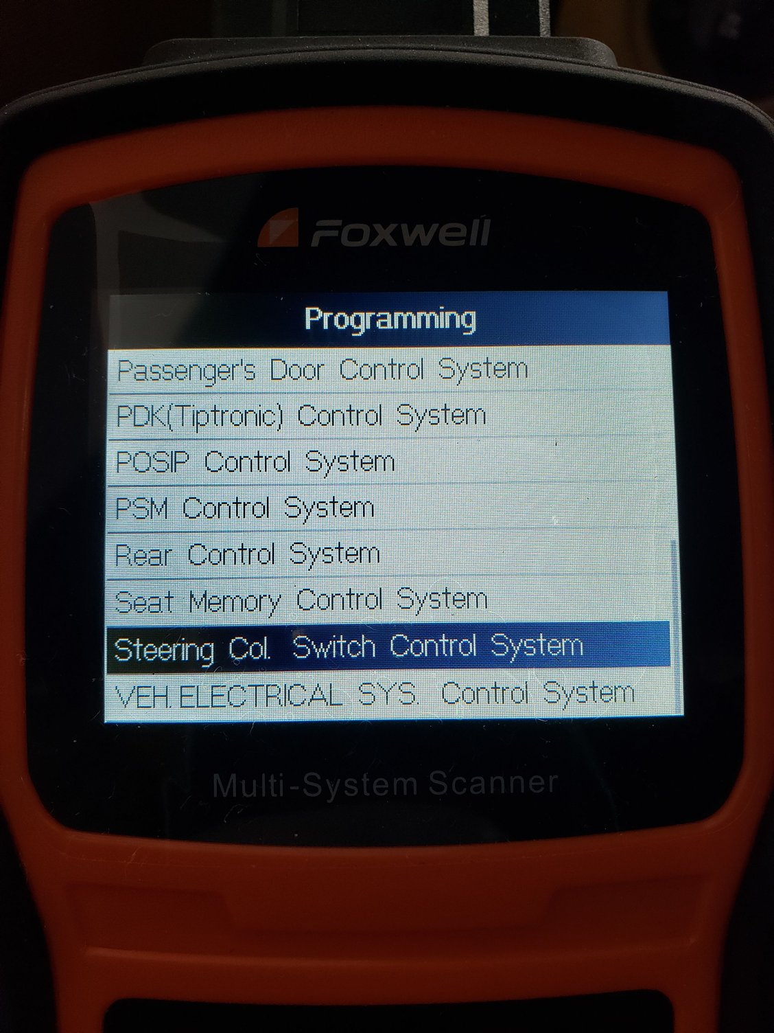

Greetings,
bump of an older thread but hopefully someone can give some guidance.
I have a 2007 987.1 Boxster S tiptronic sport chrono
I bought a 997 PDK wheel and new airbag and column control module from Suncoast.
Took all the screen captures prior to removing the stock wheel.
Installed the column module, no problem.
Put the new wheel on and hooked up the battery - all good.
Key to position 2 so I can code the new wheel - HOOOOOONK!
It's the security horn.
I ruled out regular horn by pulling the 15a fuse which did nothing.
Puled the security 15a fuse and now the horn is silent while I try and code the wheel - no luck.
Strangest thing ever.
Car does start, and was able to drive it in and out of the garage.
Pics of my foxwell for clarity.
Thanks for any suggestions.
also, I did go back in and double check all my connections and the clock spring alignment. Everything was marked and reconnected as per removal.
Cheers from Canada.
David.
