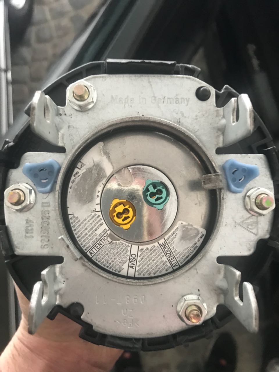

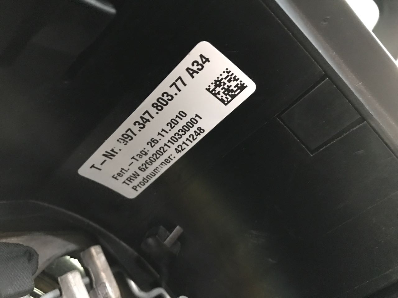

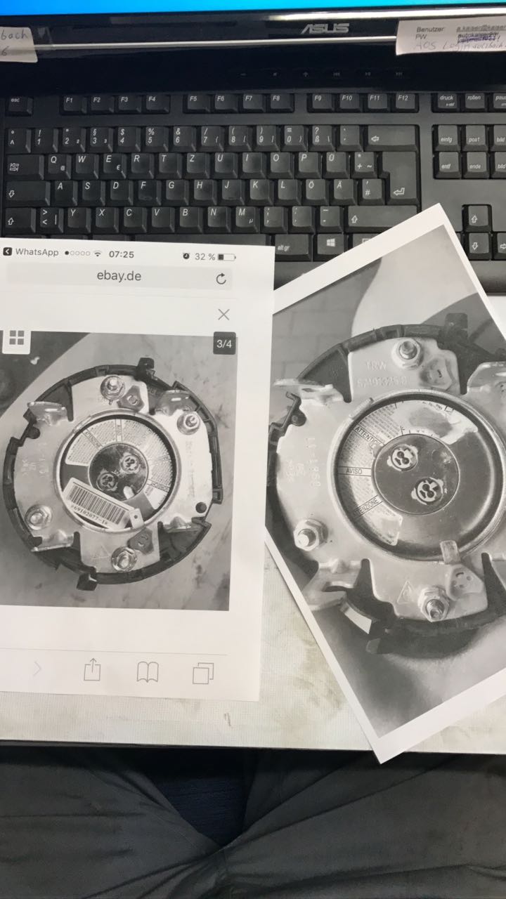

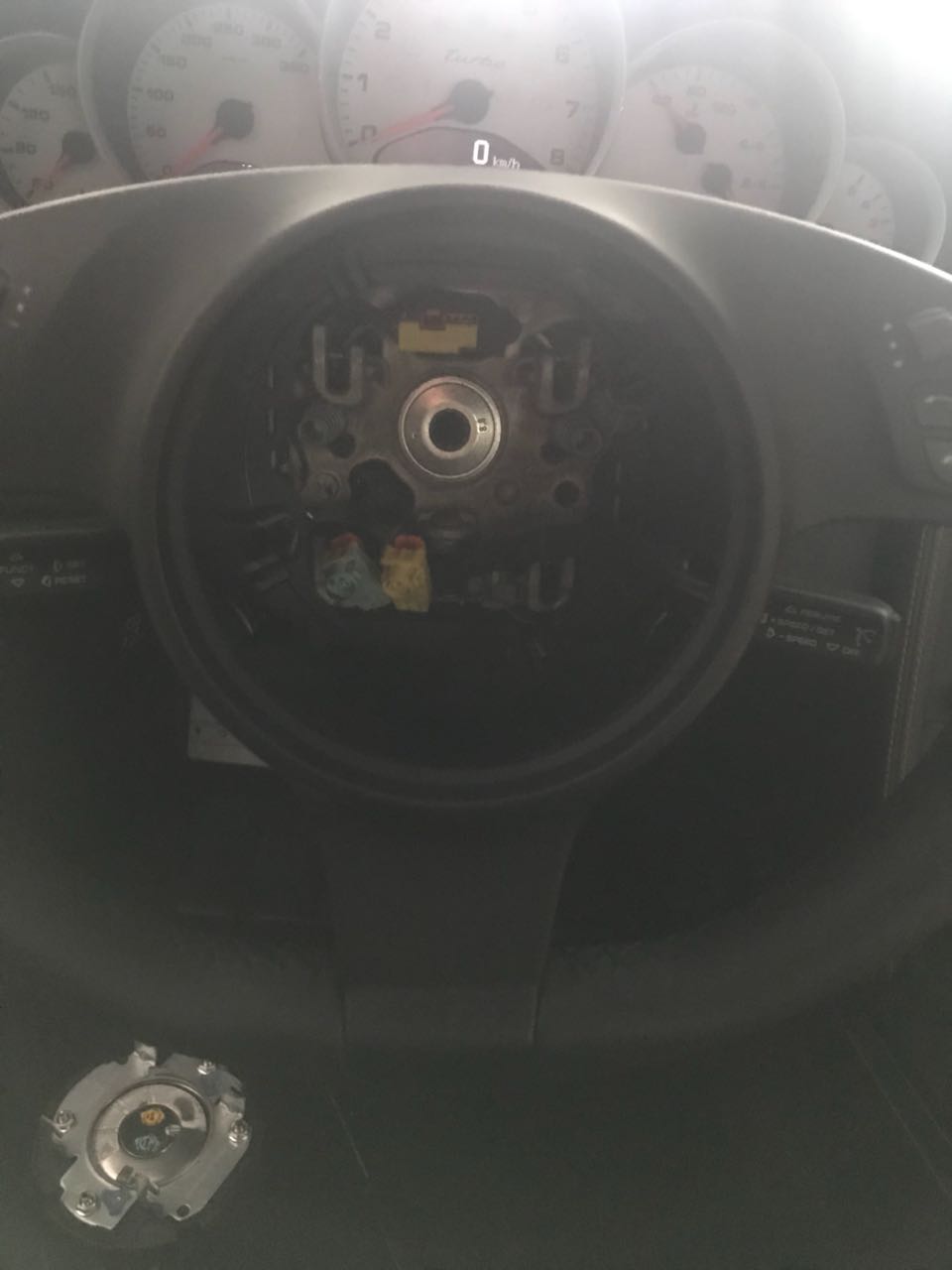

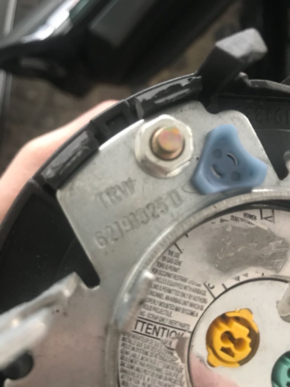

Hi guys, I am struggling doing my 997.1 to 997.2 steering wheel swap.
Is seems that there are different airbag types.
I know that the wire has to be within the channel that the horn is not stucking
in the down position, but as you can see on the 2nd picture the one I have is rotated to the one from eBay.
- the mounting plate and especially the connectors are rotated and not reachable without being to short at the end.
All information and tips are highly appreciated!
Maybe someone could give me a matching airbag part number to the steering wheel part number.
Thanks David
