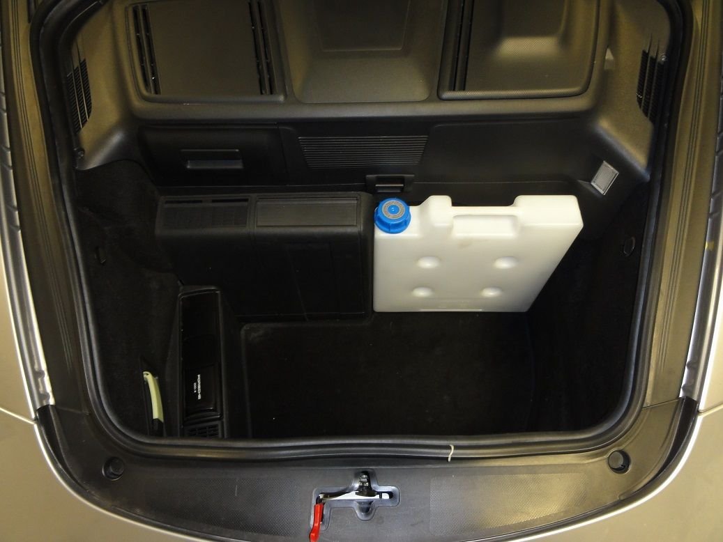

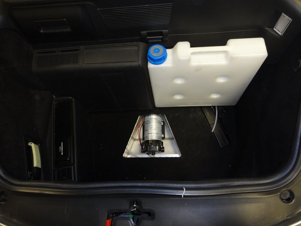

I did the GT2RS coolers and an Aquamist HSF3 meth system. I run 75% methanol and 25% water.
So far this year I've used 2-3 gallons of the methanol.
When doing a 3rd gear highway pull for my tuner,.. I see IAT's of about 69 F on an 84 degree day. So 15 F BELOW ambient.
That on stock VTG's at 22.6 psi peak.
No inter-cooler at any price will do that.
http://datazap.me/u/duckstu/log-1467...=0&data=1-3-10
And of course the octane bump is nice. The drop in IAT's along with the extra octane is worth an extra 70 hp easy.
I went with the 5 liter baffled tank, also from Aquamist. Fit like a glove.
And a pic with the carpet removed,.. showing where I put the pump.
