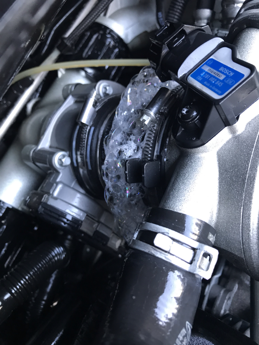

Here is the curious part.... this is a new hose and it seems like the material is permeable.
Anyone ever seen this before?

I had the same issue on a friends car (mine is in storage). He decided to order that piece to see if the new one will bubble like yours.
