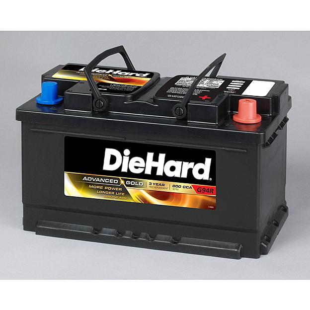

I got the DieHard Advanced Gold AGM for $170.99 at Sears which is a perfect fit.

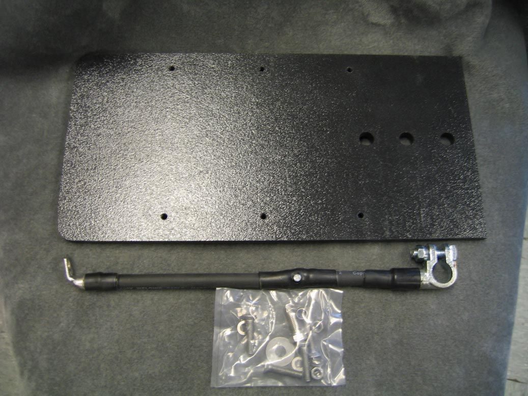

Anyone using a Red Optima 34R with this tray?
Yellowdog tray? I used it with the 34R on my previous 997. Had to use the longer neg cable but otherwise worked great. Buy the next size up on the washers for bolting the battery to the plastic. PM me - I have the Yellowdog stainless steel tray and and a spare cable if you're going to go this route.
Sort of...
Using the 34R but...
I made an adapter tray for < $5 picking up a 3pk of HPDE cutting boards from Target. Trimmed to fit (use old battery for rough guide), drilled a few holes for hold down screws (from misc workshop supplies) and refreshed kitchen stash too.
Longer cable not needed in my '06 C2S but YMMV.
Thanks for posting; the Walmarts around me are sort of out of the way, so i was looking at either Autozone or Sears. Got my AGM 94R battery yesterday - car cranked great after the swap. Stupid thing was that the Sears computer spec'd a group 49 (which is bigger).
While it still fit in the tray, the hole in the tray that the clamp would have to be screwed into didn't have any threads. So I had to take the 49 back and tell them to give me the 94R. 189.99.
Oh, and I had my battery out of the car for 10 hours - didn't have any issues with losing presets or time or anything like that after dropping in the replacment. PSM failure cleared in less than a minute of driving, as expected.
