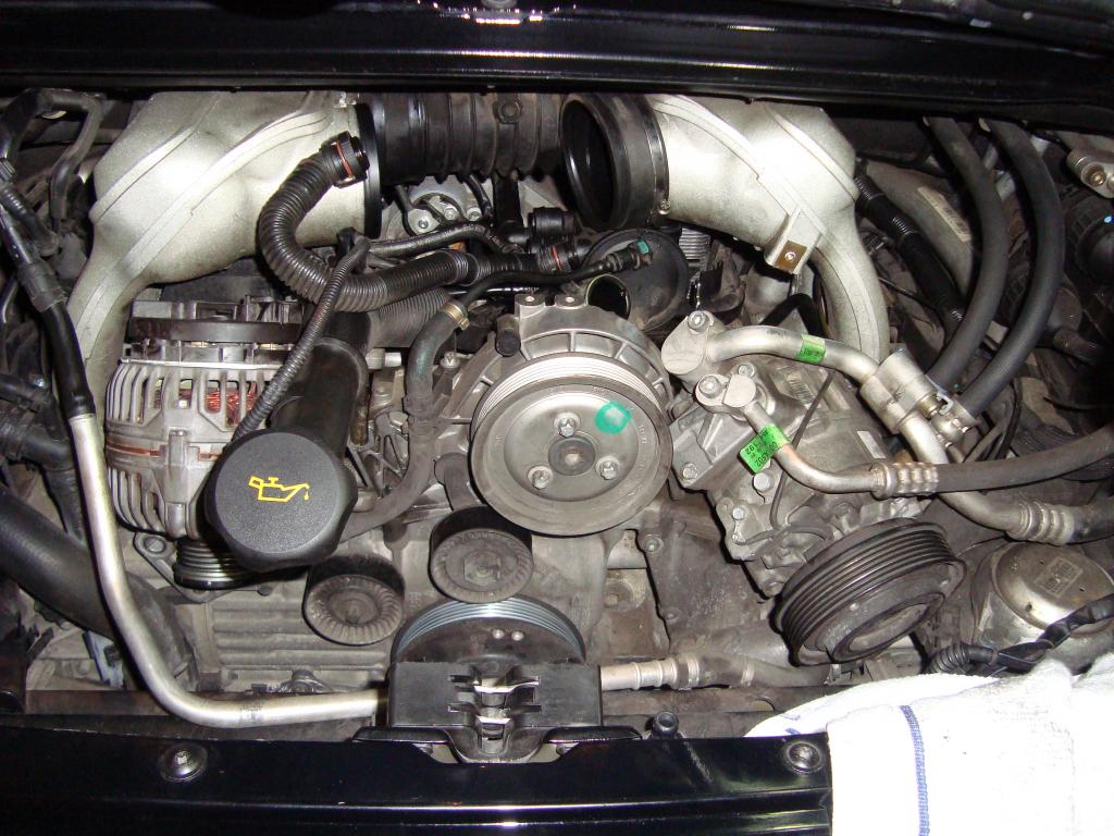

I replaced my starter/alternator cable last weekend. What a *****! Those clips that secure the cable to its feed tray are tricky. I found it better to just cut the old clips and work at removing them after the cable is yanked out. The new cable comes with its own clips. I would put this DIY at 9/10 for difficulty although now that I know what to expect maybe I could downgrade it to an 8/10.
