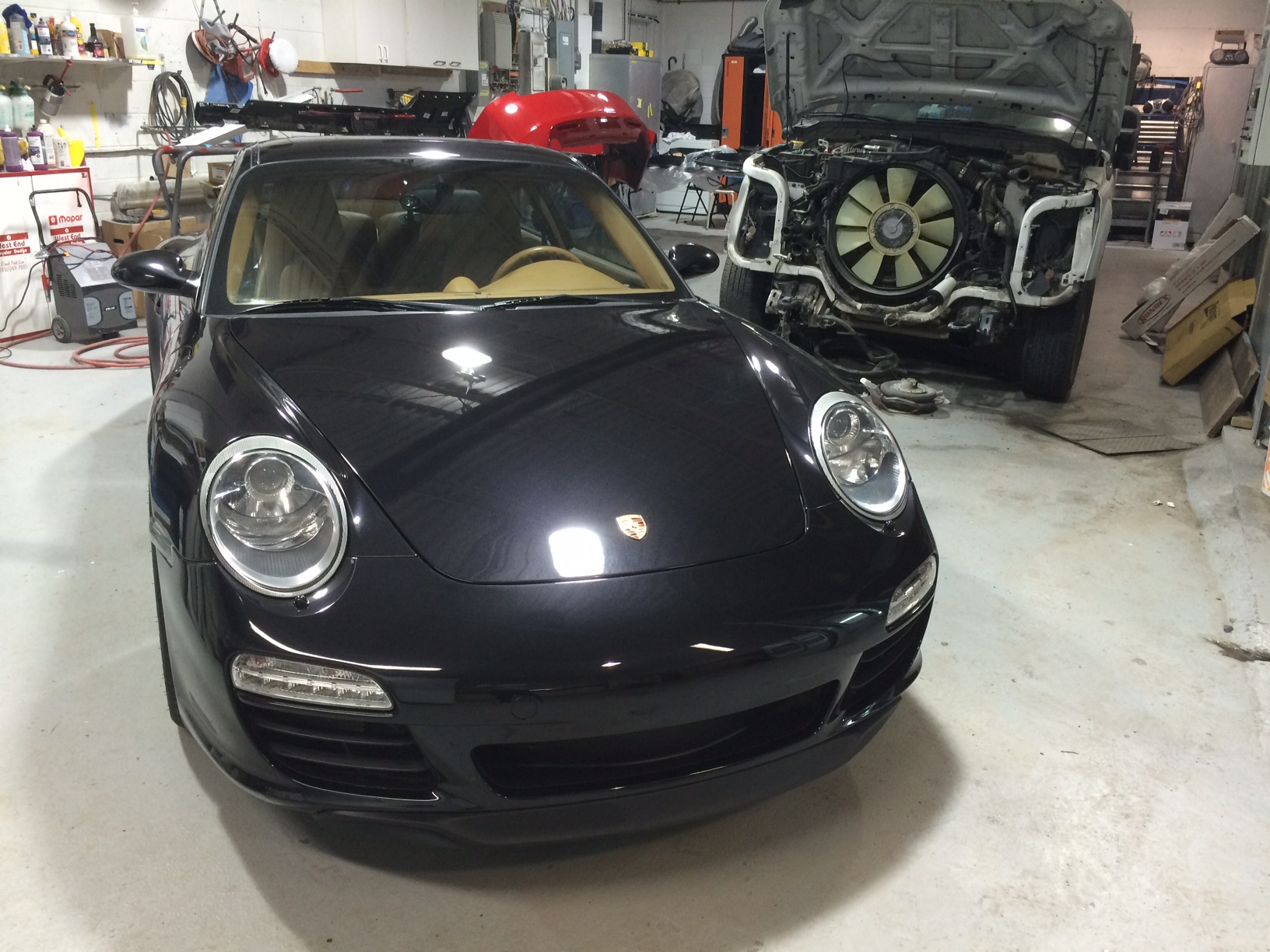

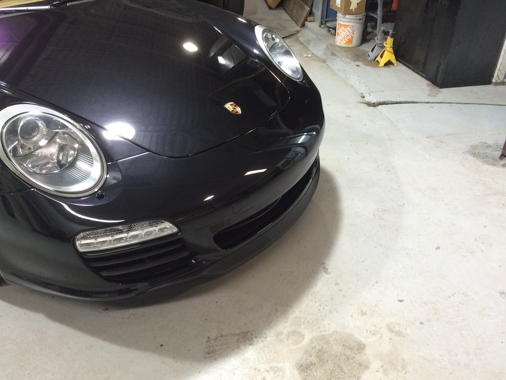

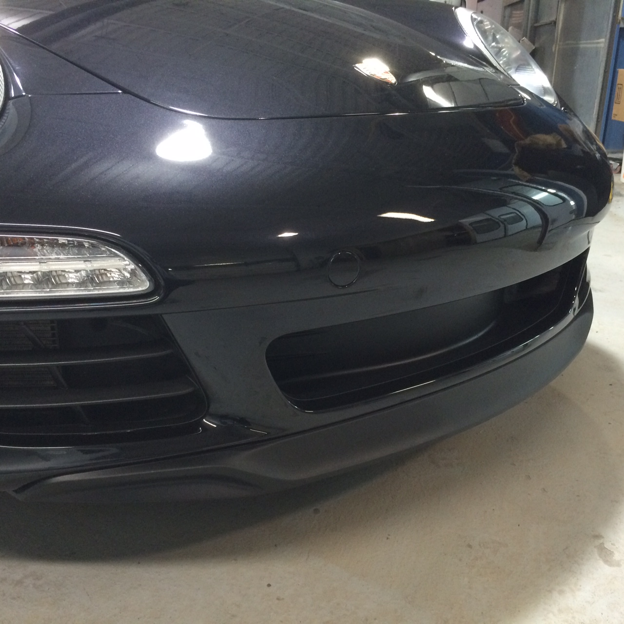

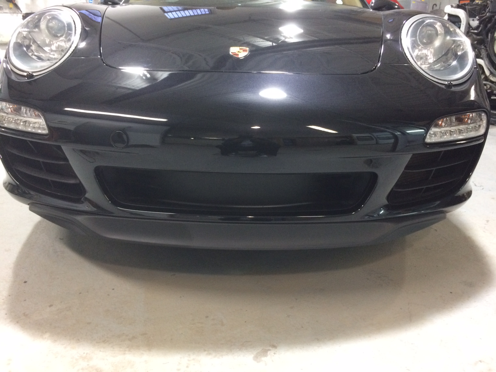

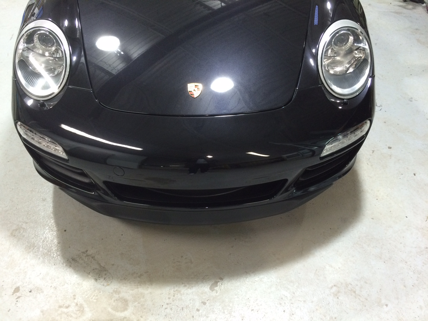

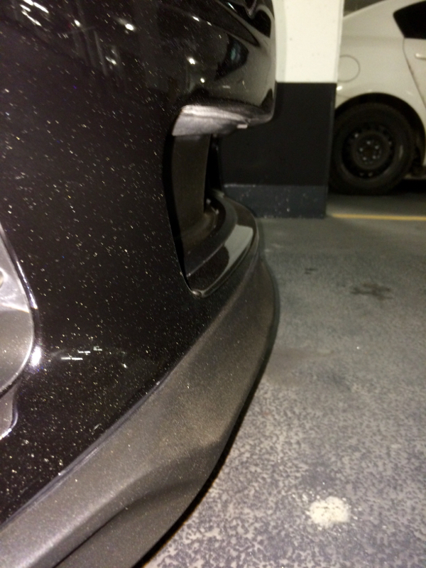

I had mine done by my bodyshop last week and i love it. Many thanks to EMC2 for the thread

Old Feb 2, 2016 | 01:44 PM
  #48
Daohaus's Avatar
Joined: Apr 2015
Posts: 51
Rep Power: 15
Daohaus is infamous around these partsDaohaus is infamous around these parts
Originally Posted by nvelicu
Nice job and thanks for sharing EMC2 and Daohous. I also think my 997.2 is missing something, and think this would add the least inches to my front bumper clearance from the choices I've seen. Will order soon :-).
Daohous - do you happen to have any pics of the underside, to see where/how many Würth screws were used. Also, what type of screws did he use...flat head, self piercing, etc.
Are you guys still happy with the resilience of the lip and install after some time passed? Does it make a big difference from stock 997.2 when going over speed humps or the higher speed bumps?
Thanks again for sharing your experiences!
They were philips button head self tappers i'll have to ask him what size he used but they were not long at all and with the 6-8 that holding the lip in place it's very secure. I've rubbed coming in and backing up driveways and it's holding up really well.

More pics

Looks great! How did they attach it to the bumper in your situation?
It would be nice to see some pics taken outdoors. It looks like they mounted yours a little more forward on the bumper than I did. In fact the position on yours is a little more like it is installed on the 991. Mine was set back a little more because of the way I attached it to the old lip mounting clips.
Both options look great imho.

The old lip was not reused in my case. He had a 991 with the sport lip in the shop, so he pretty much mounted it to match the 991. It took him about a couple hours with a heat gun and nuts/bolts. I have noticed a much improved handling at high speed with the lip as well. No scratching when taking steep curbs but I'm running stock pasm.

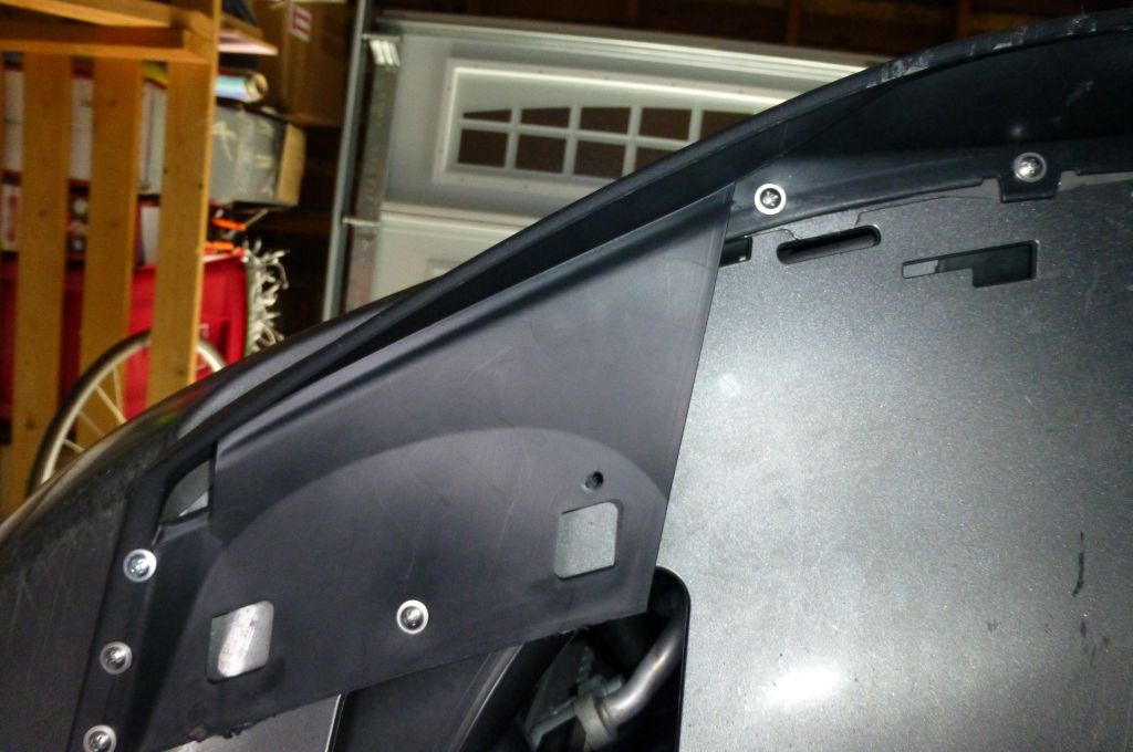

Hi, I screwed the spoiler directly to my front bumper with a mix of those: Video Link: http://www.amazon.com/gp/product/B00G5JXO94?psc=1&redirect=true&ref_=oh_aui_detailp age_o03_s00 and those: Video Link: http://www.amazon.com/gp/product/B00GYJRXBK?psc=1&redirect=true&ref_=oh_aui_detailp age_o01_s00 I used in total maybe 16 screws. I like these screws as they cut their own holes through the (soft) plastic (no drilling required) and because of the wide head they distribute the force that holds the lip in place more evenly

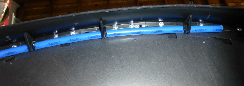

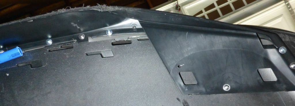

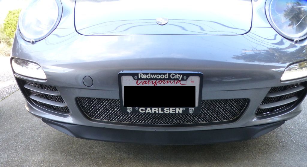

As promised here are a few pictures of my installation job.
A few remarks:
a) yes the car needs to be washed ;-)
b) wow - that's a lot of screws. Well if you look at all the scuff marks that were already on my bumper it's a little easier to bring yourself to put more holes in it. I fugured more screws will distribute any impact more evenly
c) is the new front lip already scratched? Yes, there is one nasty driveway that I have to take that just "keeps on giving"
d) what is the blue pipe? Well this is reinforcement so that the lip doesn't flex too much (at high speeds or at ground impact). It's a 1/2" plastic pipe that I had laying around
e) Your car looks low - yes it's a C4S which has an OEM ride hight of 20mm lower than stock
f) what fasteners did you use? (see earlier post)
