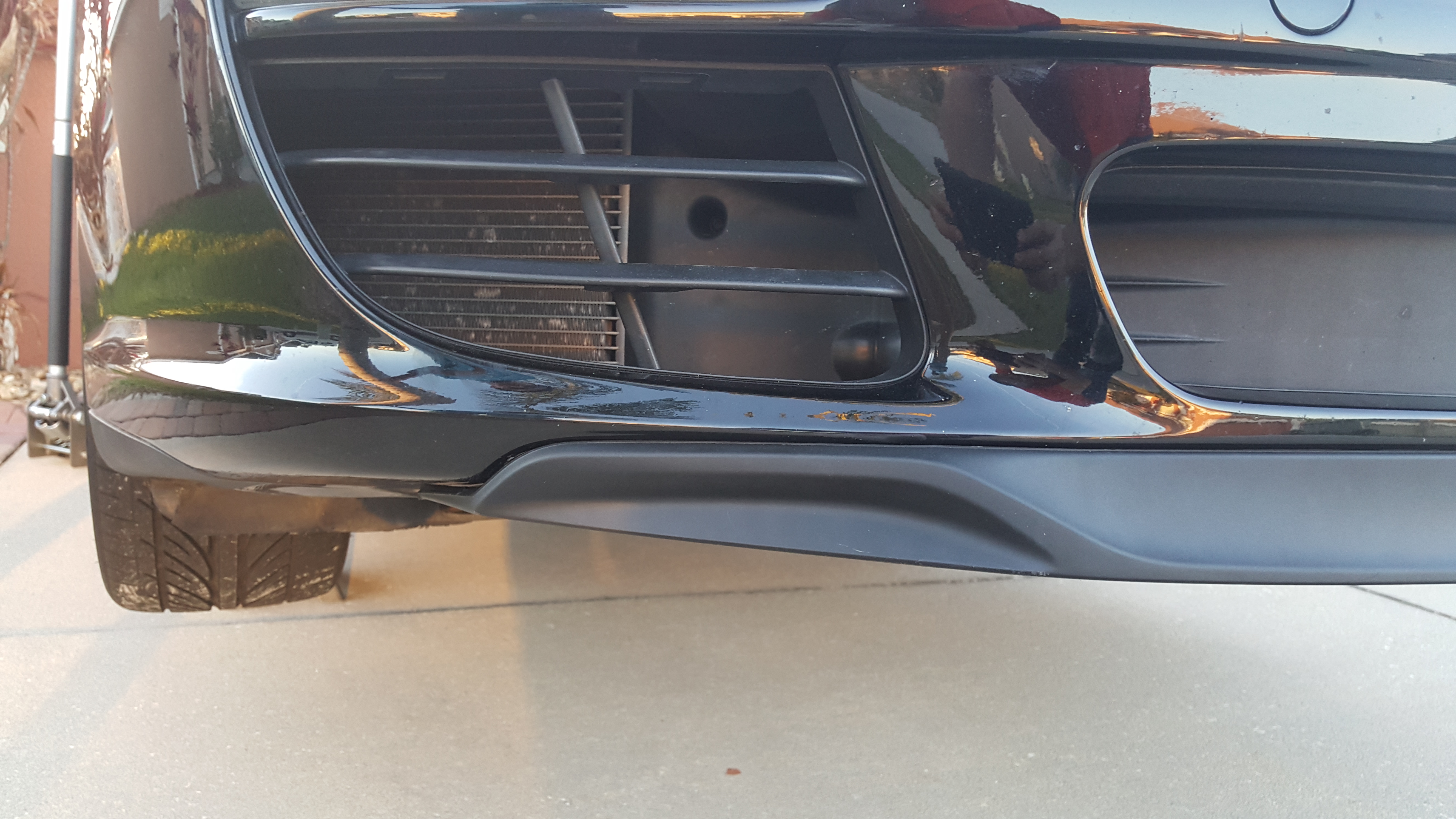

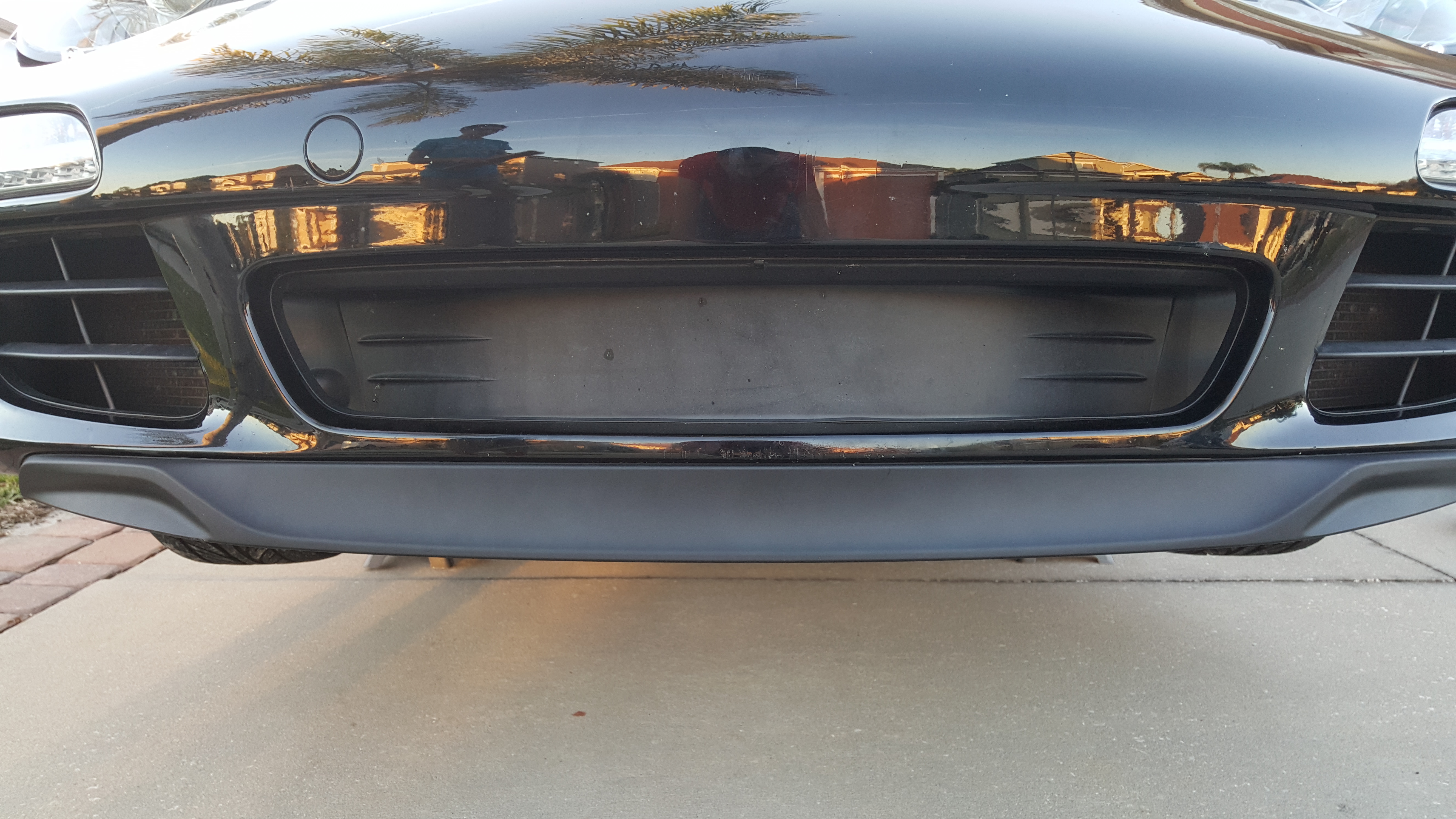

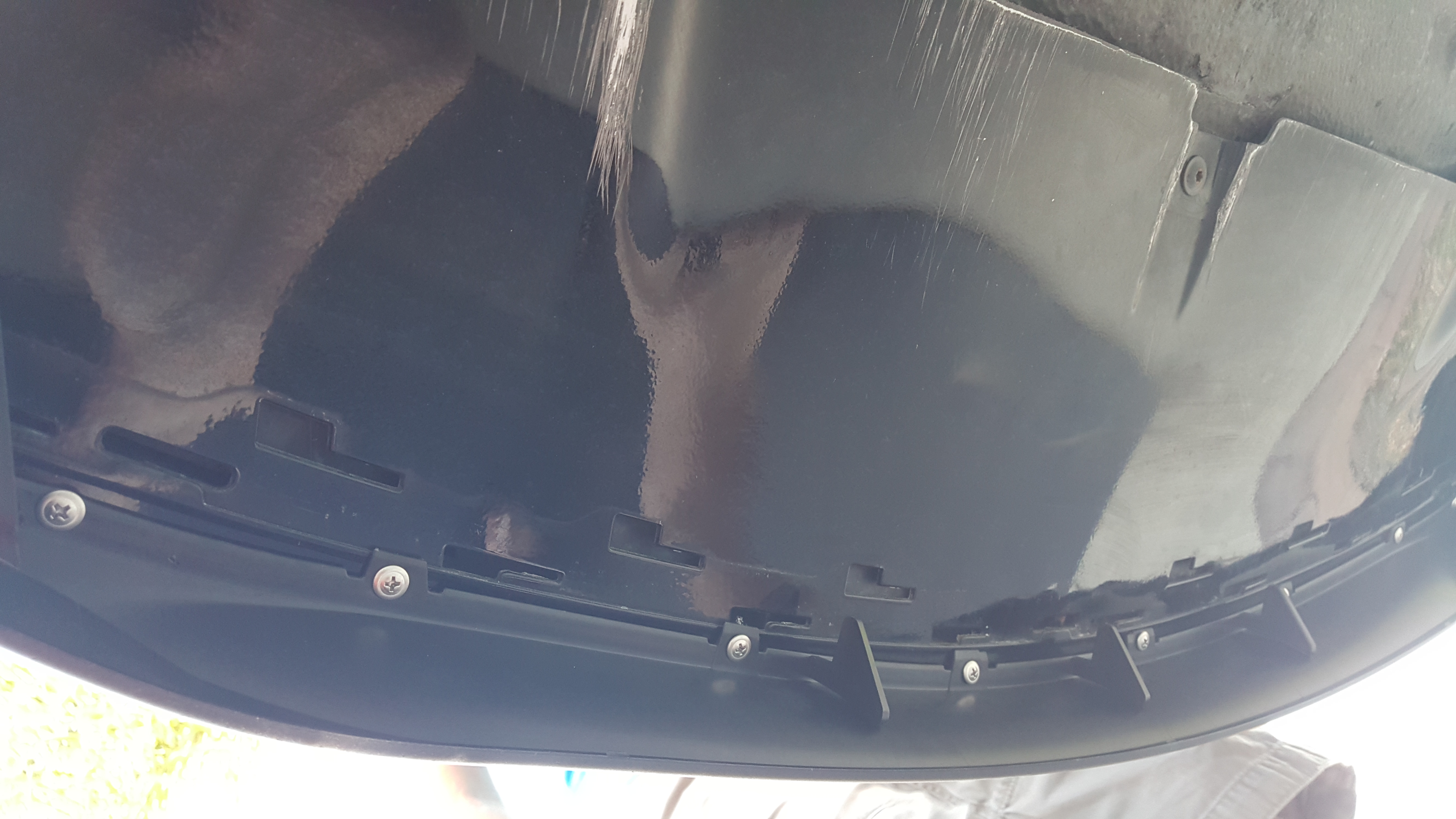

I just finished installing mine. I abandoned the idea of using the mounting tape and just used screws, I used the #8 1/2" screws. I was able to see through the slots where the headlight washer tube was located so I was able to put the screws in such that they did not hit the headlight washer tubing.
Thanks again to all that helped provide info on how to do this.

I just finished installing mine. I abandoned the idea of using the mounting tape and just used screws, I used the #8 1/2" screws. I was able to see through the slots where the headlight washer tube was located so I was able to put the screws in such that they did not hit the headlight washer tubing. Thanks again to all that helped provide info on how to do this.
Nice!
Looks great. Do you have any pics of the whole car to get a better perspective?

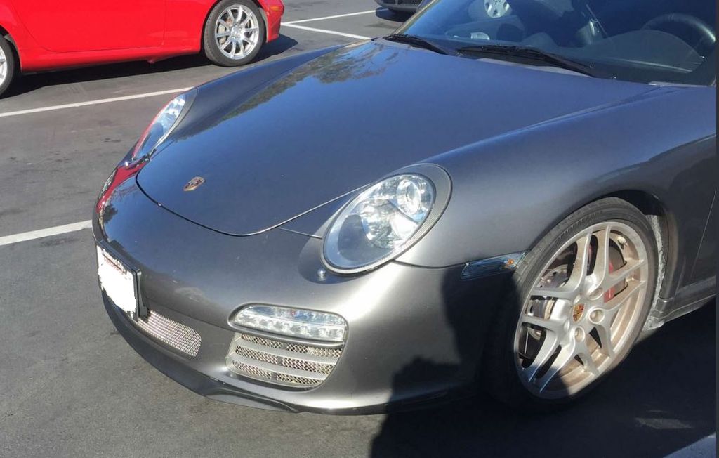

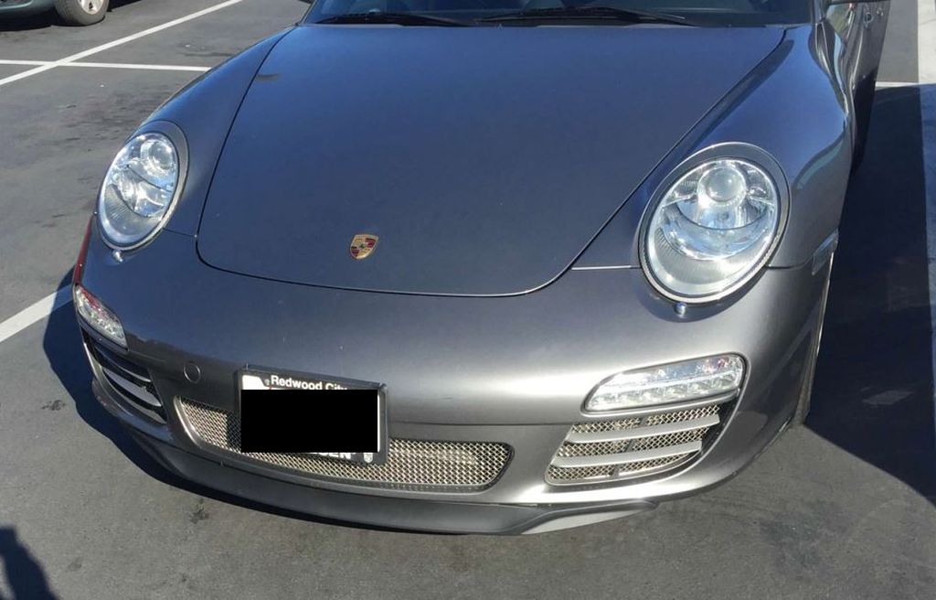

Originally Posted by mdaverey
Hatzenbach,
Would you mind taking a picture of your car from a distance? One from the front and one from a 3/4 angle so we can get an idea of what it looks like on a non black car. Would really appreciate it.
Also, i remember you having the gt3tek lip before. Which lip did you like better? Which one gives you more clearance?
There you go

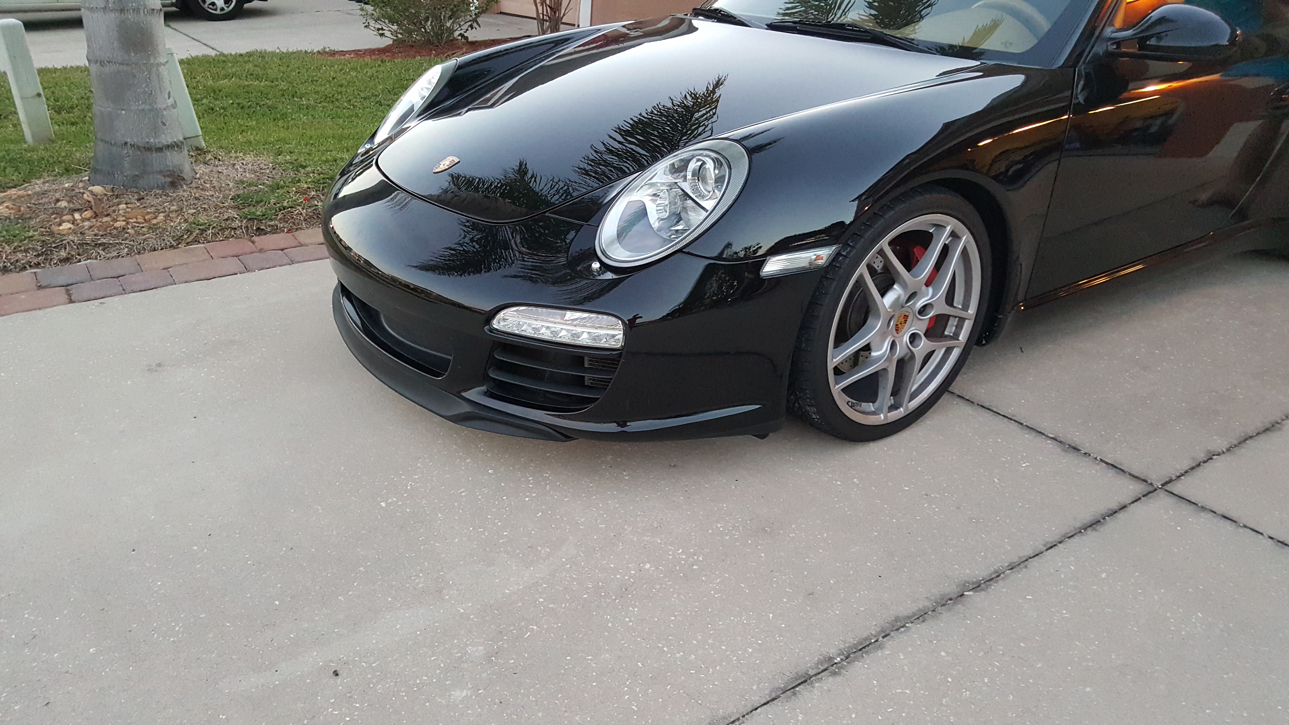

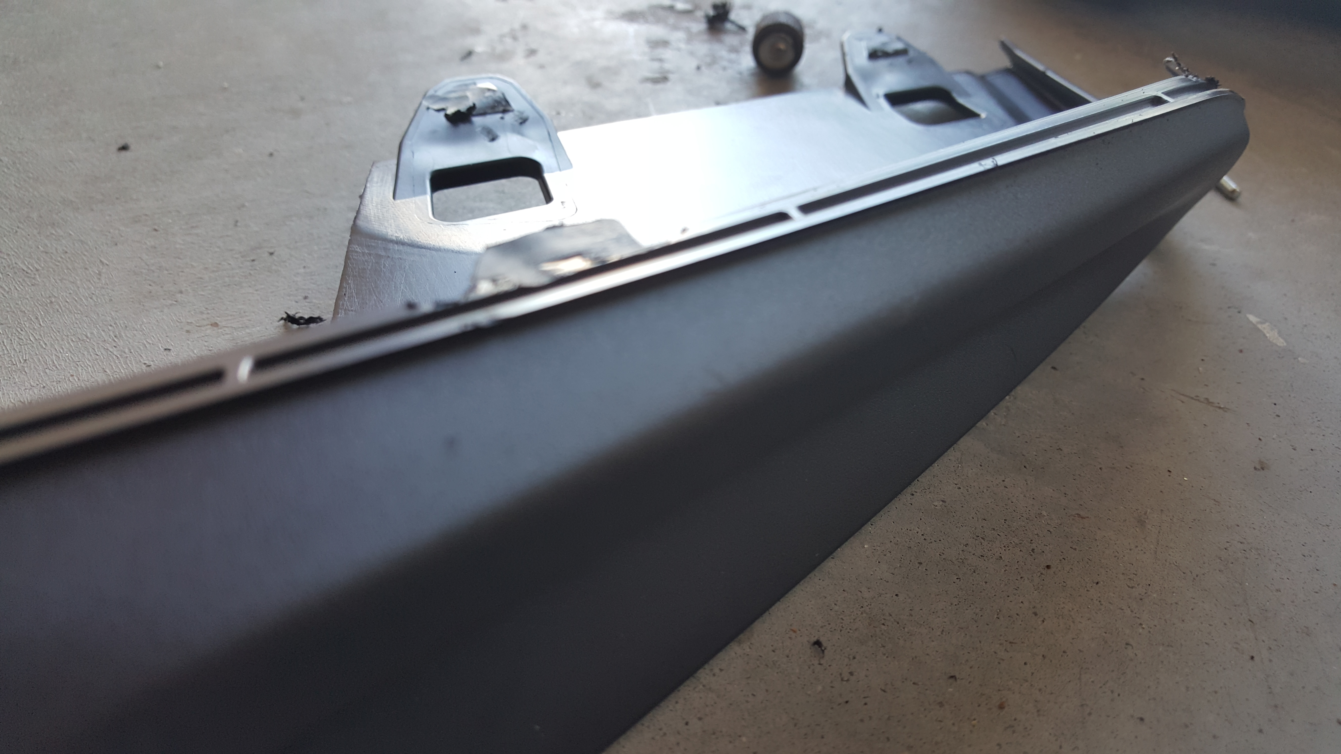

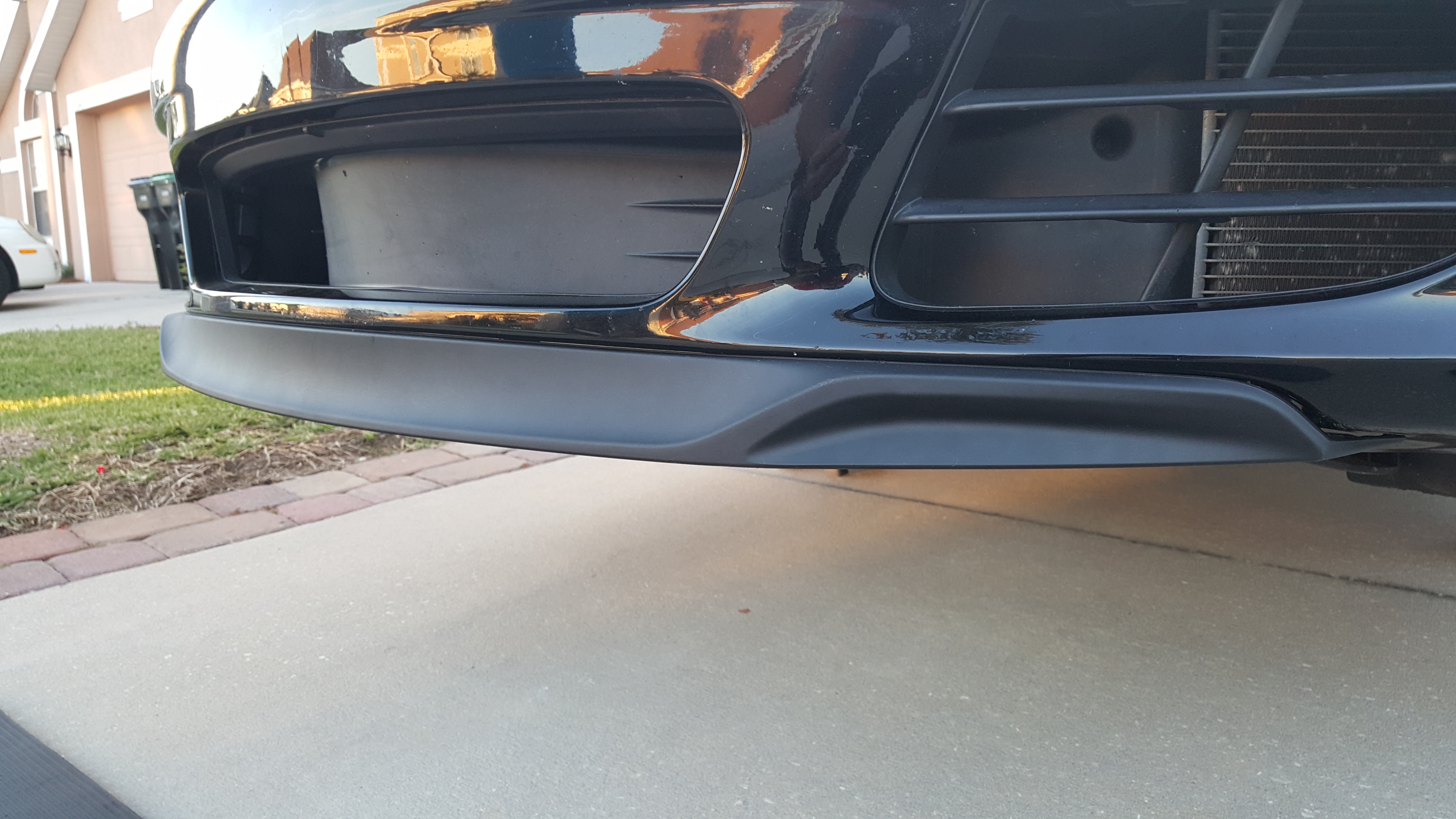

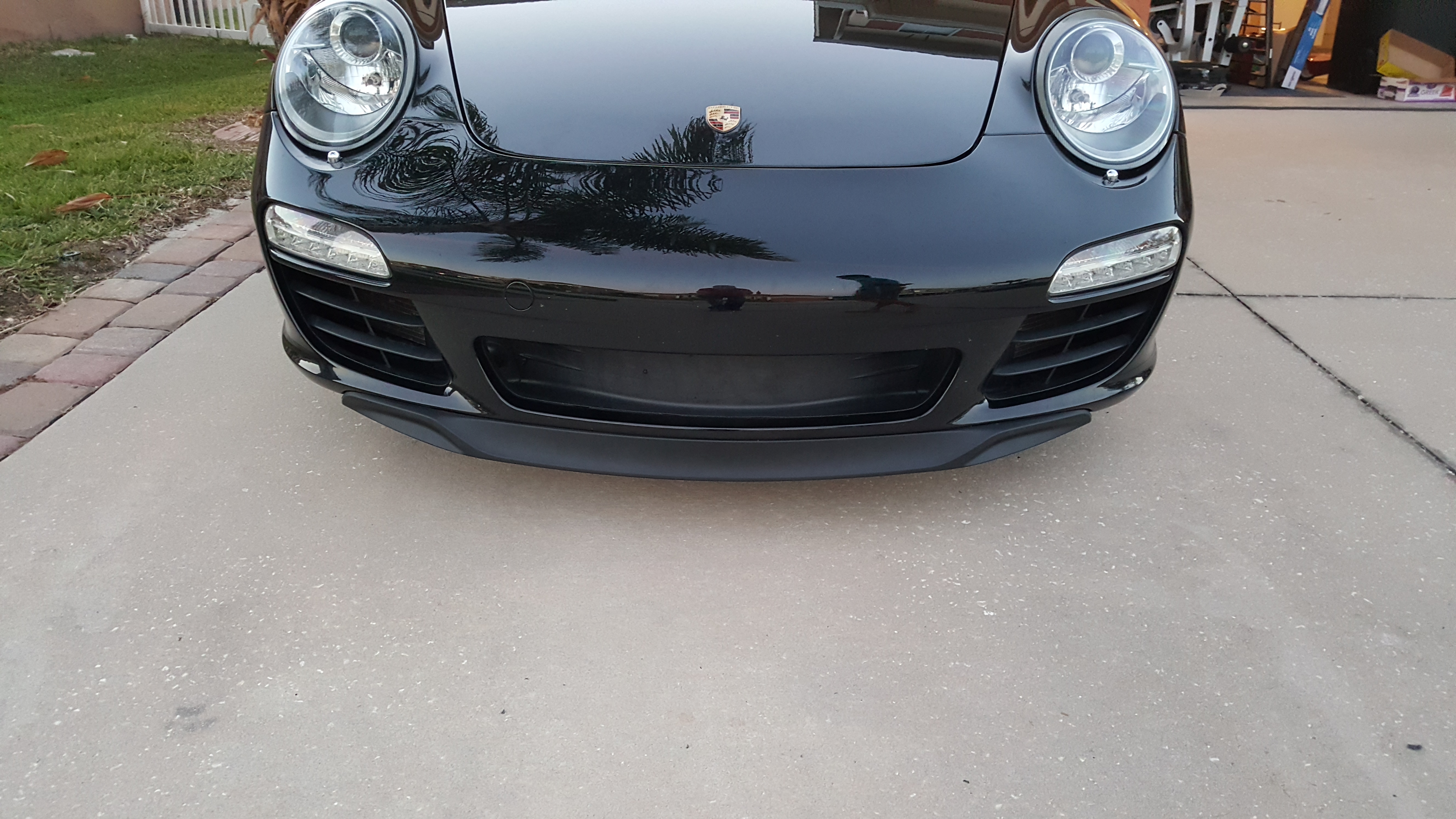

Thumbs up Success!!!

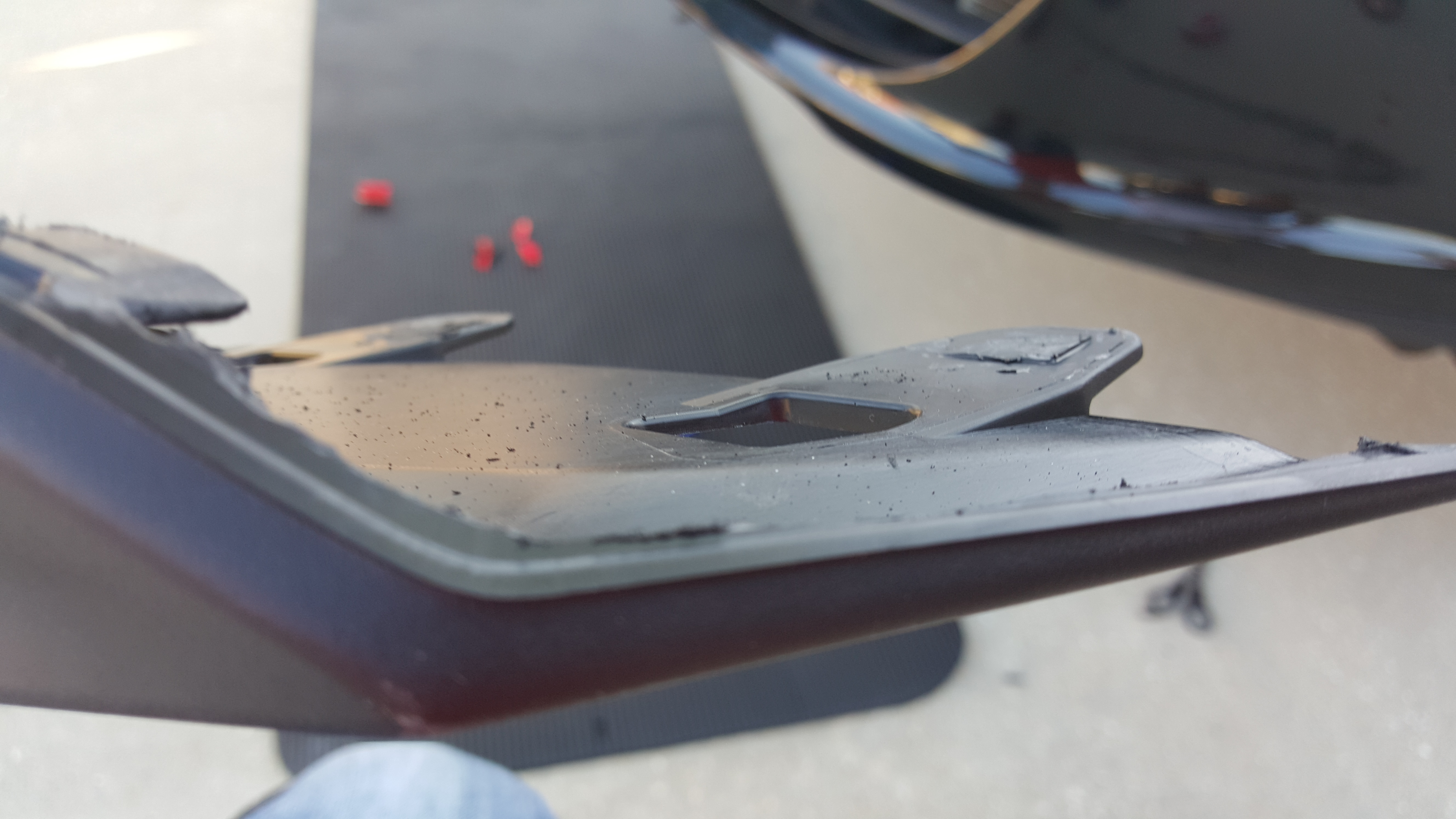

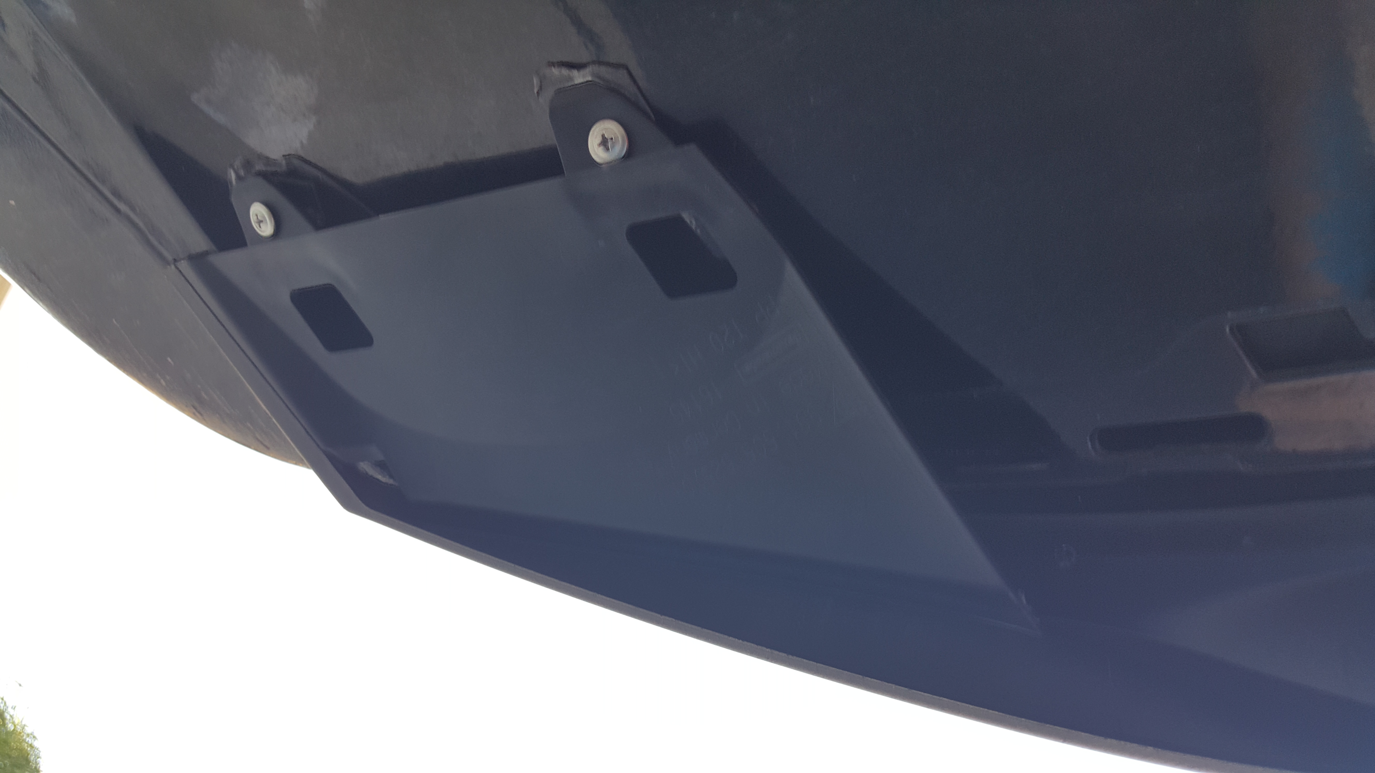

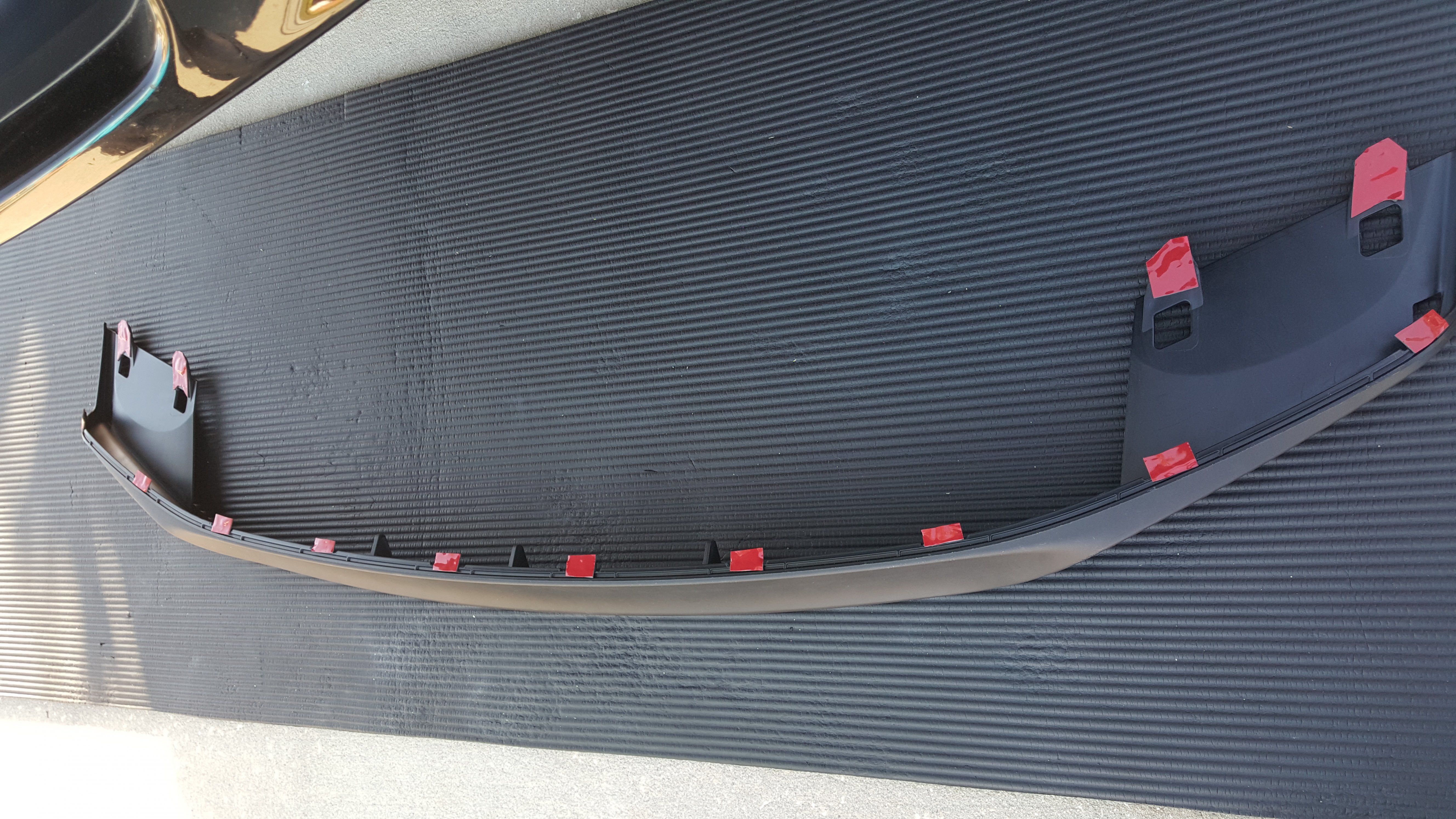

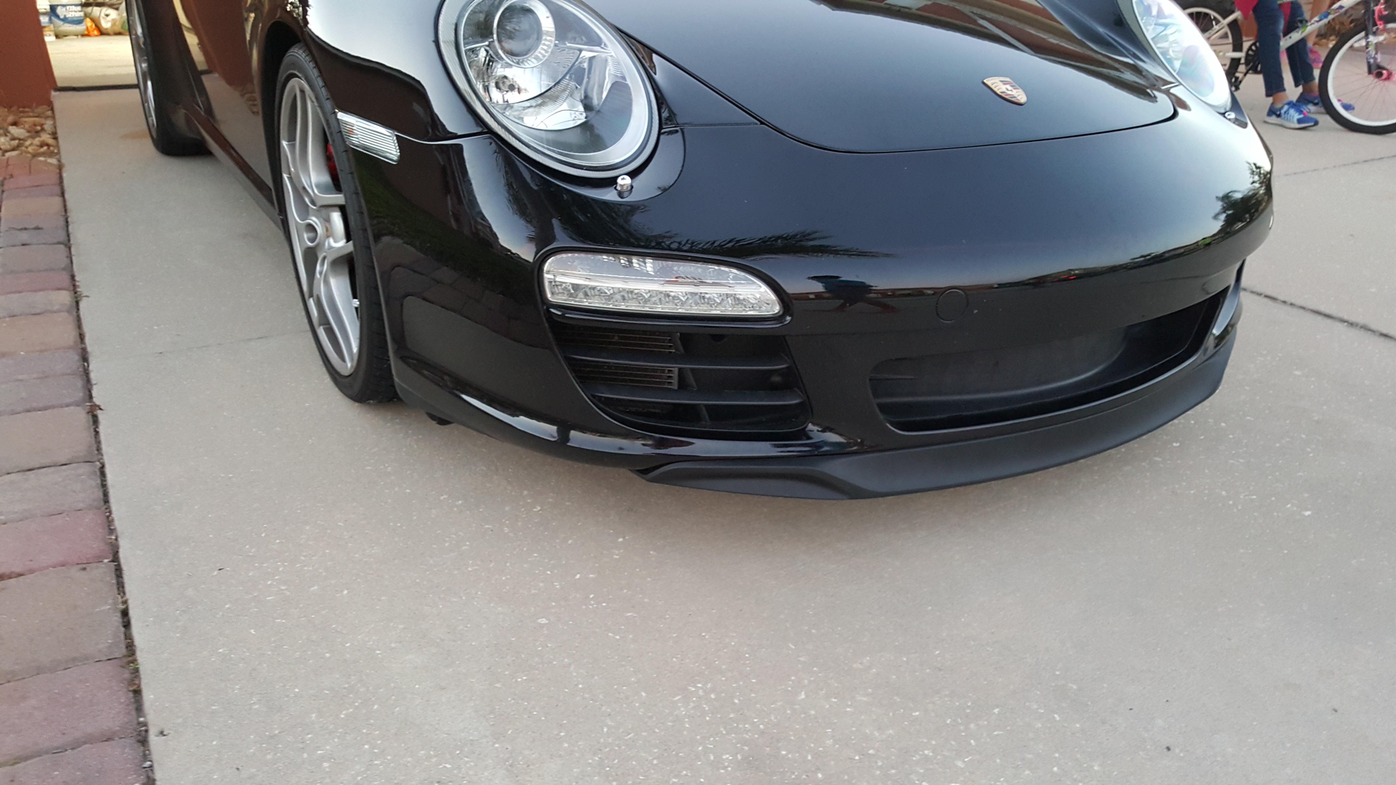

Success! I did it last Sunday, sorry haven't had time to post pics, but I'm very happy with the result! Thanks again, EMC2 and Hatzenbach for the tips! Also, I just saw the video posted by cbst09 - that is a great walkthrough for anyone looking to do this.
Here are a few points and pics from my process. I followed similar steps to cbst09:
1. I filled down the ridges on the tabs using a Dremel
2. I also used double-sided tape, and it helped position it, but like cbst09, I felt the tape added unnecessary space which would have left a gap, so I removed them from the tabs. I did leave tape on the very ends on each side, where they helped like a shim, and since it's not seen.
3. WARNING - I felt that the very sides had a lip on top which was preventing a flush mounting, so I shaved that off - see third pic. I may have gone a bit too enthusiastic, as now I think there is a little gap that may be visible. I may look for that rubber molding that EMC2 used to fill that in. You can see it in some of the later pics
4. I ordered the screws Hezenbach suggested off Amazon, they worked great
5. I did have my son help me out, found the second pair of hands and eyes very helpful in ensuring the lip stayed even with the bumper as I was screwing the lip on.
Overall, it wasn't as bad or time consuming as I thought it would be, and mind you this is the first time I'm really doing this kind of stuff, so if I did it you can too :-).
I'll attach more pics to show a comparison next.
Thanks all again for the help and encouragement! Next project is a TechArt wing I purchased a while back, but I'm taking that to a shop, as it's a different color and needs to be sanded, primed, painted to match, etc.
ID:	442032   Click image for larger version
ID:	442038   Click image for larger version
ID:	442040   Click image for larger version
ID:	442041   Click image for larger version
ID:	442043   Click image for larger version
ID:	442044   Click image for larger version
ID:	442045   Click image for larger version
ID:	442046   Click image for larger version
ID:	442048   Click image for larger version
Looks great - nicely done.
It would be nice to see a pic from an angle like the one below. Looks like you installed yours a little more forward than mine (which on mine was dictated by the original spoiler points that I reused).
Also; I would strongly suggest adding the support bar as shown below, else at high speed the spoiler will flex backward and change angle. Not the kind of active-aero you would want

Thanks EMC2! I'm happy with the look as well...am working on my wife who's undecided yet :-). I'll see if I have a pic from that angle, if not I'll take it in the next couple of days.
Yes on the extra support - I was actually going to look at Home Depot for a rigid 1/2 inch pipe like cbst09 used. You seem to have a bar of some type edged in there?
