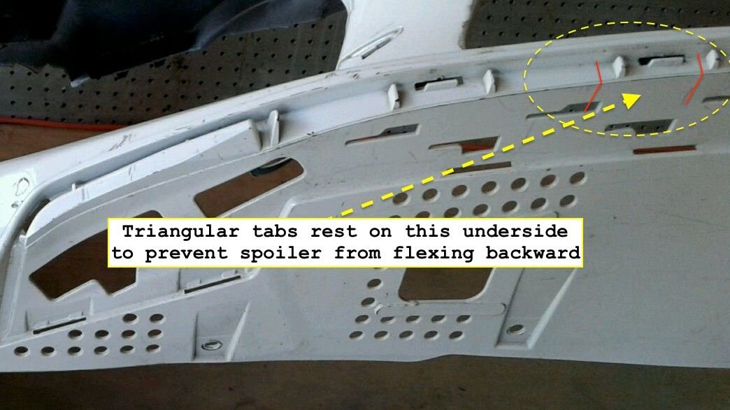

Done this. It looks really good. Although I think I put it behind further than most. I like the looked tucked in Abit vs the one at the edge..although the one at the end for sure has better aero function...
but really is there a need for that support hose at the back that prevents the lip from flexing? Doe the 991 install have some kind of support there or is it really like that?

Rick, when I first researched this option it looked like the triangular tabs inside the SPASM spoiler are designed to rest against the underside of the 991 bumper. You can see this below in the pic of a 991 bumper (which I borrowed from the web) and marked up:

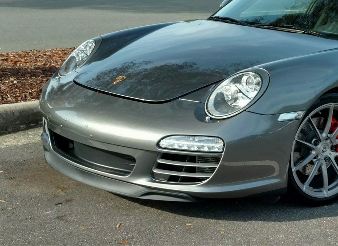

Below is a pic of how I compensated for this on the 997.2 install:

Great Info brother. This confirms the need for a support at the back. Again, hats off to you.. This mod will go down 997 history like the gundo hack...

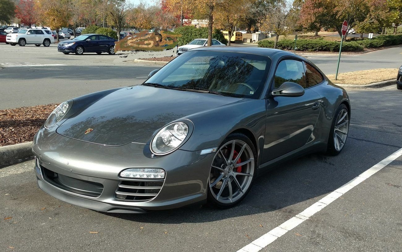

Finally mounted the Front Spoiler with EMC2's adapter kit . . . . . . nice update, I really like the addition
