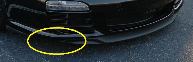

idk, look kinda weird but unique. front view look nice but side corner circled yellow is too tucked in. better if it extend all the way out like the front. IMO

Having said that, IMHO the flow of the front bumper and lip isn't the best. So many angles, flares and curves. But if you like it, that's what's important.

Looks pretty darn good! The angles of the lip don't quite line up with the grille openings on the bumper but I doubt anyone will fault you on that. Nice work!
