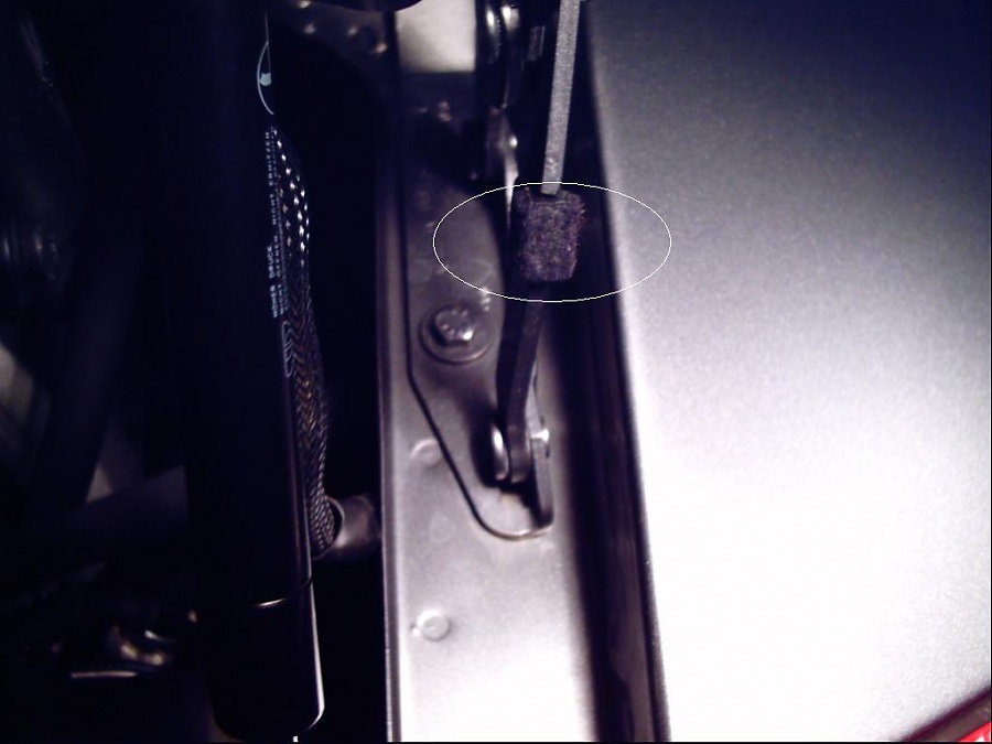

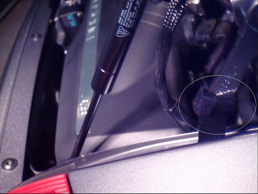

Apparently where the engine lid arms/hinges touch the underside of the engine lid when closed is what caused my squeak/rattle...the dealer applied felt tape to the areas making contact and the noise is gone.Open the engine lid and look carefully as you close it and you'll see the two areas where contact is being made. It's still hard for me to believe to this day that the noise was coming from there but it's gone and has been for months. Hope it works for you....let me know.

Originally Posted by philcr2800
Hi , I seem to have the same rattle. Did you fix it pls and how?
If you're having trouble locating the areas I described 3 posts above let me know and I'll take some pics of where they applied the felt tape etc...
please post some pics
Old Dec 10, 2007 | 07:47 PM
500's Avatar
500
Joined: Aug 2006
Posts: 868
From: earth
500 is infamous around these parts500 is infamous around these parts
Here you go. Let me know if you need other angles.
