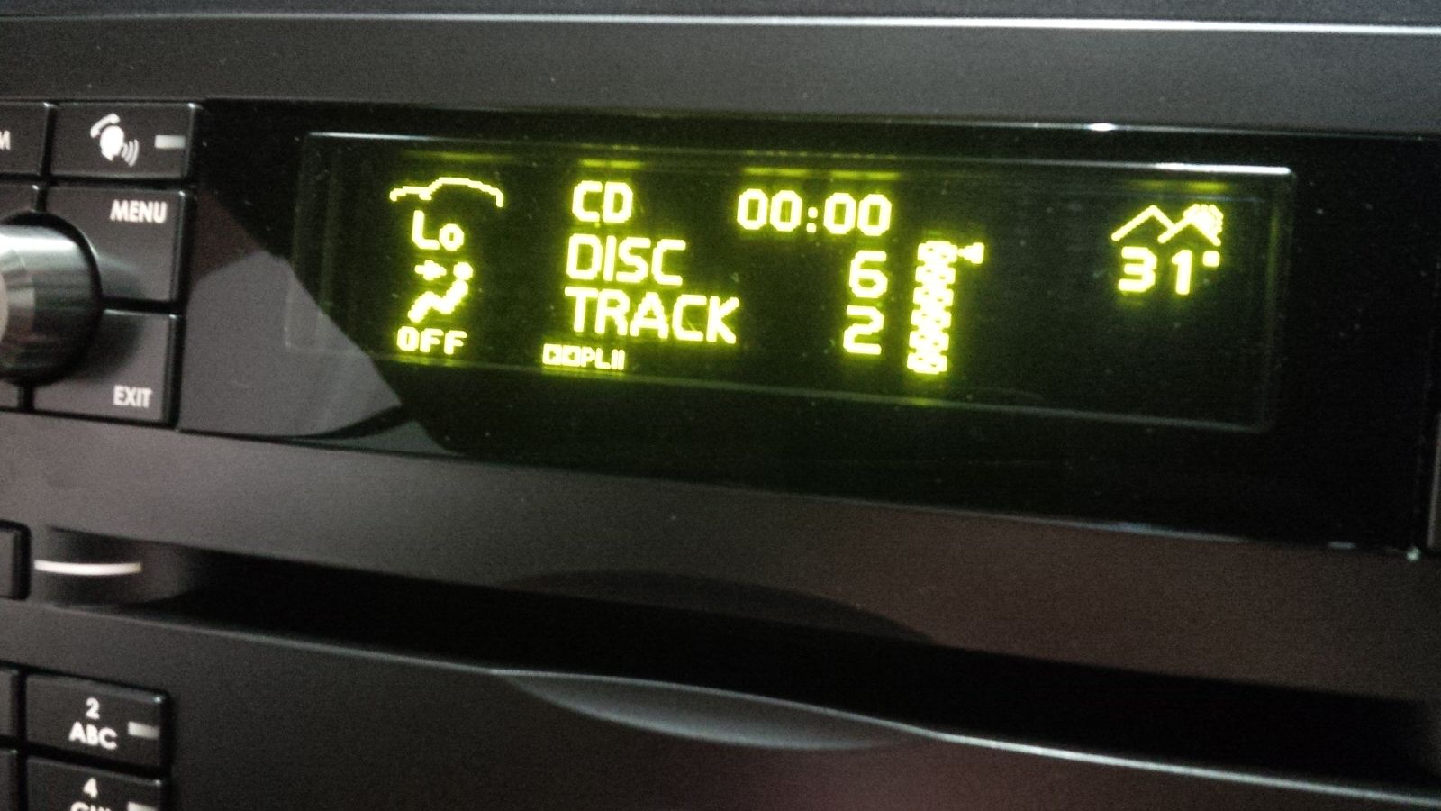

I've tried several set-ups; schematic 2A with XC-90 settings, 2B with settings, even tried schematic Type 1 with several dip-settings but all without results. With the Dension hooked-up 'after' the headunit and before CDC (2B) I seem to have the 'best' results:

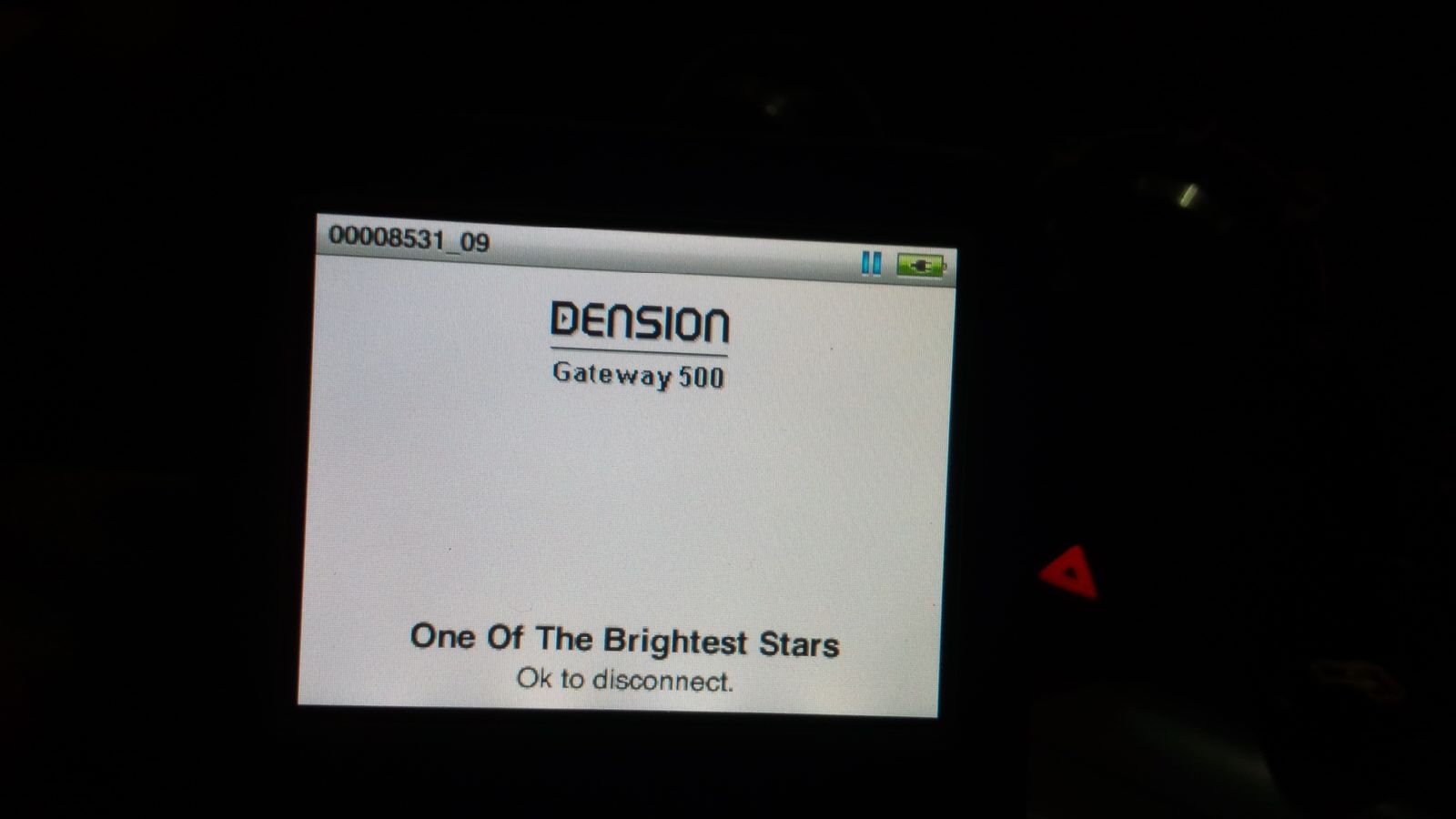

- Upon reset of system it automatically goes into DISC 5 mode, showing track 1 GW-mode.
- The Ipod straight away shoots into GW-mode (to be controlled from car-controls
- when changing to DISC 6, Track 2 (to go to IU-mode where I'm after) it seems the 'track' is not released/opened and basically nothing happens.. Also in GW-mode I can't control the IPOD from the car-controls.
Any ideas??

One of the things that surprised me about my Aston Martin Vantage was the lack of any aftermarket kits that would allow me to connect my iPod to the awesome quality Premium Audio system. Sure, the system has an in-dash 6-CD changer, but that is so 1995. Without the ability to play MP3 files, even six CDs isn't a very large amount of songs before you need to swap out a disc. Aston Martin sells an iPod integration kit that can be installed by the dealer, but reports on the forums claim it costs over $1,500US to get the system installed. I was looking for a solution that I could install myself for a bit less money.
The Vantage uses MOST (Media Oriented System Transport) which utilizes fiber optic cables to carry entertainment system information throughout the car. This means that you can't simply patch in an analog audio cable into the stereo and start playing music. I thought about using a direct-feed RF modulator, but reviews of many of those products mention that the audio quality is not too good.
After doing an exhaustive search on the Interwebs, I came across a company named Dension (from Hungary) that makes a kit to interface to cars equipped with MOST-based audio systems such as Porsche, Mercedes, Audi, Saab, and Volvo. There was no application information for the Vantage and very little in terms of documentation, installation, or instruction manuals. What little information I got was based off a few Youtube videos and a couple of emails I sent to the company's pre-sales support department. Even with this little information, I decided to take a chance and get one of their interfaces and see if I could get it to work.
I had already removed the facia panel over the center console to get it refinished in Piano Black, so I was able to peek inside the center stack and notice that the infotainment display and the fiber optic cables that feed it are very accessible. So I concocted a temporary cable to take power from the 12V outlet in the center console and hooked up the unit per the diagrams. The interface has a series of DIP switches on one side that need to be set up for each particular application. Seeing as there is a large Volvo sticker on the top of the CD changer (visible with the facia removed), I figured that was a good guess for which setting to choose.
The unit comes with a remote switch that has a pair of analog RCA inputs. The switch is used to bypass the unit so that the dealer's diagnostic equipment doesn't detect it and cause any errors. It also has inputs for a USB storage device (thumb drive) and an iPod with Dock Connector. I also purchased the optional Bluetooth Adapter which allows you to stream music wirelessly as well as make phone calls through the in-car audio in some vehicles.
After playing with the settings for a few minutes, I was able to see the interface's menu's on the infotainment display. Once I saw this, I was able to configure the unit to play audio from all the sources and have it come out the car's speakers. It sounded fantastic. To say that the interface is cumbersome to operate would be a MAJOR understatement. It is not easy and, in fact, it might be better to attempt while pulled off on the side of the road, or by a passenger to avoid you being distracted while driving. Once it is set up, however, you can see the artists or song names on the display, and you can use the dash controls to play the next or previous song in the album or playlist.

- When you plug in the iPhone 4 a message pops up on the phone's screen stating that it is not compatible with this device, but once you click OK, it works perfectly and charges it while you play!
