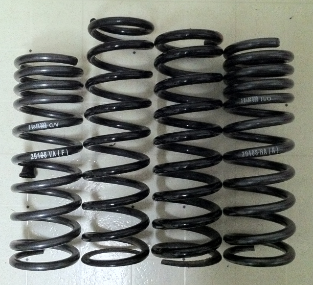

Originally Posted by dbp
I've done H&R springs only on one of my BMW M coupes and it made the ride quality go to ****. The other M Coupe had full H&R Coilovers which were a vast improvement over stock. I have a set of H&R springs for the Vantage sitting in the garage and they will be installed after Christmas. I'll report back on ride quality. I've heard several people here say the ride quality improves or stays the same. I haven't read anyone say it degrades the quality. I'm a bit skeptical myself, but we'll see! The Aston has "coilovers" already, so it's probably that the struts are just of higher quality and able to deal with the lowering springs better than the BMW's I've previously used them with.
David
I have H&Rs on my DB9 and the ride is definitely stiffer, not horrible stiffer but more firm then the sport pack springs my car came with. The trade off is a much improved stance and better handling. I would do them again....

No rubbing as it is now...but boy - maybe if lowered. Then that's a real PITA when that happens as its either get the fender roller out, go back to stock springs, or change the wheels. And while I've rolled a lot of fenders in years gone by, I don't think I could do that to this car! I might try it if I can pick up some used springs, I'll keep an eye out for some that are for sale like the H&R's, they're only 3/4" drop and I can put them on myself - think I can still find my spring compressor.

^^^ No need for a spring compressor, these cars have coilovers from the factory just replace the springs and re-install and re-align. The only issue is camber gain, but that's a known thing. I think you can adjust the wheel spacing with spacers if needed to resolve any rubbing issues, just a guess as I have the sport pack on my DB and have not lowered it, I think it sits perfect with the sport pack which is lower and more aggresive then standard and handles just right so didn't really see a need to lower it at this time if at all.
That's not true. I'm in the middle of this exact process now on my Vantage (writeup to follow). The stock springs have pre-load dialed in front and rear and the fronts required more cranks with the spring compressor than any BMW spring I've dealt with in my past. I really needed to grab the WHOLE spring with the compressors effectively get them unloaded from the upper perch. The rears didn't need nearly as much compression, but they did require quite a few more cranks than this image implies. The H&R springs do NOT require spring compressors to get on, which is great. The front actually needed about 10mm of compression to get on, but your impact wrench will do that just putting the top bolt on. The rear had about 10mm of flop. So to give you an idea of how much you need to effectively compress the springs, on the outsides of this photo are the H&R springs. The inner springs are stock. The Left two are front, and right two are rear.
Perhaps the Vantage but, I didn't need a spring compressor to remove or reinstall H&Rs on my DB9

^^^ What LR said. I dunno about the Vantage but doesn't appear so on DB9/DBS which are threaded coilvers from the factory, at least the sport pack is... the suspension looks like something right off the racing circuit

Don't mean to state the obvious here, but Duane does have a Vantage, so that's what we're talking about here. I just didn't want someone to get impaled by a spring when he removed the top bolt without compressing the spring. :-) The workshop manual is clear about the use of spring compressors though.
