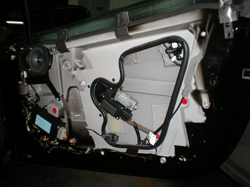

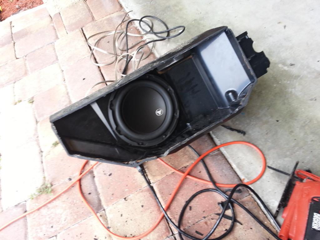

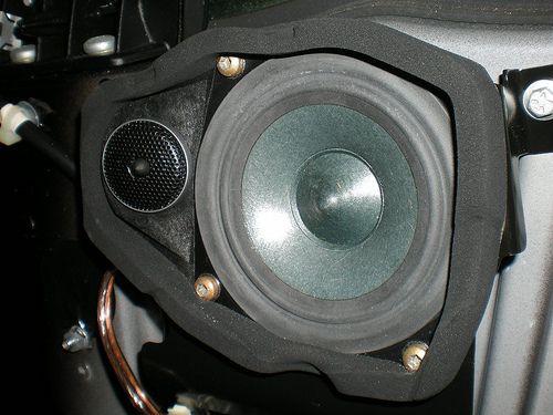

Hello, I'm new to this forum, and have read thru many great post's. However, I am looking for some more information. I am going to be working on a buddies 08 Vantage Roadster and wanted to clarify a few things before I proceed. I was interested in knowing to start, the max depth I have to swap out the door speakers, we were going to do some MB Quarts, I am concerned about hitting the window in that location. Also he wanted to swap out his factory sub which is behind the seat, so next question is, can that factory sub box be disassembled, and what kind of depth am I working with there as well. If anyone would know where to find a pinout for the factory amp, that would be greatly appreciated.

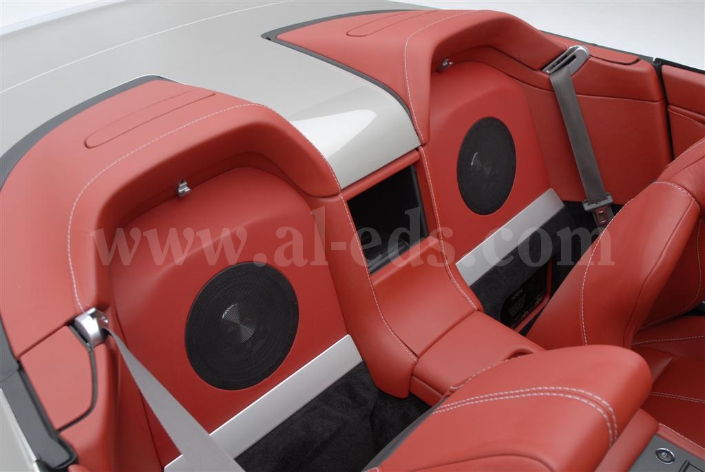

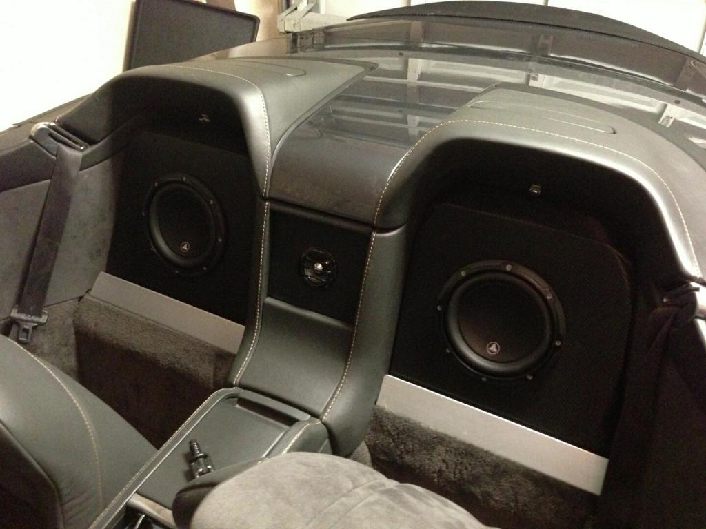

I haven't taken anything apart yet as I like to do my research first. I included some photos from other posts, google so forth. I also put a pic of what we want to do with the subs behind the seats. Thanks ahead of time for your help, its appreciated.

I would really like to find an excellent replacement for my "in the door speaker" like the one you show in your first picture--Any suggestions? (How hard was it to remove the door panel to get to the speaker?

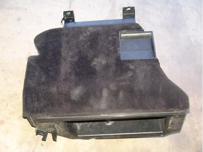

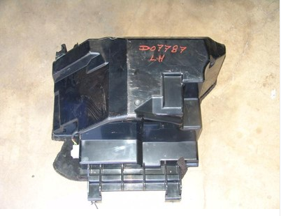

Thanks for your replies! Only problem with that previous forum is it's an 05 and the one I will be working on is an 08. Not sure if it's the year or the fact that its a roadster. But the sub for his I believe is in between the seats above the console. Which makes for a very easy swap and a good amount of mounting depth. The sub in the roadster is behind the driver on the floor. In the pic shown it doesn't look like that box can be disassembled.
Also they don't specify max depths, from the research I have done there is less than 2 in of clearance. My buddy wants components, but the smallest components in the brand he wants is 2.36 in deep. I guess I will have to take it all apart and try out the equipment we have, and hope for the best.

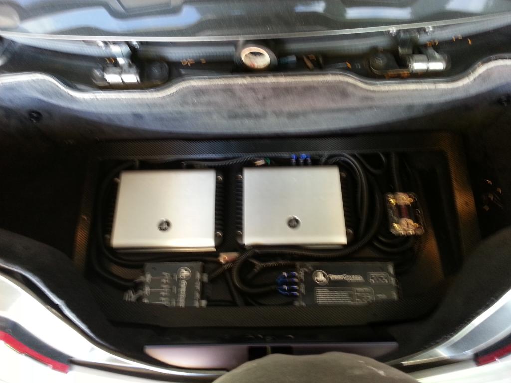

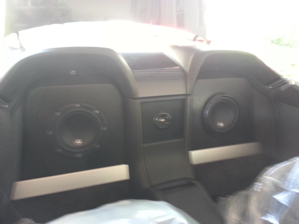

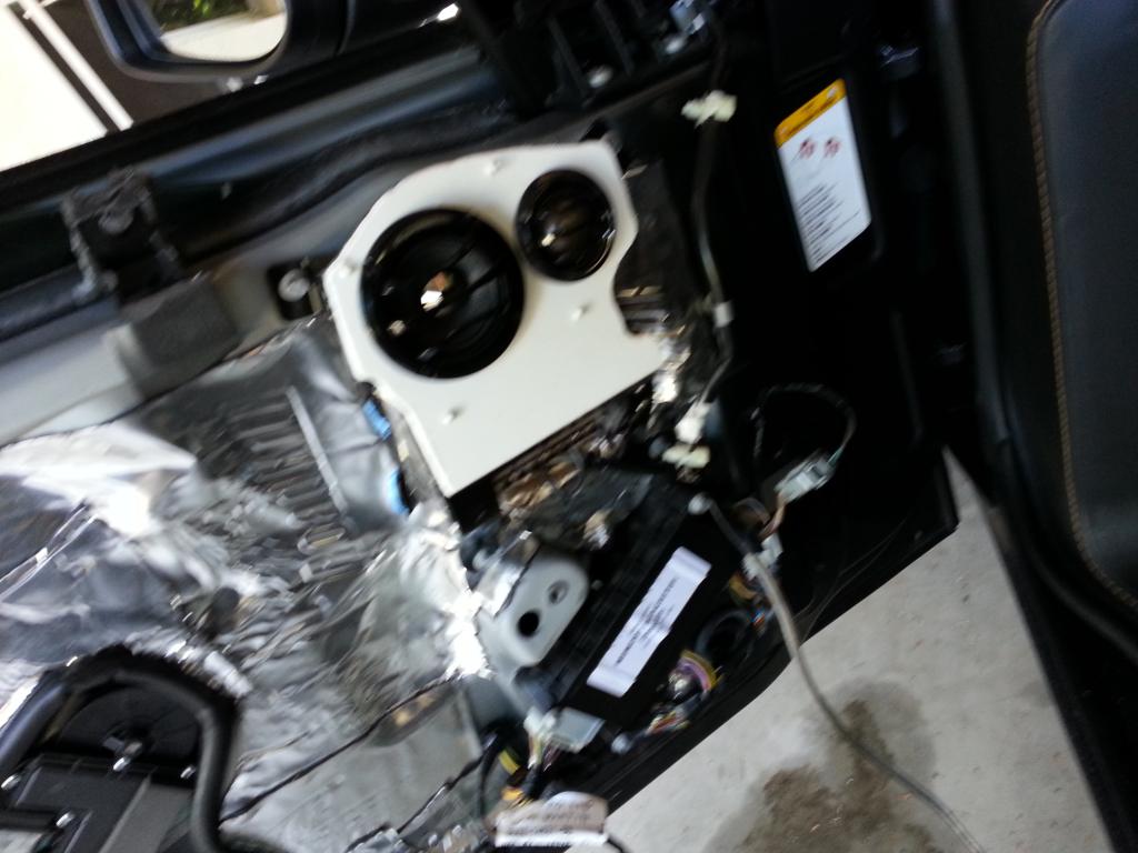

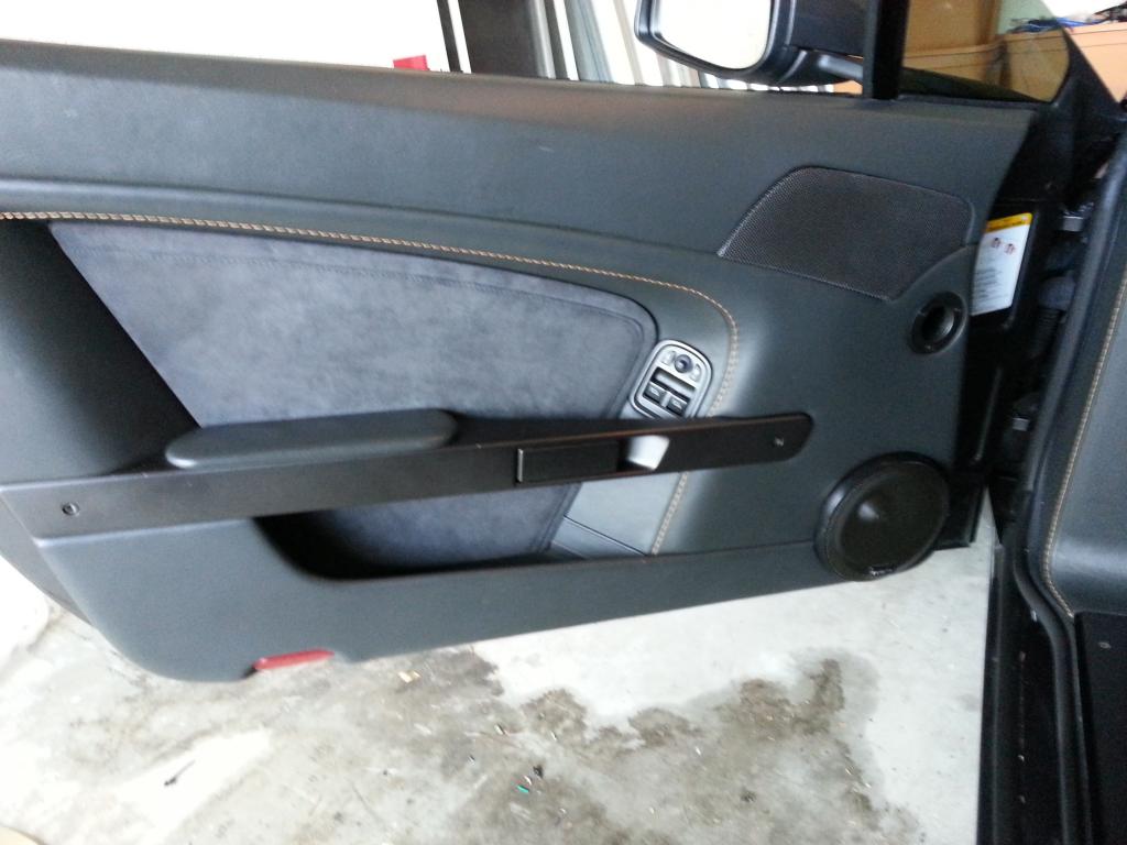

So here is what we did with the 08 Vantage Roadster.
Equipment:
Pioneer Stage 4 5 1/4 Components
Pionner 4in mid's 4 of them
2 JL Amps HD 600/4 and HD 1200/1
JL Cleansweep 441 and SSI
3 JL W3 8in Subs
Dynamated doors and trunk
False trunk plexiglass cover with leds
and wrapped everything in carbon fiber wrap
Here's some pics!
