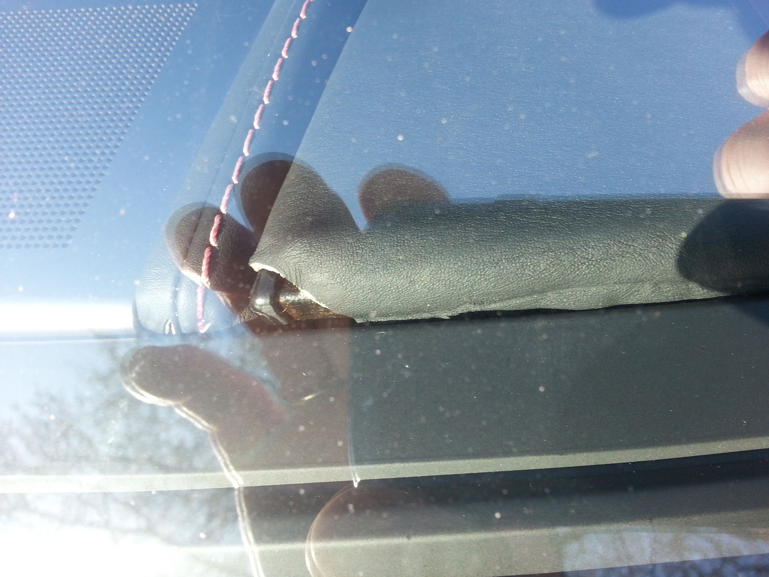

So I've had the car - what - 6 days now? The leather is pulling on the dash, drivers side, upper console near the center.
I've not experienced any other issues, outside of squeally brakes, but that's not an issue for me. This is not a huge pull, and it looks like the piece that the leather is on may be removable without removing the whole dash. Hoping someone here may know about that. I parked it one day in the sun, rest of the time in the covered parking deck at work. At home it stays inside the garage. I am trying to find a good sunshade (any recommendations would be appreciated!). I had a sunshade in my XKR that was made specifically for that windshield size and shape; trying to find the same type for the DBS>
If this is the only issue I have with the car for a bit I'll be fine. I'd just like to get it fixed. I have a call in to the dealer, but I am waiting to see what they will do about it.
If anyone has any info regarding the difficulty or expense of fixing this myself I'd appreciate any info you could throw my way! Thanks!

This is a common issue. Sun and heat cause the leather to shrink. Best to avoid leaving the dash exposed to direct sunlight for extended periods of time.

Had the same issue with my Virage, passenger side top panel. Dealer tried to stretch and re glue, came back looking like crap. Had them order new leather and dash panel from factory and install. Took a good 2 months but looks new again. I would not recommend repairing yourself, will never come out perfect. Absolutely need to keep out of direct sunlight.

I'm wondering if the 3m Ceramic clear window film would do the trick. I've seen it installed on a friends BMW and it really does work at keeping the inside temps cool even on the hottest days. Anyone else have experience with this?

Yes, I had this in my 2010 XKR and it made a huge difference in direct sun. The last place I worked I did not have covered parking and the 3M Ceramic tint reduced the temps quite a bit, as well as the UV. I had 65% tint put on the windshield...helped with bright light but was hardly noticeable.

Did you purchase your AM at Motorcars of GA? That's where I got my V8V, and the sunshade that came with the vehicle works well. Some of the dashboard leather was stretched when I bought mine, and over the last 5 months I've parked it outside during the day ~ 50% of the time (using the sunshade every time). I've seen no exacerbation of the leather problems.

Dealer is gonna fix my dash leather...so that is a good thing. I was hoping they would not come back with a "sorry that's not covered" line.
I am happy.

As I mentioned, my dealer repaired mine and it was not acceptable. The glue they are most likely going to use will not last, and/or when they affix the leather it will still show stretch marks. Check it carefully, and if not acceptable, make them order new from factory. It will take longer but will be perfect.

This typically happens with both UV and Infrared exposure. In hotter climates, this becomes more of a problem. Infrared drys out the leather while UV degrades and fades it. Best thing to do is to have a clear window film applied to the glass.
Spectra PhotoSync is what we use and what we use exclusively because of its exceptional UV and Infrared Rejection. In addition, you do not have to go dark at all....staying relatively light. They make a 75% film, which is pretty clear. For comparison purposes, factory glass is anywhere from 75%-85%.
