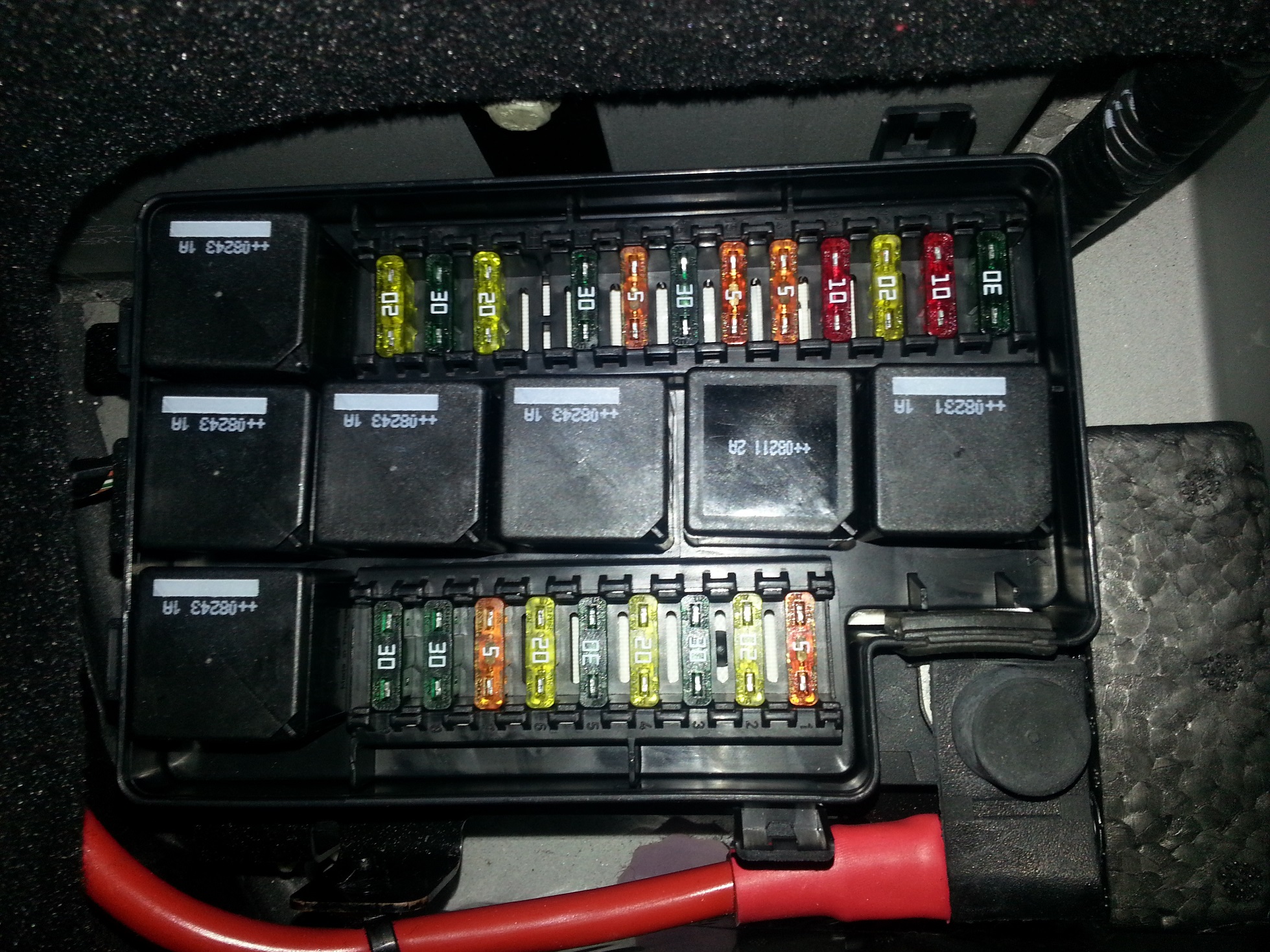

4pipes...how loud is your exhaust (inside the cabin, windows rolled up) when you are cruising? Does the loudness interfere at all with the radio "volume"?
I know that's a difficult question to answer. And, maybe I am just not completely used to mine as yet, but my exhaust is LOUD inside the cabin. Even when I am cruising, I cannot hear the radio "completely".
My XKR was virtually silent while cruising. I don't expect the DBS to be as quiet, but what I am experiencing is above what I expected.

I have the exhaust valve fuse pulled on my DBS. I prefer the sound of the car to the crap B&O sound system, the one in my BMW and MBZ are much better. You need to see if the previous owner pulled fuse 22 (I thinks that's the one). If so, replace it and the car will be MUCH quieter while cruising. The valve only opens at higher rpms.
Reading all the Fuse 22 stuff, I pulled mine. Couldn't stand cruising with it open all the time, so put the fuse back in.

Mine is still apparently in...I will check to see if the vacuum lines are plugged...cause if it is this loud with the fuse still in, if would be deafening if it is louder with it out!!

Good idea. My fuse is still in but I had the service tech plug the vacuum lines so no codes would be thrown.
