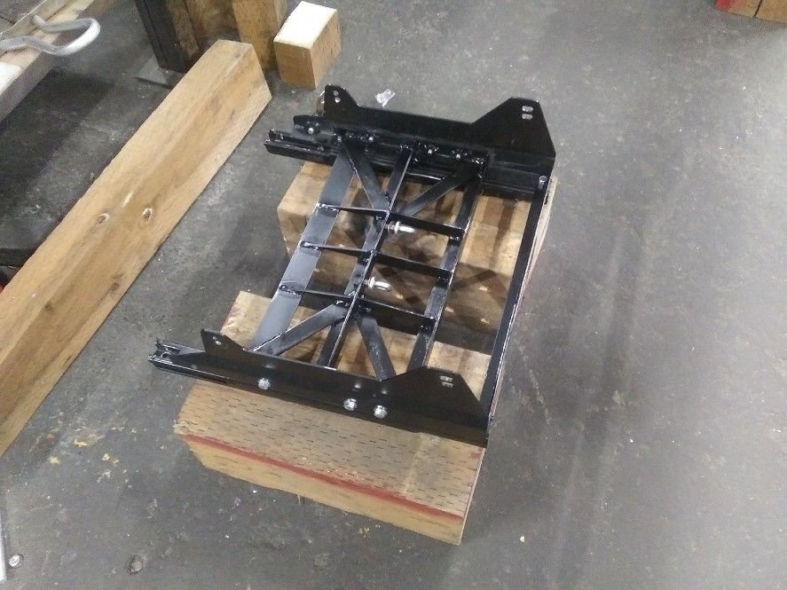

Talking Submarine Belt Subframe Rev 2
We are hard back on Rev 2 of our submarine sub-frame. This time we built it completely to the car not the seat. After several iterations we finally used temporary spreaders on the bench to hold the hole locations of the supplied seat frames to the desired width needed to bolt them into the car. This allowed us to build the sub-frame on the bench to the proper dimension. This afternoon it finally dropped right in and bolted down easily. It seems all we have to do is triangulate it and the mechanical part of the seat installation will be finished. Nice it is now a single assembly that can be easily installed and removed.
Note - the Schroth ring on the tunnel side must be straightened some. There is not enough clearance between the tunnel and the seat frame to run so much twist.

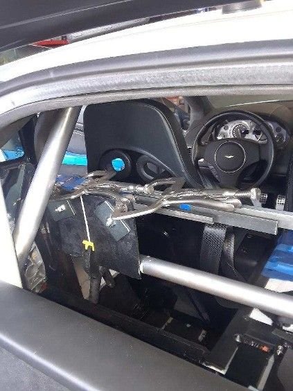

Rev 2 built to the chassis.

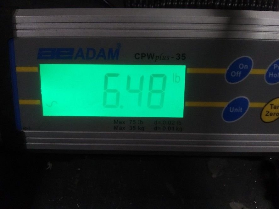

Feel good about strength, not particularly lite. We may drill some holes to get a little out of it.
Here you get the idea how narrow the seat is. Maybe 5/8' to 1' of total gap between both sides. With the sub-frame built to the car, we bolted the seat to the frame assembly and let the side rails take up the error. The dimensions of the assembly to the chassis remained unaltered . We have six connections for assembly to chassis, six connections for sub-frame to seat frame, and four connections for seat to seat frame.
It went in and we were able to thread the bolts by hand. I sat in it and it is too far back for my size - 5'6. If you are short, you need to install the risers with the double holes at the back. If you are tall, install the risers with the double holes to the front (the slides are shorter than the risers). We are hoping between flipping the risers and rotating the seat down I will fit. If not we will need to fabricate new risers which will allow us to move the slides forward. Looks like there is a good 2.5 inches if we need it. We'll get an inch flipping the risers. Wish we had pedal adjustment.
With the seat full forward you will not be able to work on the battery so we have elected not to install the slides on the passenger side. That one will be fixed. The seat feels fantastic. It fits my size very well and I am really looking forward to driving with it. Poor Mike he is really going to be jammed in there (genetics can be a cruel thing).

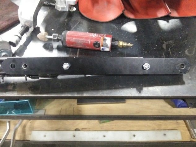

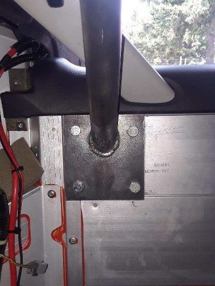

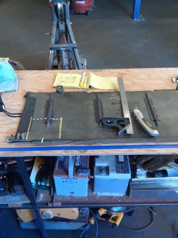

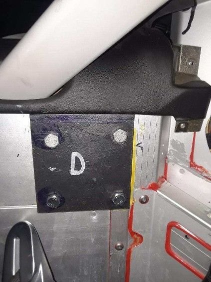

We finally got all of the holes drilled and the bar mounted.
We mocked up where the new bar needed to go. The Cobra Seat just does not fit this bar configuration. I have almost given up several times but so far everything is still fitting. We installed 1 " spacers under the feet to raise the bar. This allowed the Seat to slide back far enough for Mike to be able to drive. Raising the hoop requires either raising the stays or rotating them down. We opted to raise them. This negated being able to bore holes thru the back panel so we opted to window the rear panel.
Since we opted to raise the stays we cut off the original feet and welded on new ones. In the picture below you see the stepped joint and the fastener in the joint. The rear panel has molded in stiffeners that also hold the panel off the rear bulkhead.
We wanted the new feet to be co-planar with the panel. That required 3/8 thickness. With that thickness we were able to machine a step into the backside of the foot so that it cleanly overlapped the joint. We bored a relief on the back side of the foot to fit over the fastener.
Passenger Side
After a lot of configuration choices we opted to add a 2nd horizontal bar and weld a plate between the two. We will install eye bolts into the plate which the belts will clip into.
Here is our mock up with a plastic dummy plate.

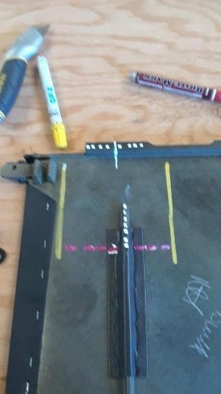

Here you can see the standoffs on the back of the OEM PANEL
