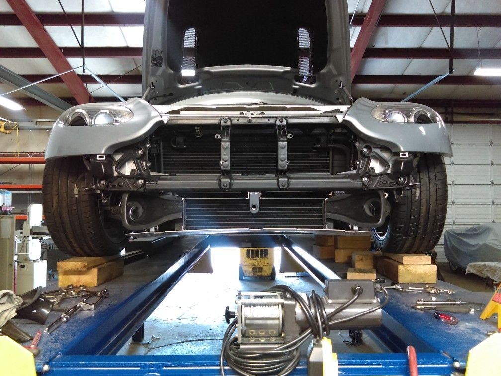

We are off by 5/8 at the bottom - cover has to go aft. The inlets are as good as it get vertical horizontal.

We are buttoning up the front. Everything had to be trimmed aft 1/4" and we had to provide clearance for the lower grill mounting tabs.
L brackets attached for mounting the ducts
We clearanced the ducts at the top to accommodate the lower grill mounting tabs. Our oil cooler mounts had to be clearanced also.
Engine plate sealed to OC duct. We used some rubber door trim on the bottom of the feet.
An enormous amount of detail to get everything to fit with the OEM suuroundings. Nothing contacts the bumper or lower grill.

And ducts installed - just have to cut the toe point access hole in grill.
