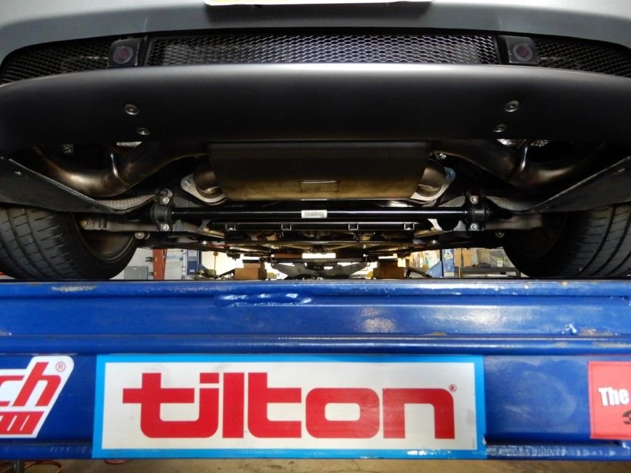

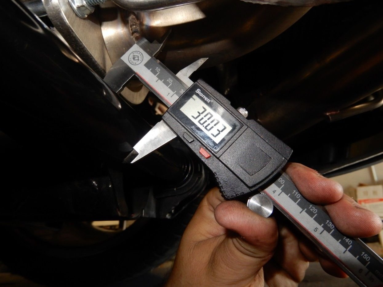

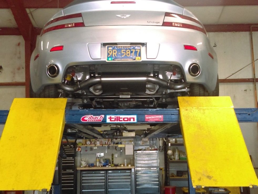

Well we do have some leaks - the x-pipe connection to the stock exhaust leaks on both sides. The Aston clamps are welded into place so any mi-alignment in the pipes cannot be clamped out. We ground off the welds of one of the clamps and rotated it and made good headway, but still leaked a little because we are against the stop block before the joint is fully sealed. There is no noise, but it is definitely spitting thru the gap. I ordered some stepped clamps from Summit.
The sound - just love it. It is not loud which is great. It is quite a bit more high pitched than stock, but the volume is very fitting for the car. Driving the Mustang with nothing, but a pair of Borla mufflers can cure ones need for noise for months at a time . Last time I drove it I used ear plugs under my helmet.
We are waiting on the tune from VAP. Probably get it tomorrow. No CEL or any other strange messages.
Side view for reference.
VAP Sport - perfect fit - love the sound. Rich has a Sport Pack rear bar ordered.
Driving it with that noise is a hoot - can't wait to get it to PIR where we can really run it. I won't be wearing ear plugs
Gets lipstick Monday morning.

Muffler Valve Vacum Pump Delete
While putting the rear fender liners back in I remembered the pump for the OEM exhaust valves. We unplugged it from the harness and started it up and got no complaints so we pulled it and the tubing and thru it in the parts bin.

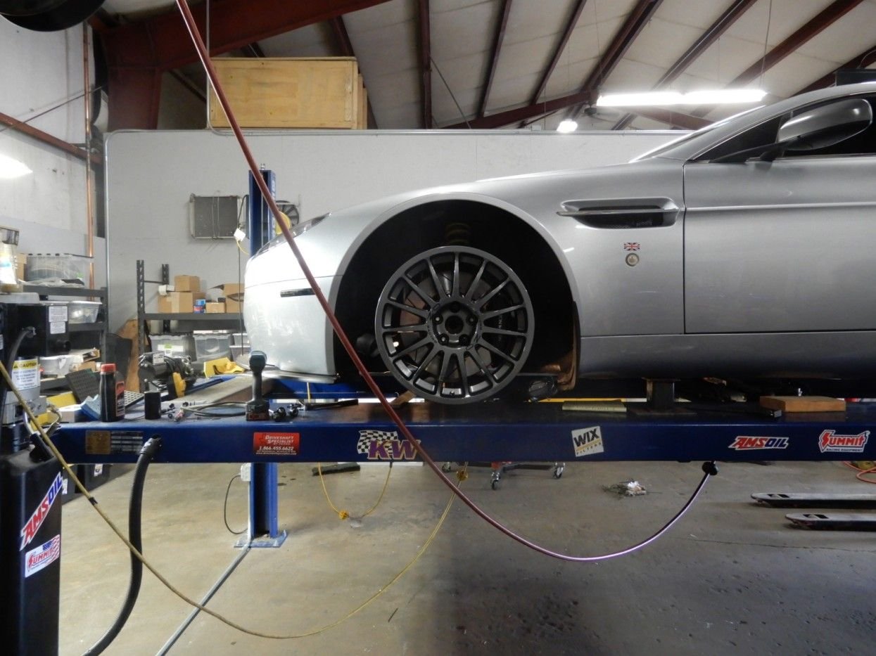

On KW Coilovers. 15 clicks from full soft to full hard. They were delivered set at 7 clicks. This was too soft for me. I ran the compression as stiff as it would go and it was great, but far to stiff for street (will run them on the track this way). I backed it off to 11 but it is still a tad stiff running slow. Next time we have it on the rack I will move it to 9. A good friend drove it and likes it the way it is. If you are pushing it, it does great, but slow speed bumps are a little harsh for me. I have not played with rebound as it is quite fast at the middle setting.
Drive-ability - It is such a different animal. I am not use to such balance. Turn in is so quick I tend to overdrive the apex. I have yet to find the swing weight against the steering. The flash tune corrected all of the hesitation and I can heel and toe quite easily. I have been running with just the exhaust for several days and was actually finding the timing for heel and toe in the stock configuration. The tune eliminates the anticipation needed to spin it on time - very nice.

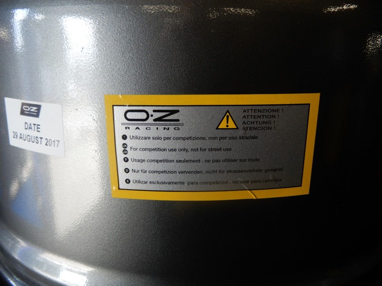

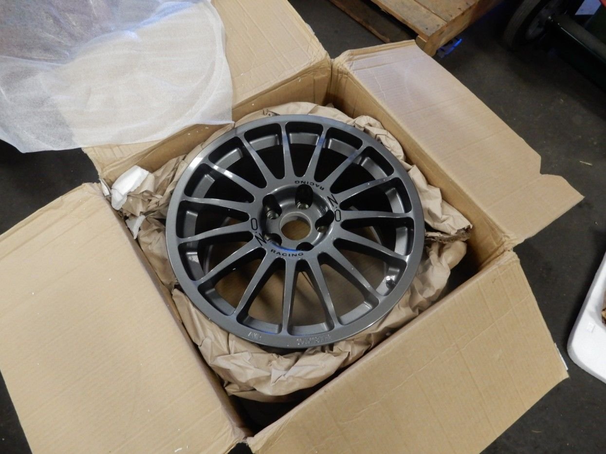

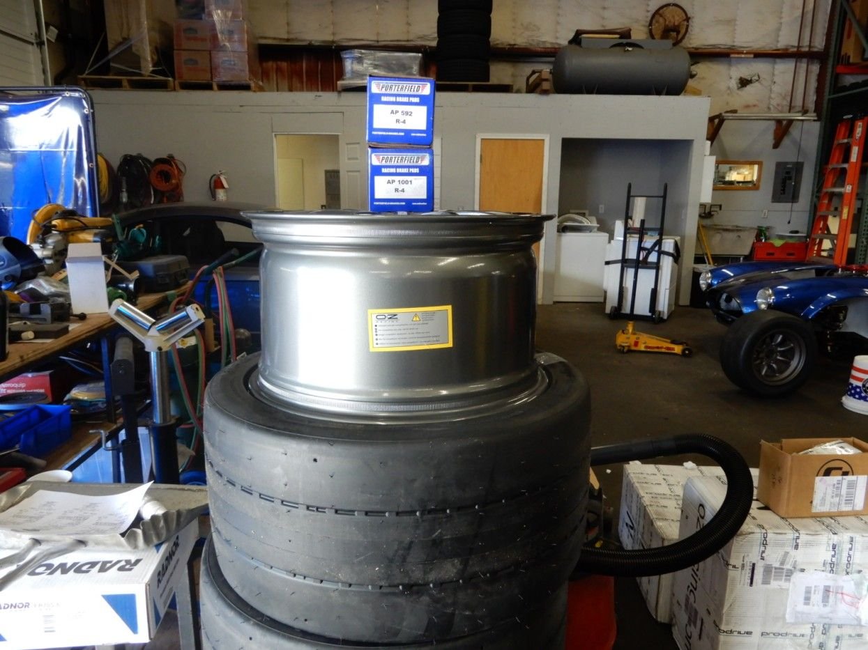

These came in today. The most difficult shipment ever. Ran into all kinds of GOVCO regulations. I still only have 3 Hoping the 4th will arrive tomorrow. (beautiful - Thank You Stuart)
Track pads (I hope they stop better than the street pads) - 18x10 - 275 Goodrich R1. Once we get some experience and can see how the brake ducts package we will most likely put a wider tire on it.
The R1 likes -2.5 Camber. Can anyone recommend caster and toe for track work?

Awesome stuff as always!
The R4 pads will stop you like crazy, especially with those tires. You're going to generate a ton of heat, so I'd recommend some upgraded brake fluid if you haven't gotten to it yet.

x- We run Wilwood 600 and fully flush every time we run.
