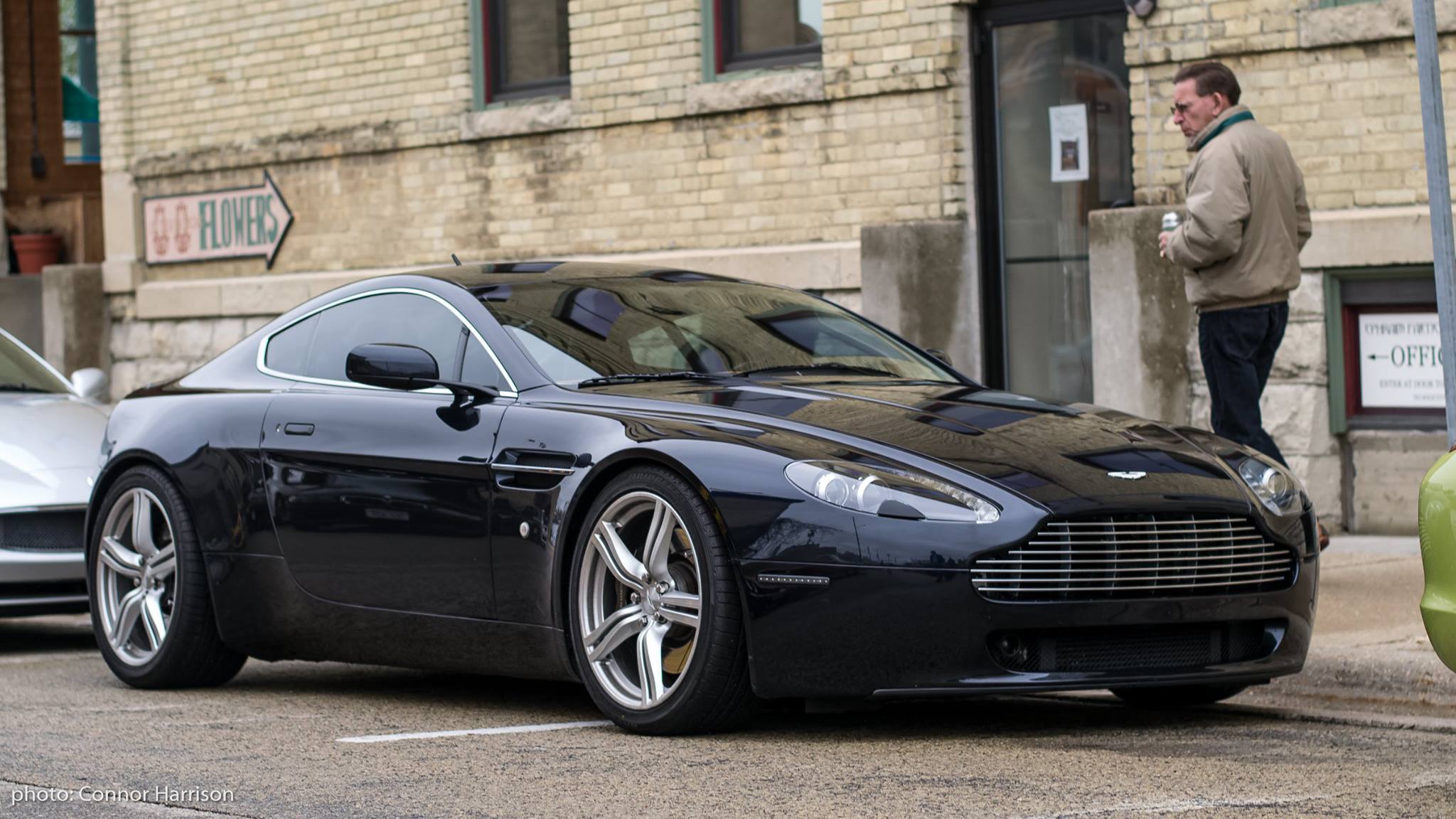

I think you can see here the fitment

Looks great in the pic!! i think i will try the 11mm first and see how they look

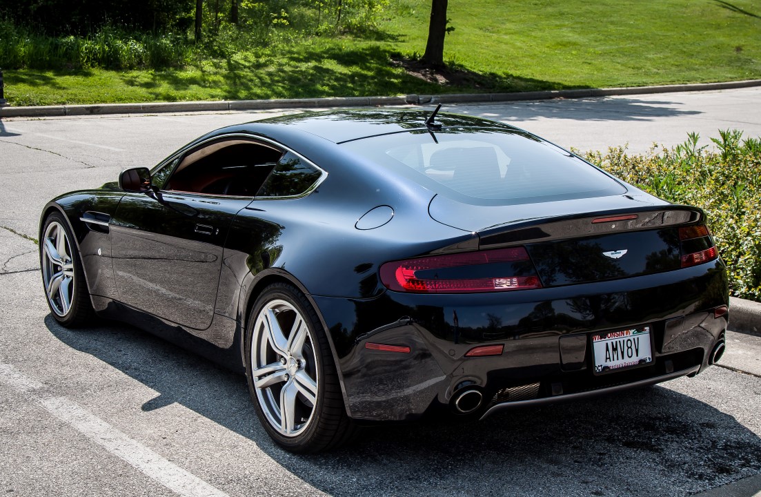

I have the RSC spacers and H&R springs.

Jeff, that looks really nice. Which size RSC spacers are you using to be clear?

15mm front and 20mm rear. My car's previous owner had them installed with new studs. With the H&R springs (also installed by the previous owner) the tires fill the fender openings perfectly. Here's a photo from the rear -
Name:	badgerbimmers-2728 (Custom).jpg

You're right, that is perfect!!!
