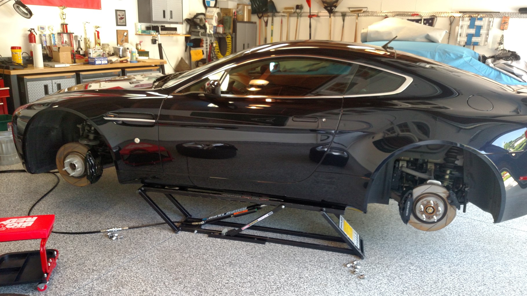

I have Quickjacks, too. Best garage thing I've ever purchased.
Name:	IMG_20160618_112121951 (Custom).jpg

do they somehow lock in place? Those look kind of freaky
Yes, they lock in place at two heights and are not freaky at all. They are extremely stable.
