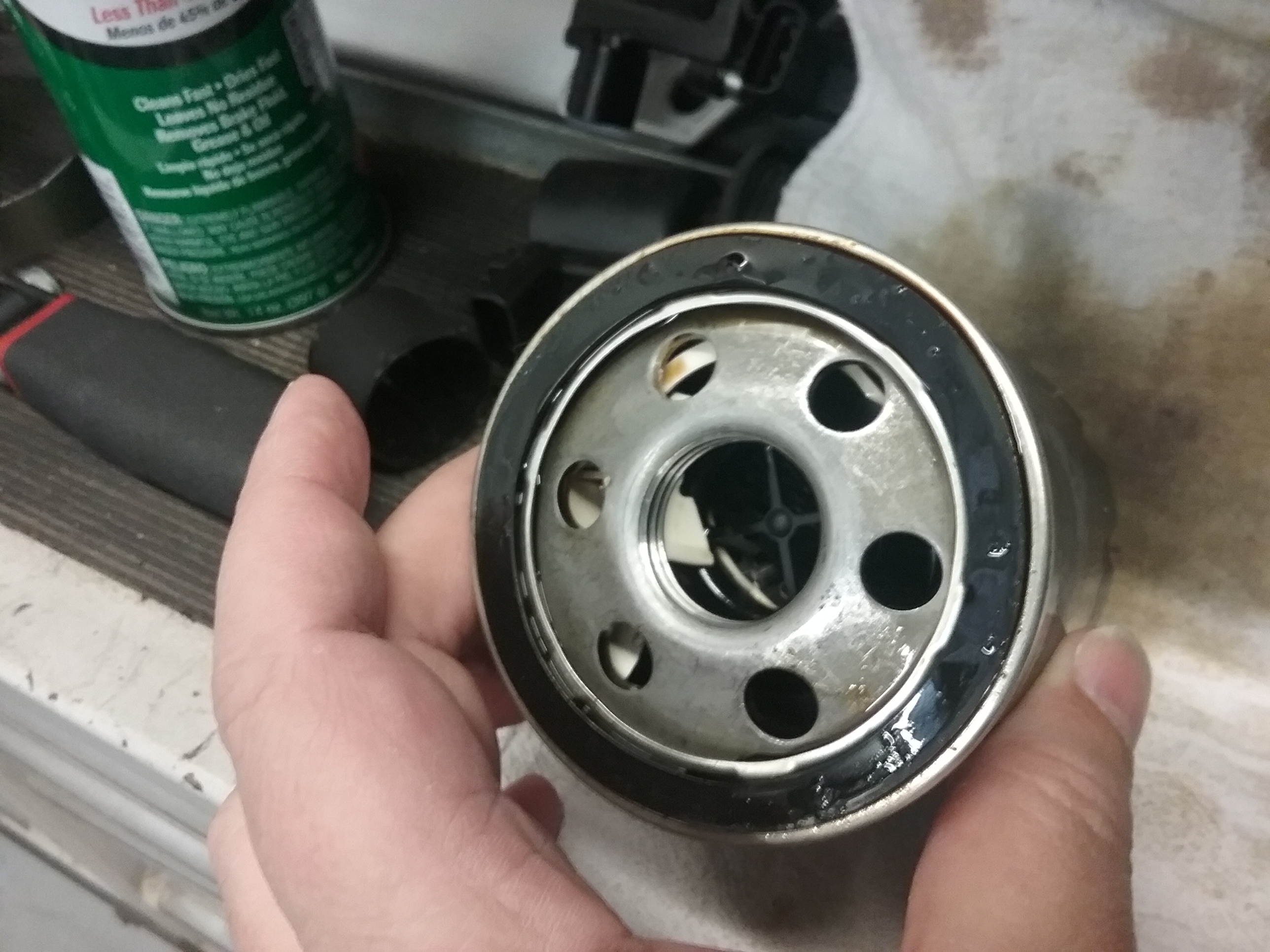

Originally Posted by HabitualOffender
But there is an important reason why everyone should have their cars serviced at the dealer.
I know several of you asked why I said this, besides that I firmly believe my baby is in much better hands when the most experienced are working on it, but if I didn't always have it dealer serviced I'm not sure I'd be able to report -
Originally Posted by FC Kerbeck Aston Martin
I wanted to let you know parts has the ticket and approval to order the engine under Aston Martin Warranty.
Steve found the cause was an imploded oil filter that strangled the flow of oil so that it could no longer reach the top end. It was a dealer installed part failure as they did the oil change. If I had done it in my driveway or had an indi do it, it would not be a dealer installed part. I would not have the help and support from my dealer service department and I don't know that the factory would make the same decision to replace the engine under warranty. Considering the warranty cost of the long block alone is $44,000 I'd presume they might not. Imagine what the retail cost of the long block is! But by always having the car serviced at the dealer and having their support, England is going to cover the engine.
I feel like I've been holding my breath for the last 10 days and can finally breathe. It took 2 months for the last engine to come in so that's the probable timeline, and then a week of work pulling the body off the drivetrain, pulling the engine, transferring everything from my engine over to the long block and then mounting the body back onto the drivetrain. And as much work as that is, I am so happy it's in very capable and experienced hands!
So yes, I absolutely recommend that you have your Aston serviced at an authorized dealer! I know I always will.
That such a simple part can cause such devastation boggles the mind.

good for you but not so good for most of us that do our own maintenance on our car. We go out of our way to buy Aston Martin oil filter so things like that doesn't happen and you are telling me that one of their own oil filter crapped out... I feel a lot less confident now about their own oil filter... If I changed the oil myself and I had the same thing happening to me with an Aston Martin oil filter purchase at a dealership, I would also get them to replaced my engine even if I did the oil change.
