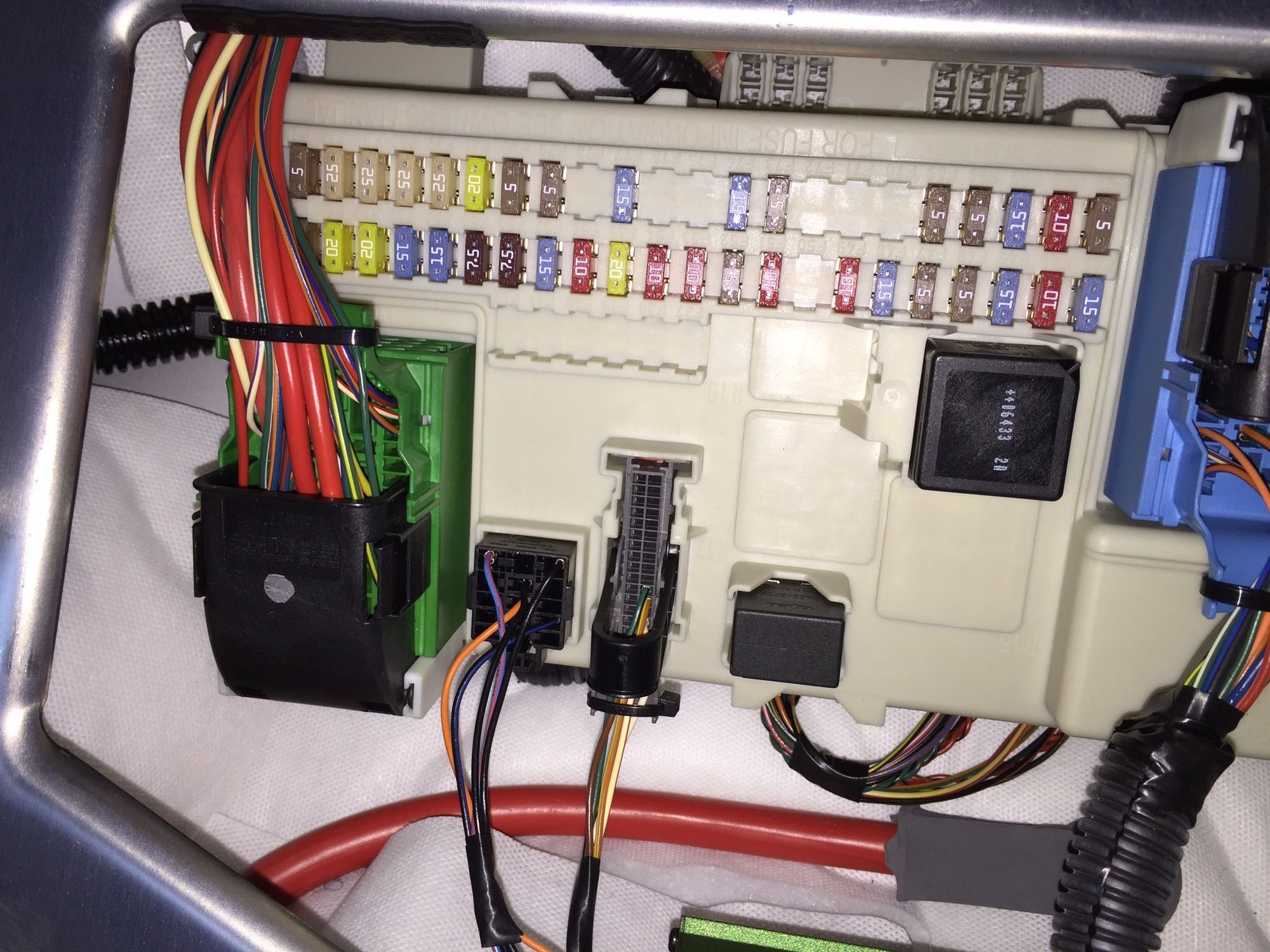

Based on your pictures the dash cam is designed to be powered via a fuse tap. If Red Pants did not specify a fuse, then it’s up to you to find a fused (power source) that meets your needs. For most people a fuse that is “Hot” when the car is on and has no power when the car is off, meets their needs.
My personal recommendation is to use fuse number 22 in the fuse box located in the trunk. This fuse meets the above criteria and only powers the vacuum pump necessary to operate the exhaust valves.
If the wires won’t reach that far, or you are not comfortable with that location, then the fuse box underneath the passenger foot well is your other choice. (Picture attached)
You are then responsible to locate a fused power source that meets you needs. A few minutes with a multi-meter should suffice. If you desire a specific fuse, the fuse box has a diagram specifying what each fuse is responsible for. Be forewarned, it’s pretty confusing.
I have sent you a PM with a link to my website detailing the installation of a radar detector located on the rearview mirror stem. Although this installation is powered from the home link mirror source, it details the removal of the rearview mirror that you might find helpful.
Good Luck
