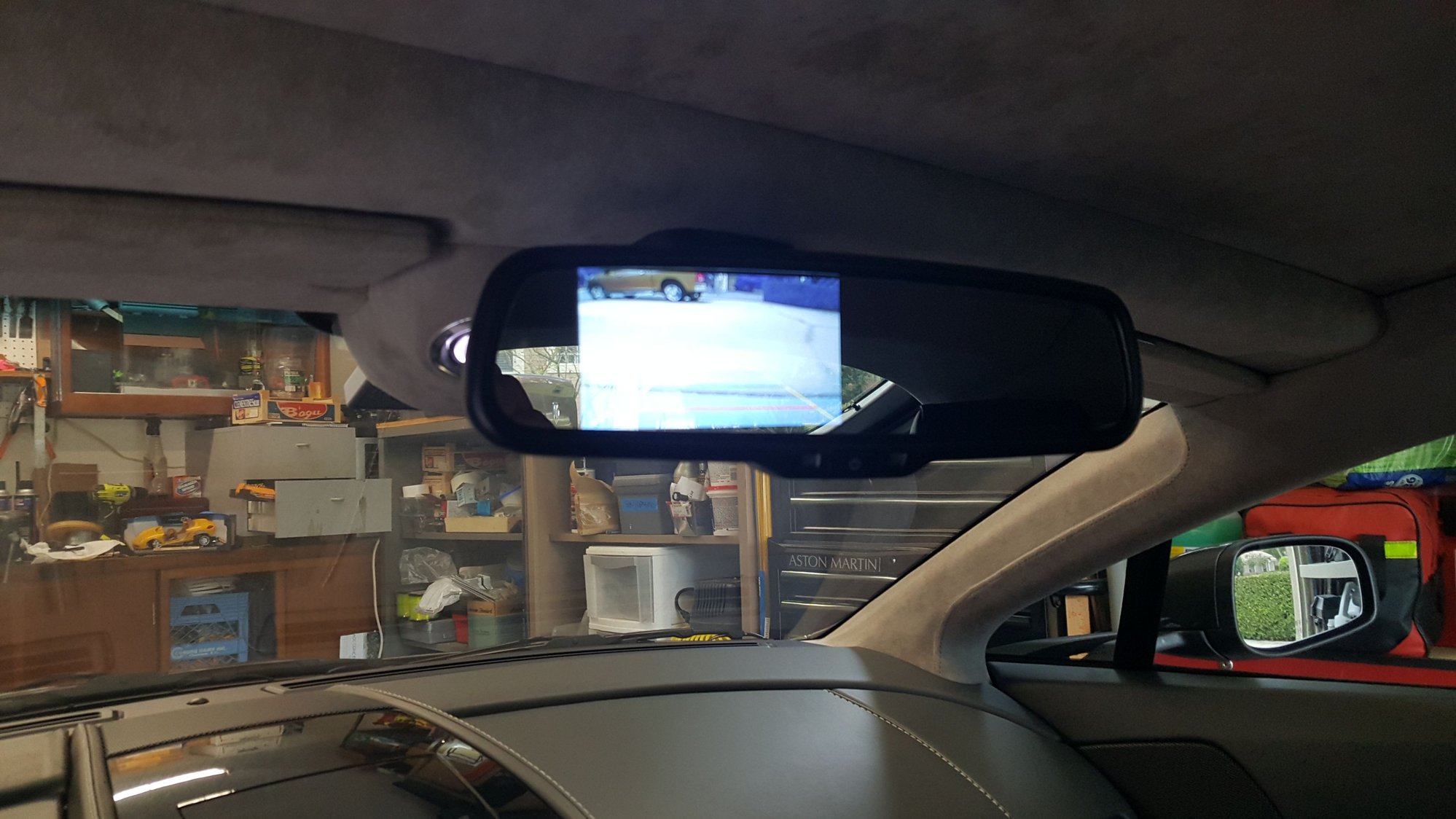

navigation, nav screen, location resolution, e.t.c is simply awful...i never use it v at all...
I have my front and rear cameras tied to video rear view mirror... so much better that trying to compromise using and upgrading the existing screen, orientation and resolution...

Originally Posted by corveight
Where did you get your mirror?
several threads
last one was earlier this month... a couple of pages back..
The definitive guide to backup and front camera installation...
