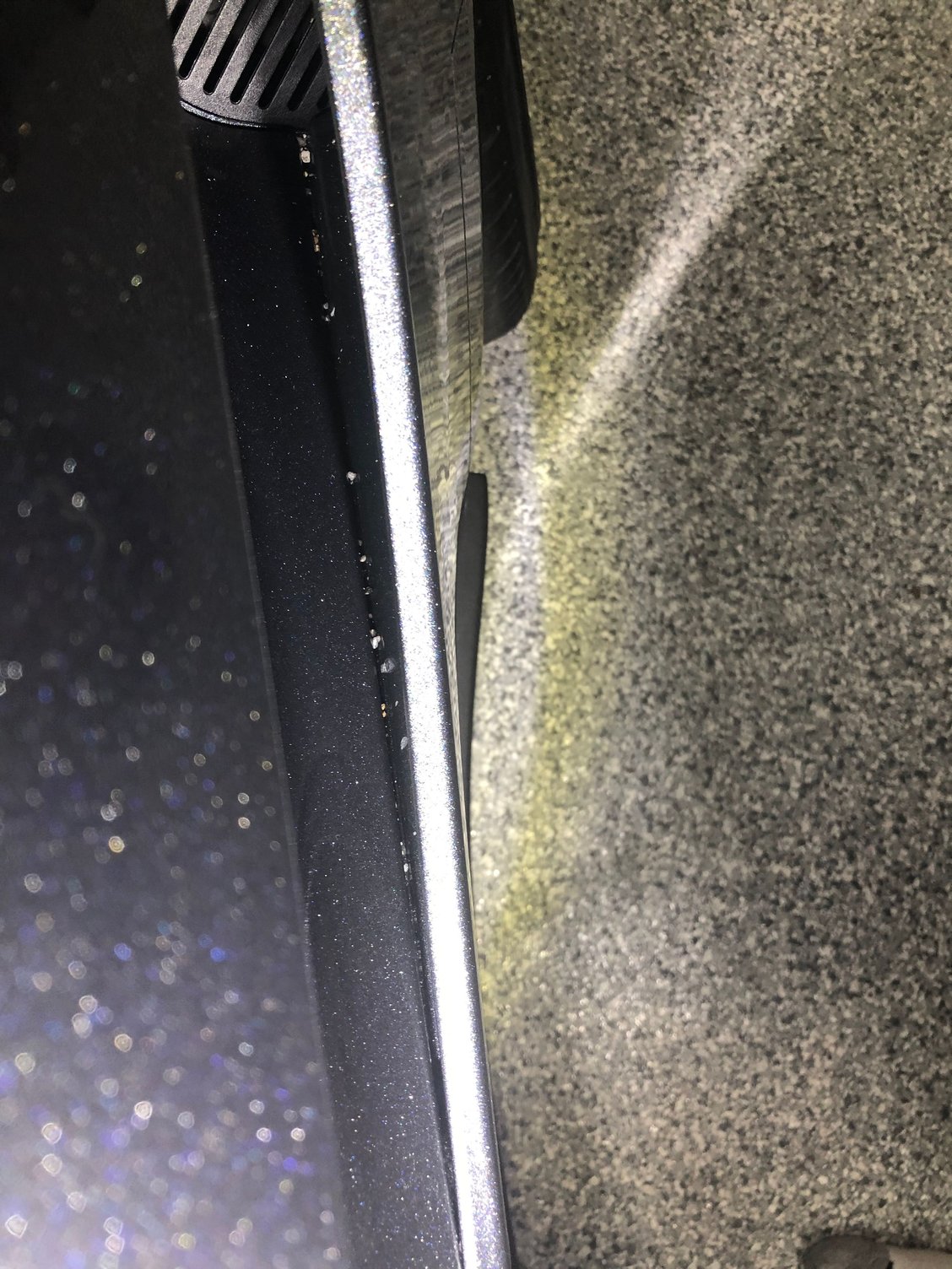

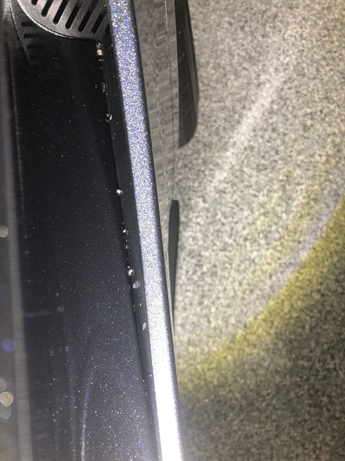

Just reporting my experience with the new Vantage’s side vents. I get that the purpose of the vents is to relieve built up air pressure while underway.
The vent opening however allows small pebbles and sand coming off the front tires to accumulate.
The base of the vents capture this stuff and you can’t get it out because it’s dumped in a cavern formed by the 2 body pieces.
There must have been a way to make a finer screen to prevent this from happening because it’s looks really messy from the outside.

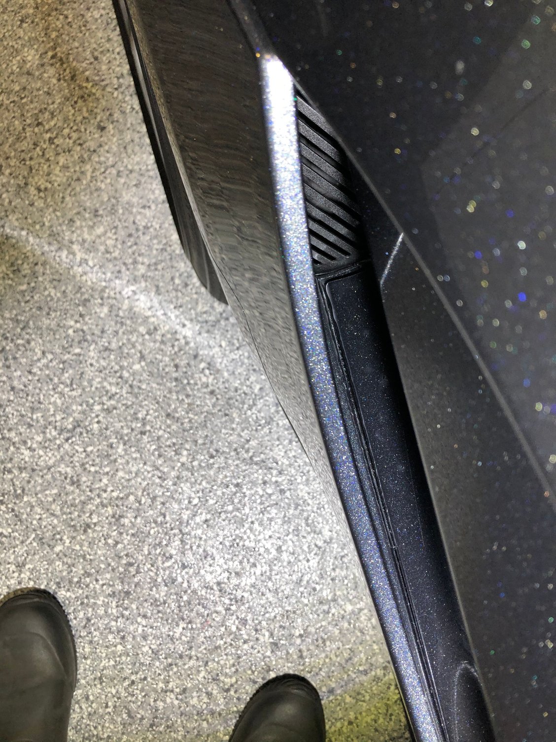

Here you go. Total of 127 miles on new car. Only driven on established well maintained Florida paved roads..

Tanks for the suggestion. Tried a hose and compressed air as well as my MetroVac car dryer.The material gets wedged in and you can’t dislodge it without scratching the paint.

I do have Expel PPF on the front bumper and 1/3 of the hood. The car was ceramic coated. As I said the problem
is the tight wedge created by the bottom form of the vent. Debris gets caught and is probably pressed down
by the wind flowing over it. I can’t imagine what it looks like inside the metal or carbon fiber side vent covers
offered as a factory option.

Dug out the debris (2 hours) with tweezers...yikes. I am inserting thin rubber screening spline into the vent’s base to fill in the groove. This should allow foreign material to be blown out of the rear of the vent as you drive.

Well I think I came up with an easy solution. I tried weeding into the gap various sized screens splines which neither looked good or would have worked. I cut a strip of Expel PPF strips 2x6”. They work perfectly by covering
the channel created by the joining of the 2 body panels eliminating stones from gathering inside the joint.
Of course the added feature is that you can’t see the fix.
