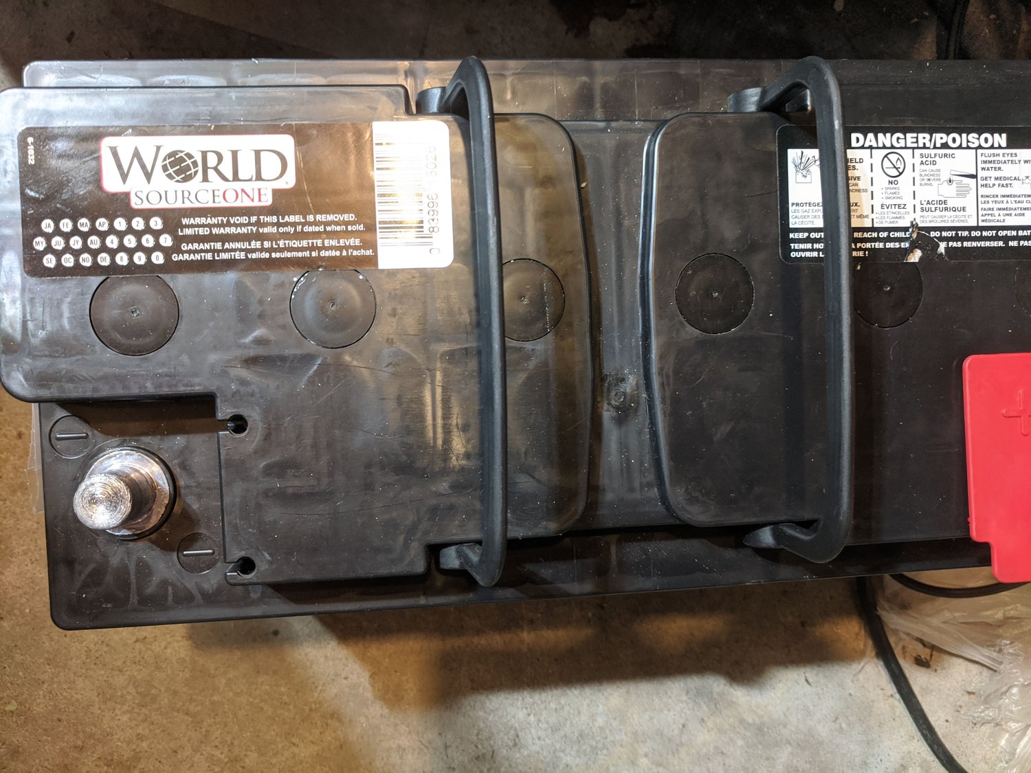

just replaced the battery on my 2010 v8v with an odyssey pc49-950. battery fits well into the existing tray. I retained the cars settings by connecting the odb port under the drivers side with an odb adapter connected to a 12 v source prior to disconnect. Realizing that the pos cable was live, I wrapped the pos cable with a rubber glove and zip tied it to keep it in place.. Seems to have worked. All settings were retained and the car appears ok.
there were a few quirks in the change-out including the strap having torx bits vs sockets . The removal of the sliding aluminium retainer clamps was difficult. Initially I tried to push in the trim panel on the one side using a custom cut old hockey stick (Carbon see pic) to wedge it back but in the end found that bending the bottom out allowed me to slip in the clamps behind the trim panel and get them aligned. Be careful of all the wiring behind this trim panel
The Odyssey battery is a brute; 28.49 kg (63 lbs). Its an AGM and requires no venting
The old battery is a world source one (pic). I dont know if is the original or a replacement but given that I have had the car for 3 yrs and the prior original owner could not recall changing it, I opted to put in fresh. There was no info on the battery indicating its date of mfg.
I have used odyssey batteries in my sleds and they seem to retain their charge well even when being left all summer without a trickle charger. Come winter my sleds start no problem. Here is hoping this is the same. I want to thank all for the feedback on the project as well as the very useful videos put out by both Redpants and CTP 1111. The video by Redpants highlighting the issue of the retainer clamps put perspective on the job for me; I didnt feel like such an idiot trying to get this job done.And I fully endorse the notion of the Aston engineer who designed this system having his shins bruised
