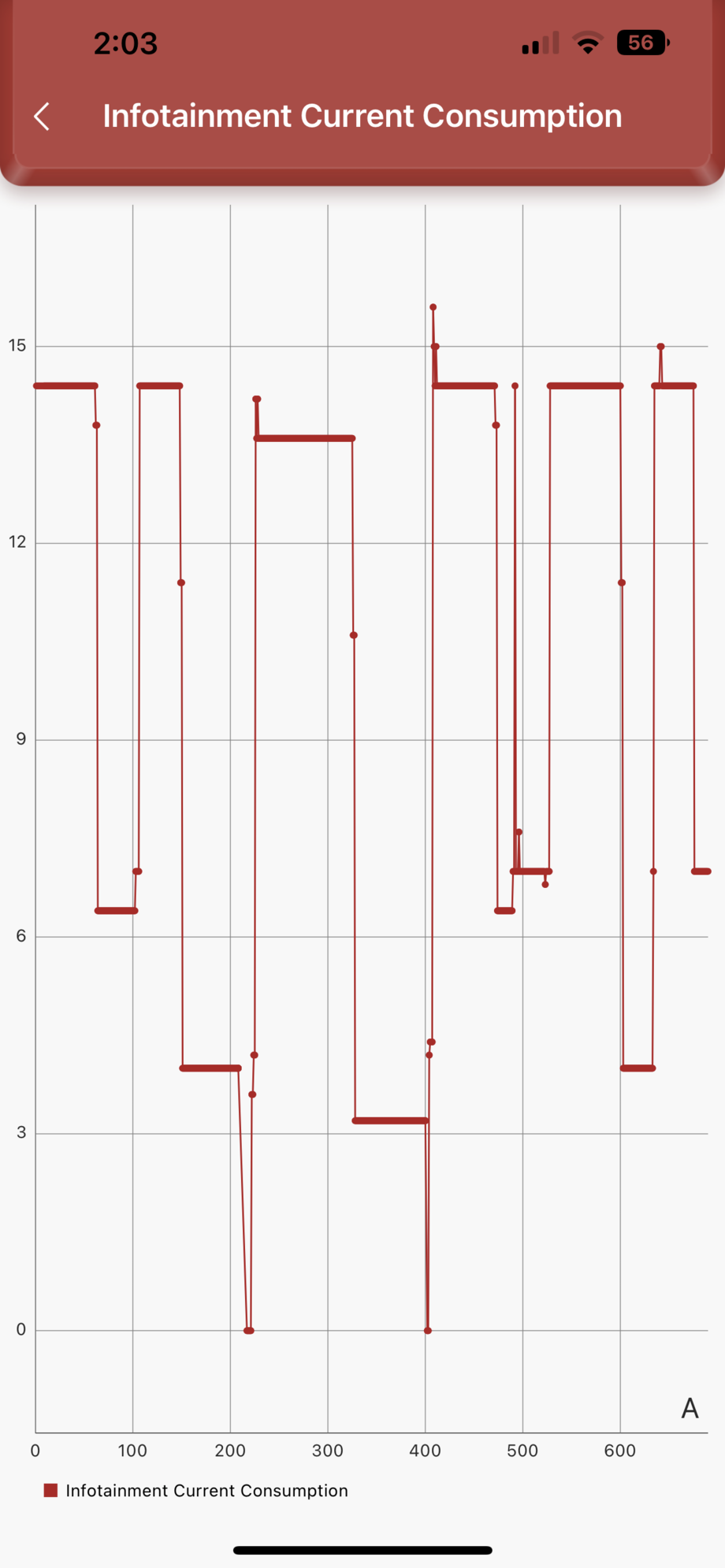

I check the old unit by obd streem
the cause screen stay open or on sometime is the system voltage did not cut power and stay about 6V sometime and never go lower that that think make it’s stay on
it’s should go 14v when key is on position
And go to 4V after key out or turn engine off it’s get to zero after 40 second
Old Nov 12, 2022 | 03:08 PM
Kamrooz Karimi's Avatar
5 Year Member
Joined: Nov 2019
Posts: 39
From: WA
Kamrooz Karimi is infamous around these parts
Live data
14.4 V navigation going work and open
6 v navigation stay on for ever
when go to 4 and after 0 it’s close and shut down
