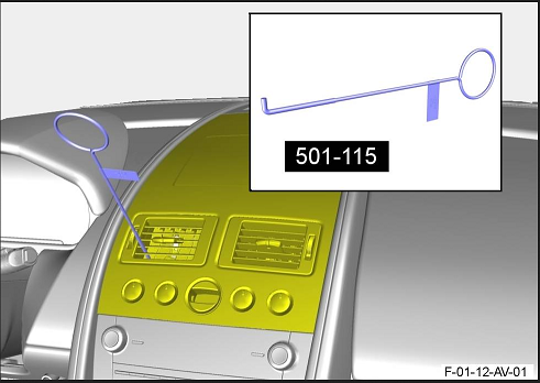

Did you use the "special tool" 501-115 to remove the ski slope? Or you just pulled up with no prior tooling?
I just don't understand what would be the purpose of using this tool?
Old Jan 16, 2024 | 07:20 AM
Teekster's Avatar
Joined: Jul 2014
Posts: 101
From: Minnetrista, MN
Teekster is infamous around these partsTeekster is infamous around these parts
Just pulled. It came out a bit abruptly.

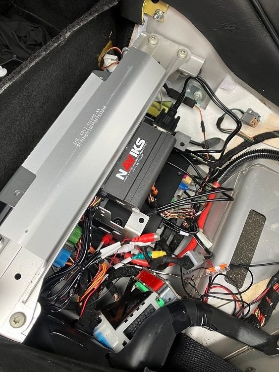

Finally complete the installation of the Naviks today.
All went well and I now have backup camera, which is really useful on these cars.
I tried the Iphone mirroring, and it's working too.
I didn't install it today as I didn't feel like removing the whole center console...
Somehow, my boot lights came back to life and are now turning on when I open the trunk

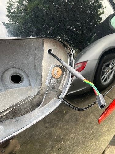

I had to drill a hole to get the camera wire from under the bumper to inside the car.

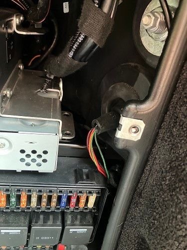

I removed the tail light since I wanted to clean the connector because my light is not functioning properly (that didn't help...) so I found a spot there...
The most challenging was splicing the "reverse" wire into the tail light harness as this is a really tight space:

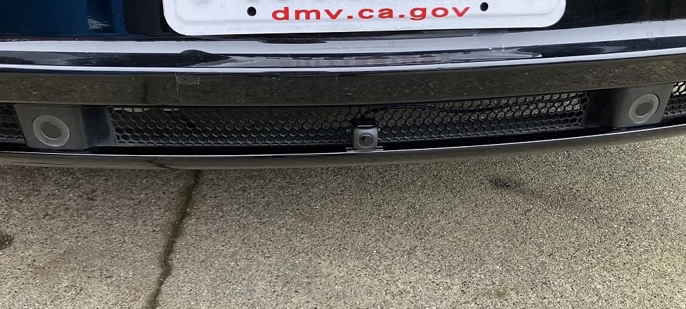

All good now! I centered the camera between the 2 parking aides.
