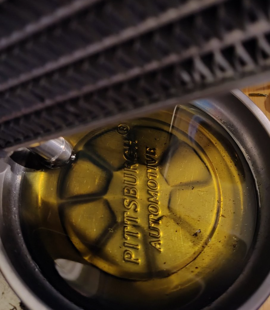

Did a drain, flush, fill of the rear diff and cooler. Turns out there was a bit of grime in there!

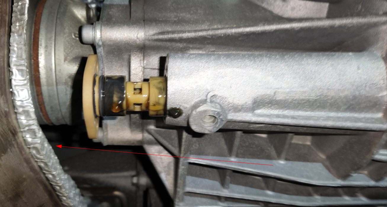

Found the fill and drain plug and filter housing. I did need to loosen up the rear exhaust heat shield so the filter would have enough room to pull out completely.
Drained and removed the filter. There was a LOT of black and ferrous grime in the oil and filter, took a picture of what was sticking in the pan as I emptied it.

I then refilled with cheap EP gear oil to flush out system.
Ran the car while lifted to run the oil through the diff casing and the cooler core. Caution! Turn off DSC completely. And you'll get ABS errors that you'll need to reset.

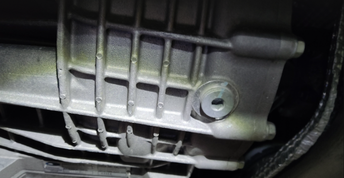

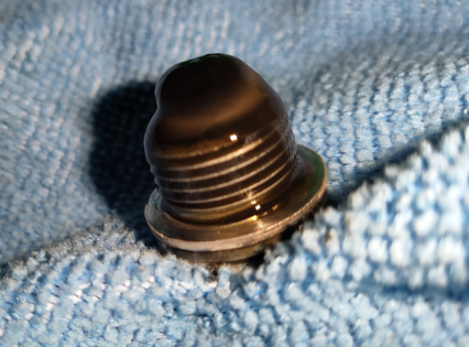

Finally, changed the drain plug out with one with a stronger and larger neodymium magnet. It's a standard drain plug size M18x1.5, so I got one spec'd for a Porsche with copper washer. I filled up the cooler core with oil and used temporary plugs so I could re-install without spilling it.

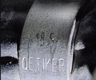

Will need 2x Oetiker 18.5mm replacement clamps to reinstall the cooler.

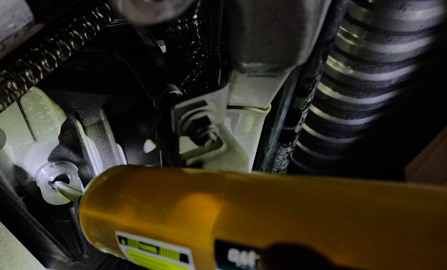

Refilled, the pumpkin, reinstalled the cooler, ran the car again and re-checked the level. One thing that's immediately obvious from the lack of smell is that it's not a traditional Sulfur Phosphorus based gear oil so it's a lot kinder to yellow metals.
All Good!
