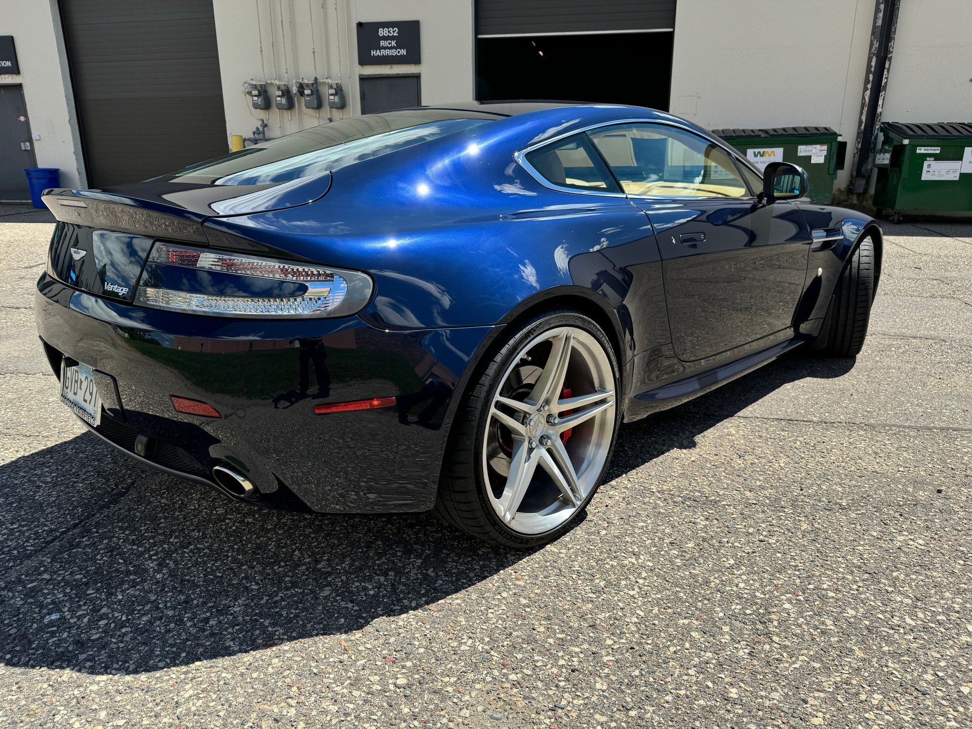

My 2011 V8 Vantage (sportpack) has 20" front and 21" rear wheels from this forum items for sale off a DB9. There was an initial scraping noise as the wheels did not exactly clear the brake caliper and would scrape on occasion. This was solved by a very narrow (about 1/8th inch) wheel spacer. I try to keep the car pristine with updated services. The brakes are Porterfield with about 1000 miles, and at a recent service by Aston Martin they came through fine during inspection.
The sound corresponds with lower speed braking and seems to be coming from drivers side rear (plenty of clearance on tires and wheels).
I think it might be the parking brake not set right maybe? Maybe a bearing? Am taking it in tomorrow to a service center by my office (I no longer trust Morries Aston Martin Minneapolis since they did my last service) to see hopefully where the noise is coming from as it's not consistent.
I have Quicksilver Exhaust - no valves, and otherwise back there no mods in the rear of the car other than DivinaTech tail lights. The noise started around the last service at Morries. They did install the Velocity AP transaxle return feed lines. Not sure they would have touched suspension stuff for the line installation, or did not tighten something.
Anybody experience similar noise.... again only braking as speeds get lower.

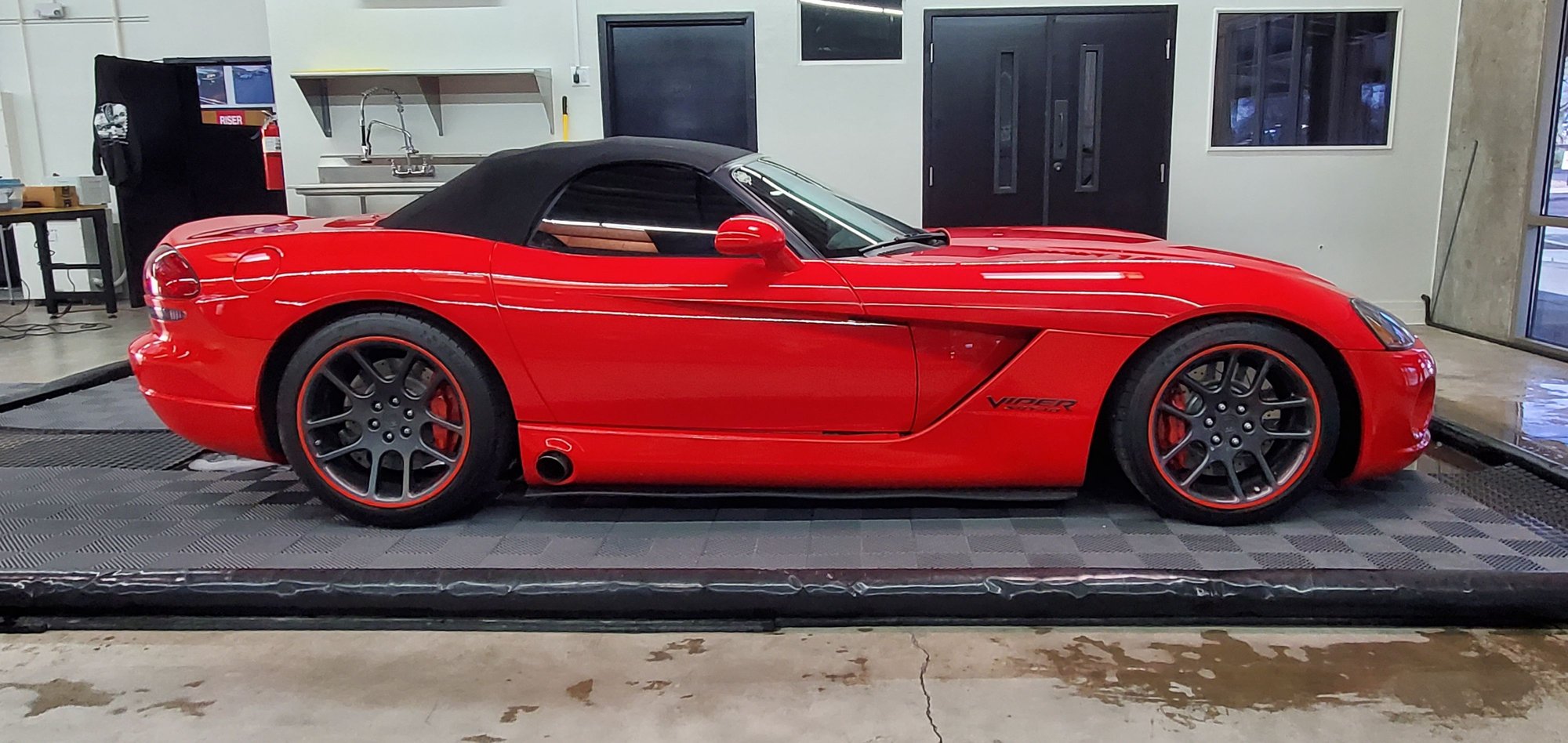

The pad/piston is not like your other brake calipers, they will stick. It stuck on my Dodge viper and does so with other cars with a separate E-brake only setup. You can take if off, just the pistol, adjust the cable. Etc... but it will evenutally do the same thing and slightly graze the rotors.
Not the best picture, but it has the same type of brake calipers set up. Also if I'm not mistaken. The brembo calipers are pretty much identical and have been told the pads are interchangeable

So how do you prevent the pad/piston to stick? Any preventative maintenance? I think I can see a slight sign on my rear rotors, and had no idea where that was coming from...
