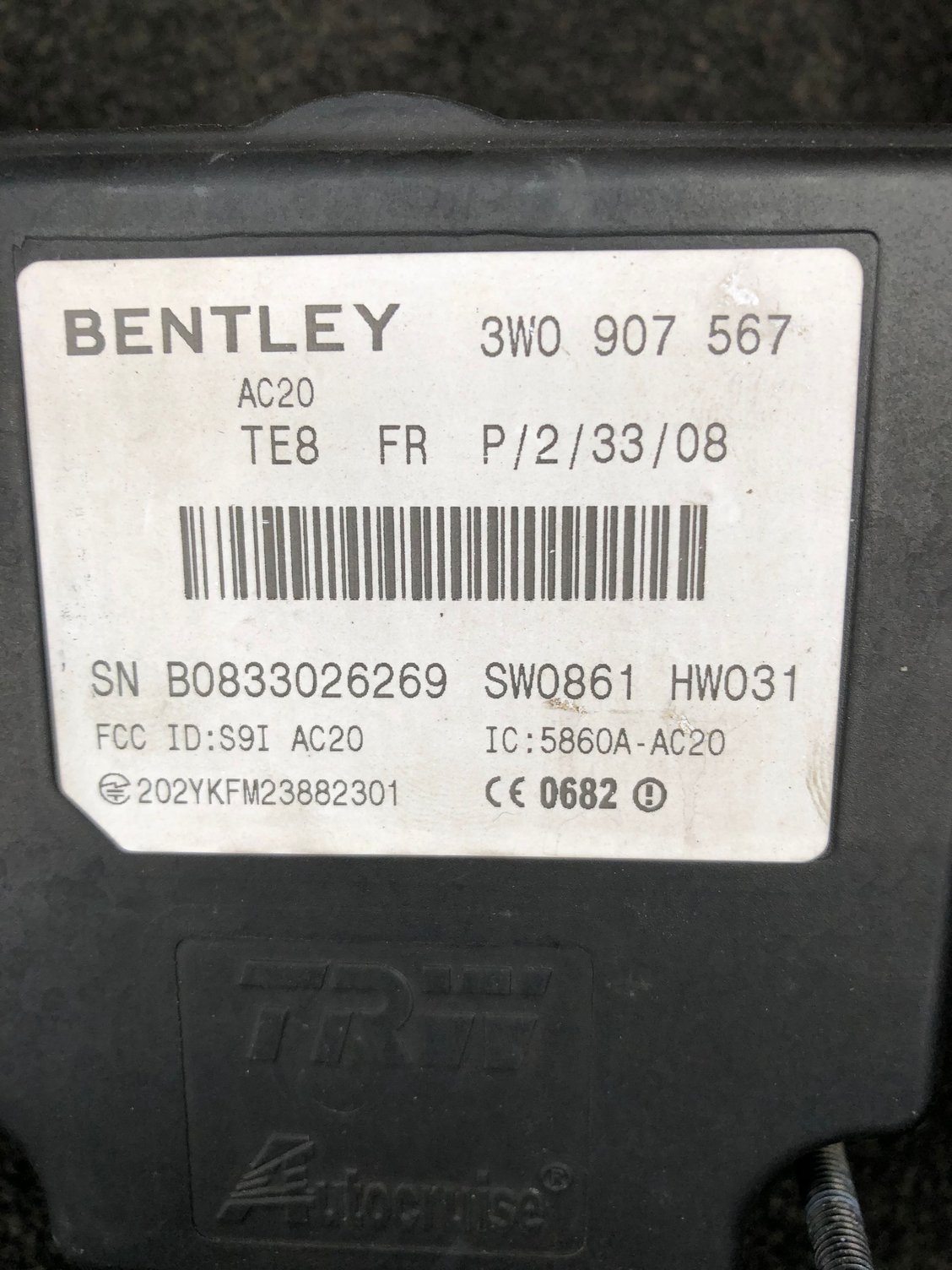

This is the original part taken out of my 09 flying spur. 3w0907567
This is the new part I got on eBay from a 2013 bentley. The part number 3w0907567B
Many thanks for the part numbers. Given that the 1st 2 characters are (I believe) manufacturer code and 3W is Bentley, any ideas if a (much cheaper) 3D0907567 from a Phaeton would be a direct fit? It looks the same in pictures?

I was going to suggest to buy the VW Phaeton radar it looks like it will work. I have bought a seat control, thrust arms, oil filters etc for a phaeton and the parts fit. Go phaeton parts and update us all.
