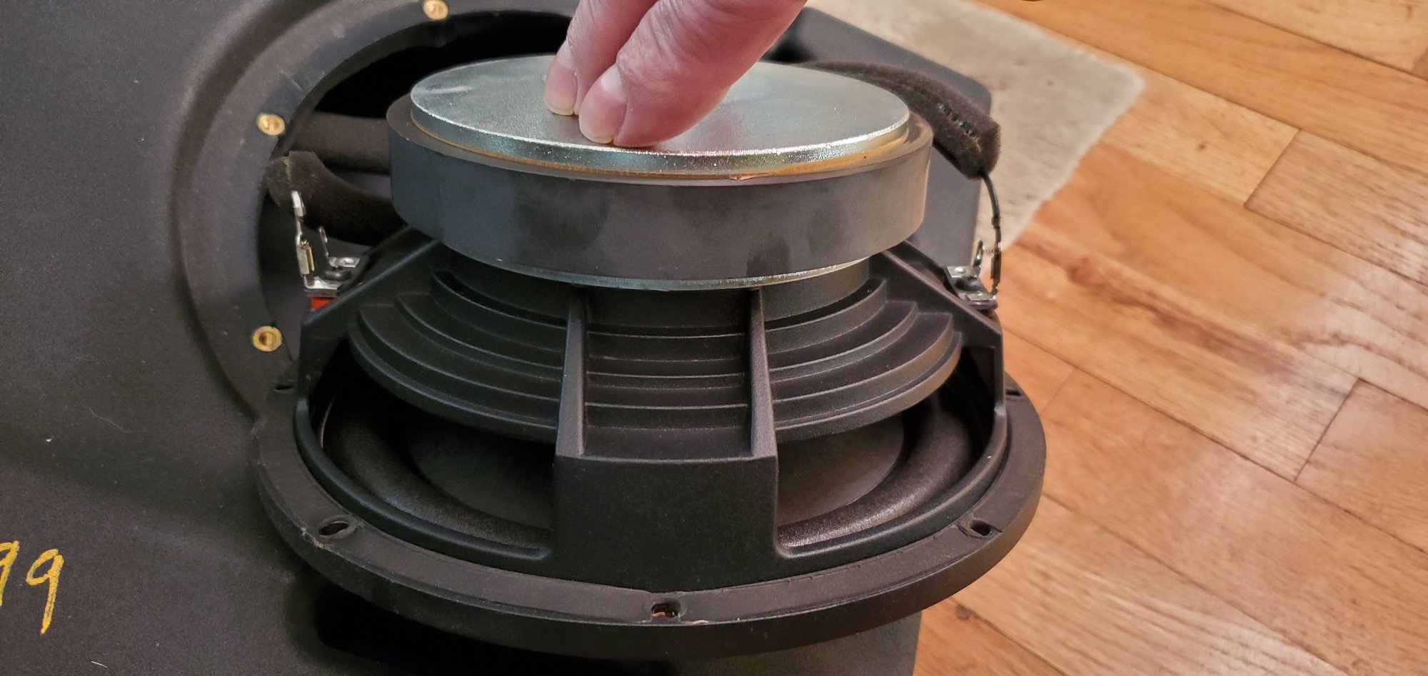

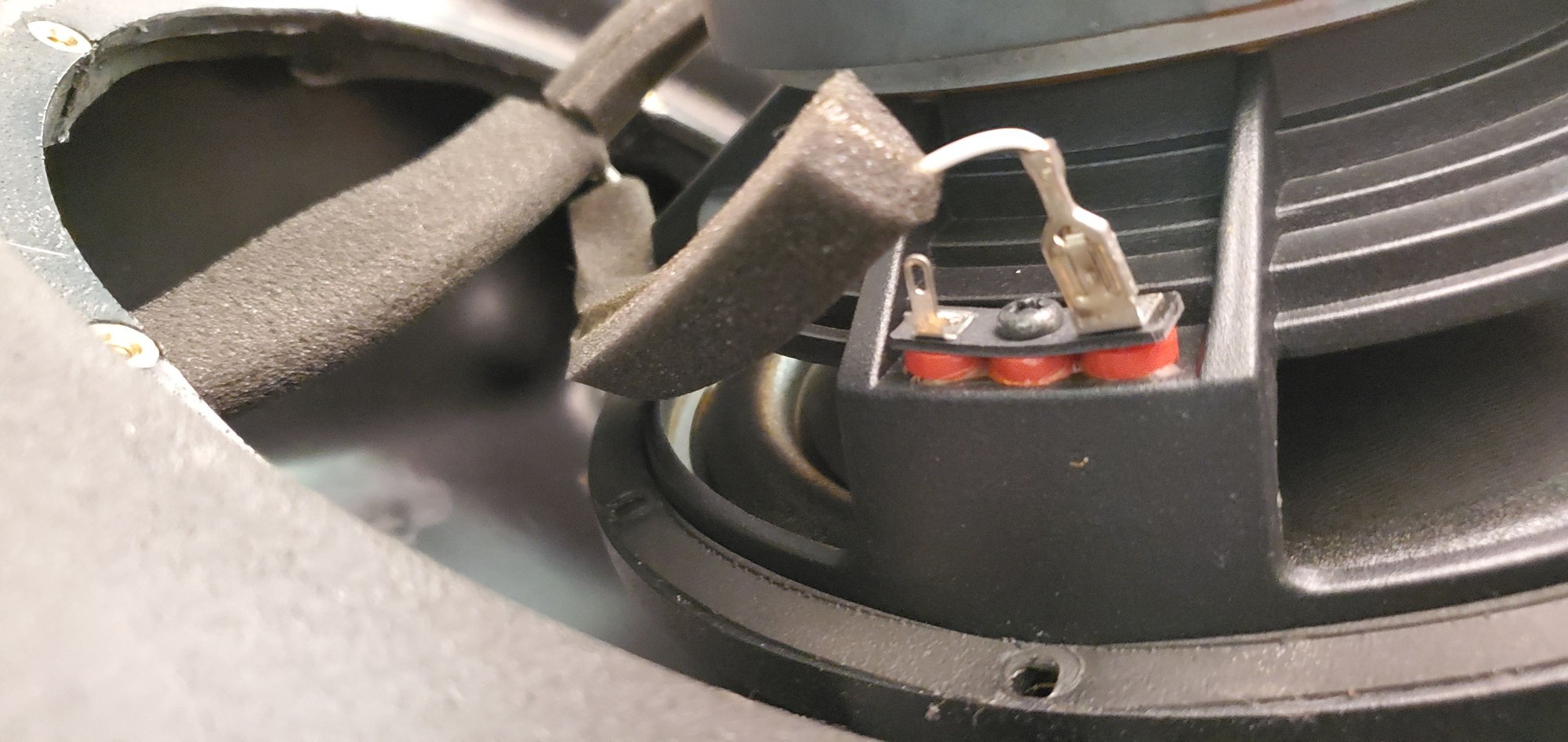

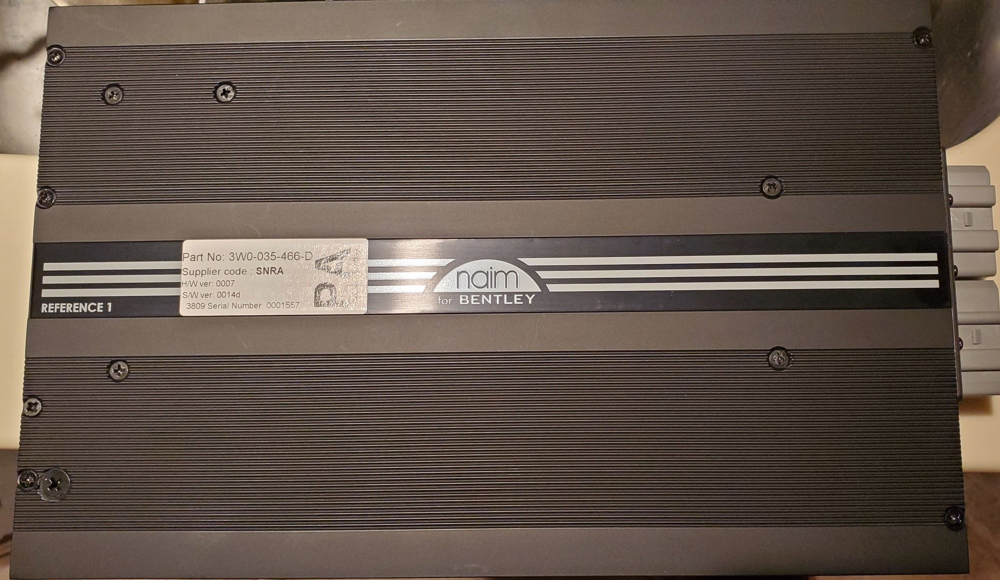

I have to add to this as I had the same feeling as to the sound after installing the NAIM sub woofer in the vehicle, I also added the (3) NAIM tweeters, but the bass was lacking compared to when I had my old Bazooka tubes in place for testing before I installed the NAIM sub system, so I double checked, triple checked, and quadruple checked my wiring, as it sounded like back in the day as when I had mistakenly wired my subs or DVC subs out of phase, in which case if some of you are not familiar with speaker wiring, if you do not keep all your +/- the same to each speaker, you will be out of phase, and with the subs out of phase you will have a lack of base, as the polarities are switched to each sub, they cancel each other out, so after all my checking to be sure that I had followed the diagram to the t, I said screw it and swapped 2 of the 4 wires feeding the NAIM sub box, and BOOM, I got bass 🔊 ...
Now this would only be for the twin sub system as in the hardtop, unless, and I have no clue at this moment, that maybe, possibly the convertible may have a DVC sub (4) wires, as it only has one in the center rear.
I am not sure if anyone was ever inside the NAIM sub box I purchased, I opened it up and all looked good, could it just be a mistake at the factory making the harness, or the box maker, just one of them getting their wires crossed 😀 🤔.
Also, the way to tell if your subs are out of phase is to turn the balance completely to the left or the right, if you get more bass when set to either side but less when centered, the subs are out of phase.

Please tell us what the bass sounds like when you turn the balance fully to the left or right, if you get more bass when set to one side, the the sub box in the trunk is wired out of phase, note, one can not wire the sub speakers inside the box itself out of phase because each sub has different size connectors for +/- on the subs themselves, I found that the wiring at the 4 pin plug feeding the sub box to be wired incorrectly, now mind you, if you read my rebuild thread you will see that I wired all of it myself, BUT, I followed the 2010 wiring diagram for the NAIM system to a tee, as I stated above, I checked my work 4 times over because of the lack of bass from the NAIM sub box itself, and by changing the balance to either side gave me the correct bass effect I decided to swap two wires, now in center balance I have much bass, to the point that I have turned down the bass in tone settings, and to prove it to myself, I put the balance back to left or right and now have less bass that way, so, it was out of phase.
So there is either an error in the diagram, or the NAIM amp maker did not follow the diagram pinout for the subs, which ever came first, or who followed who... 🤔
