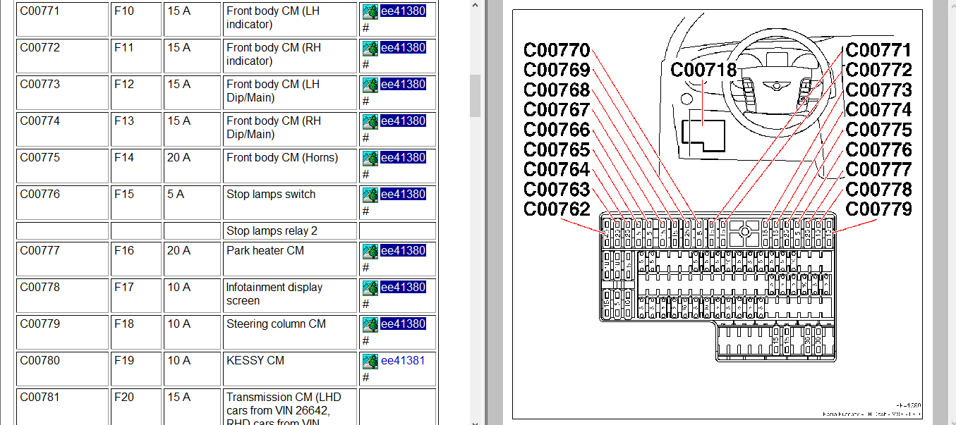

HI, Your audio amp is fuse C00762 and Infotainment display C00778

Old Jun 26, 2019 | 11:20 AM
