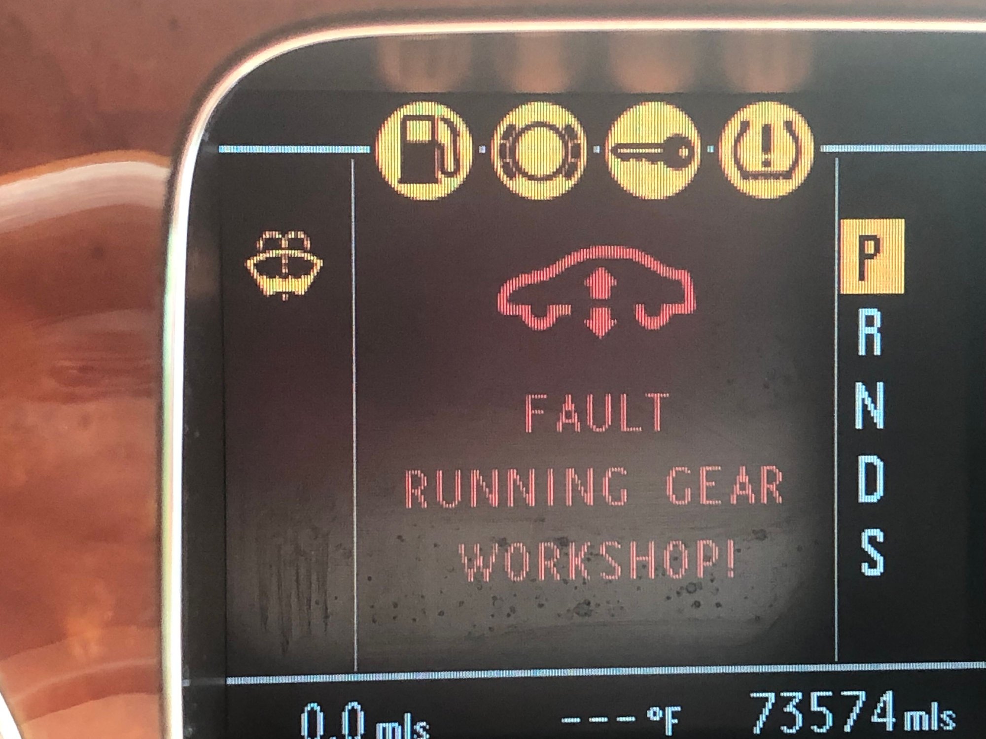

@1eapplebaum Ok I think it went into jack mode let me attach a pic. I went to the car switched on the ignition but didn’t start the car. Held those two buttons down and I think it went. It didn’t say jack mode but it did say this: Does this mean it’s in jackmode

Also the suspension height seems to be fine. It’s not sitting on the ground. I wish the car was able to drive a few yards to See what’s going on. When I turn the car on that workshop light doesn’t come on. It’s only when i hold those two buttons

I don't see the Jack mode light yet.
Feel the light for a new battery in your key fob is on the dash, you knew about that.
Looks like your tire pressure monitors are bad. That doesn't affect the operation of the car.
However the warning on the dash might not allow the car to go into Jack Mode?

The flat tire might cause the suspension to think that there is a fault.
I can't recommend jacking the car up out of Jack mode. This might be necessary otherwise the car has to be towed and put on a lift to change the tire. Always better safe than sorry.

How long are you holding it down it go into jack mode? 1eapplebaumbaum is probably right. You might need to clear those faults before you can put it into jack mode.
