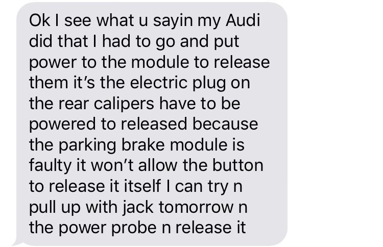

This was my mechanics response to the brake not releasing. He’s the one with the vcds scanner and sounds like he knows EXACTLY what’s to do and like he’s done it before.

That sounds like a good plan. Unfortunately the voltage surge could have,as the mechanic noted, toasted the module. Although sometimes the switch in the vehicle goes bad on its own. Looks like the car and you are on the road to recovery.

The first step is to assess what failed. There are other components other than the switch that possibly failed. The vcds scan would indicate trouble codes that would help assess this. Without properly fixing the system there would be the P sign with a slash through it.

You're hearing the servo which is the activating motor on the emergency brake. Something is malfunctioning and that is why it isn't releasing. Until the mechanic looks at it not much more to do.
