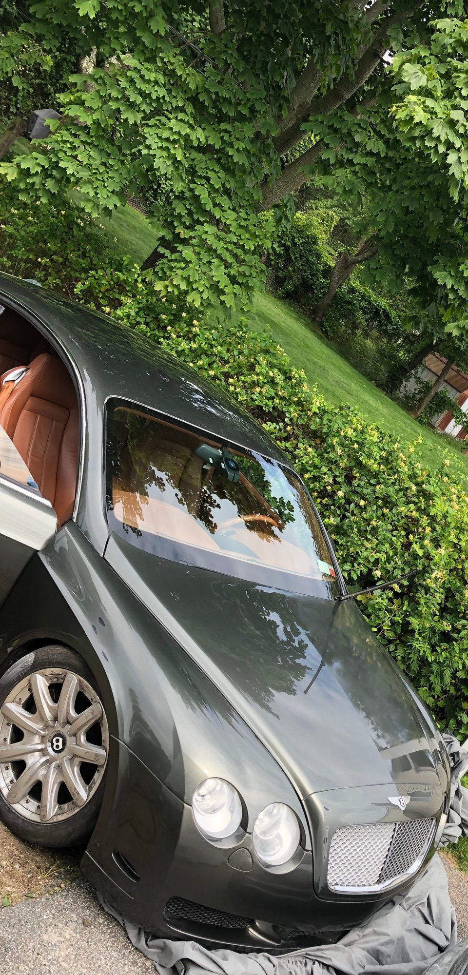

This is when I was saying the suspension was completely on the ground. But it lifted once I changed the buss bar and the 80 amp on the driver side battery.
Nice 👍🏾..same color as mines. I hope you get it up and running soon. When you do, have the vacuum lines checked for leaks via a smoke test. The early years had an issue with them.
