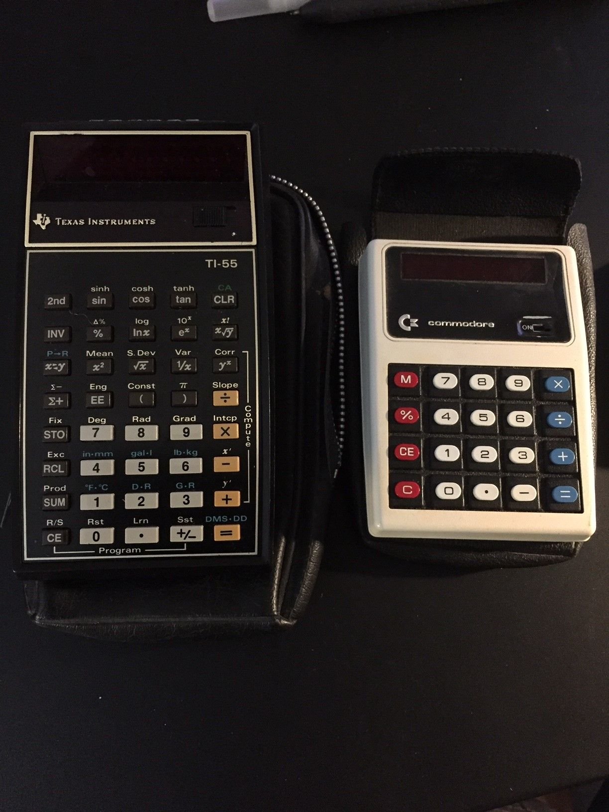

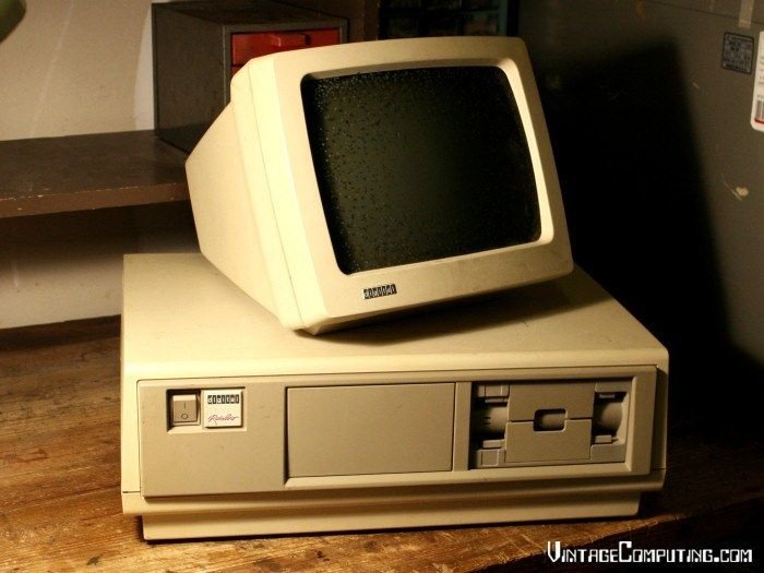

Ha...Beautiful! Thanks for posting that! I was Senior Manufacturing Engineer on Digital Equipment's first (and only) attempt at a PC. Called the DEC Rainbow (how embarrassing)!
Here are a couple more relics. I went through Engineering School with that monster TI on the left. And, of course, my first calculator a Commadore. Funny that a lot of engineering students in my day were still using slide rules.....good for them! Others of us were bleeding edge with TI-55s.
I use a Bosch 4.9 (packaged in any mfgr's controller) as the only retail WB I'd use. I know what you were up against trying to use O2 sensor voltage to try to arrive at some rudimentary form of AFR, but man! That is really "hammer and chisel"...LOL...O2 (narrowbands) are painfully slow switchers and it's like trying to hit a pinata with a blindfold on...haha...
Lots of EMSs use calculated data as outputs which should not even exist for all practicality as they are ridiculously inaccurate.
I'm very much enjoying these conversations! Good to connect with someone out there that's been around!
That is amazing, haven't seen those for a very long time ... nice one Sir ...
Thank you Mr. Rico! I cannot believe I keep some of this junk around.

Great stuff Bwings and likewise it's been very nice chatting.
That commodore looks like an LED display, very nice. And you've still got the original cases!
