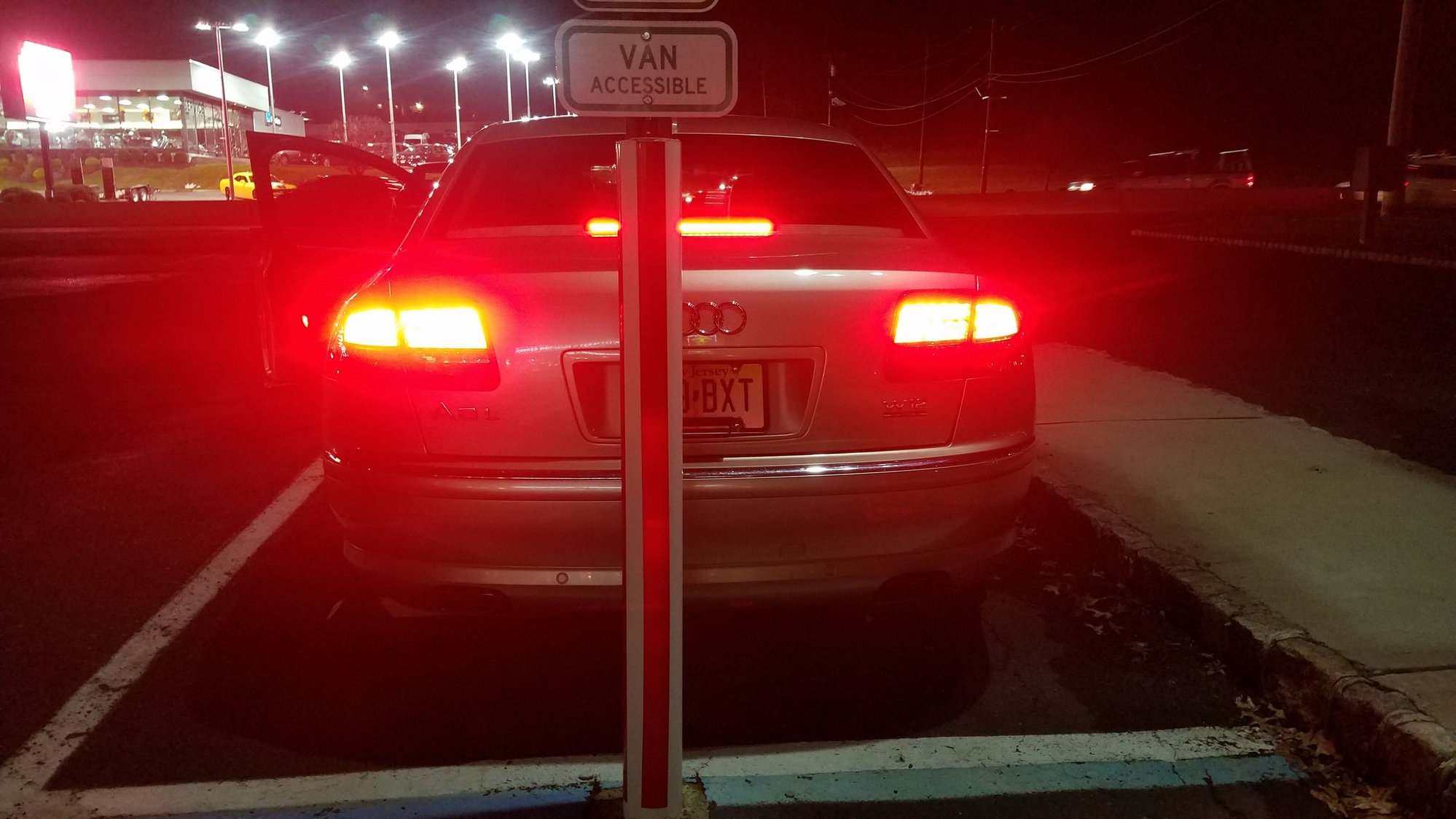

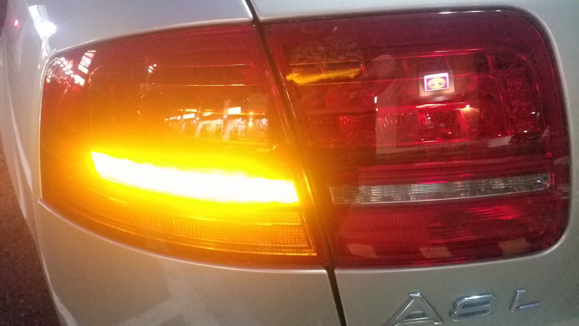

Then you would not need to add anything to fool the system, you need to find the issue causing the error message.
Please post some pictures if you would showing each of the tail light components lit one at a time, then all together, this will help all to see if there is an issue you are missing, so first just parking lights, brake lights, turn signals, hazards, and fog lights, then every thing all together like I did here with my A8L W12 new tail lights, turned out to be a corroded pin connector.
Also if you clear any faults, when does the message come about, when you hit the brake, use turn signal, turn on the parking lights, or fogs ?
