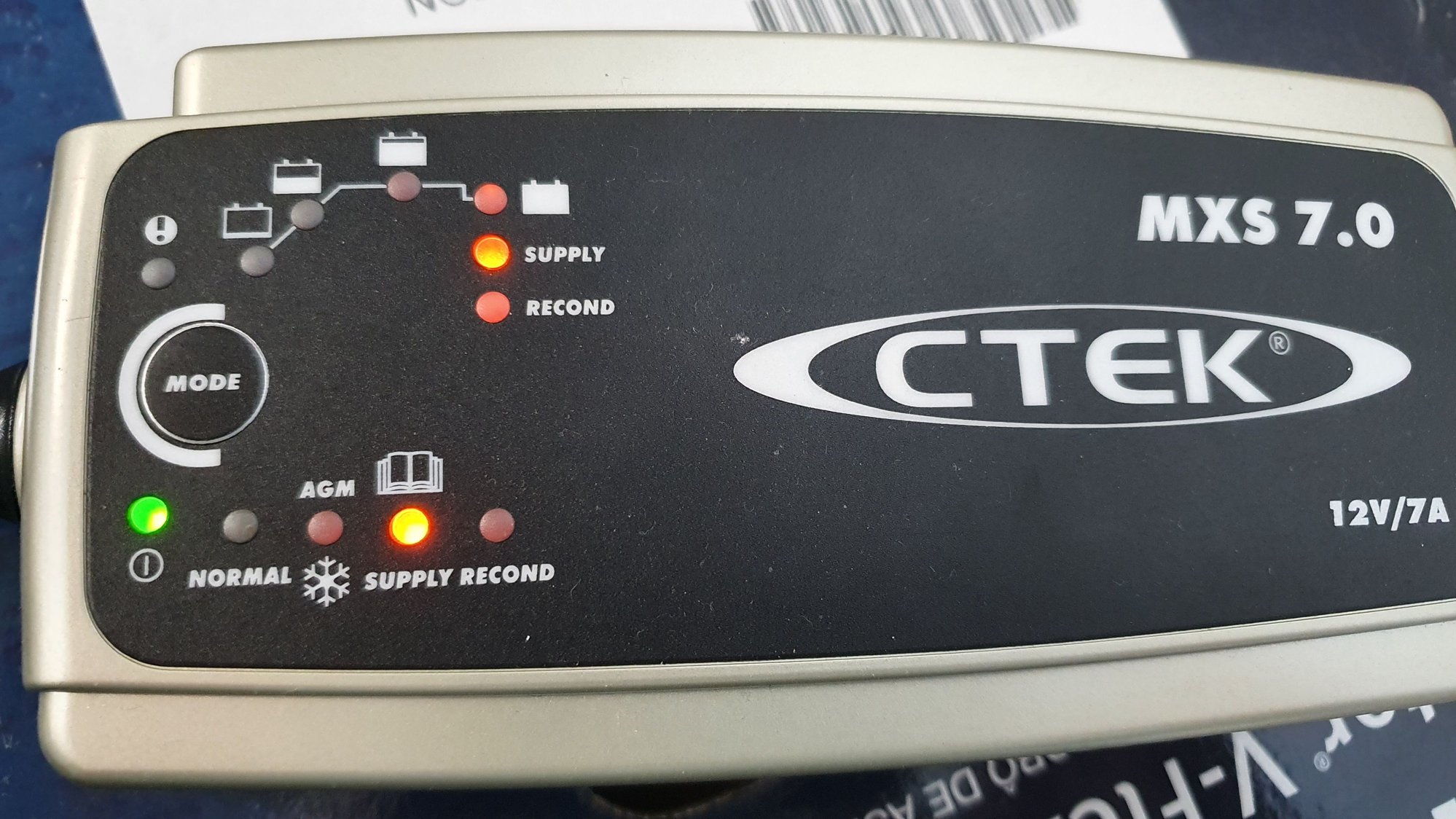

Good morning from Spain colleagues. I'm a bit worried with my GT Speed ​​because I want to take a trip around this time and I don't know if I have to change the battery in my car. I have to say that everything works, so far correctly and is continuously undergoing maintenance with ctek charger but I do not know how to interpret what the charger tells me and also I get the battery symbol on the dashboard in red, I do not know if when the battery This new one usually appears in green since I bought the car used a year ago and I never noticed.
Can you guide me or tell me something if I have to worry? I have to say that a few weeks ago I went with the same question to a workshop that fixes other cars for me and they told me that the voltage of this one appeared correctly.

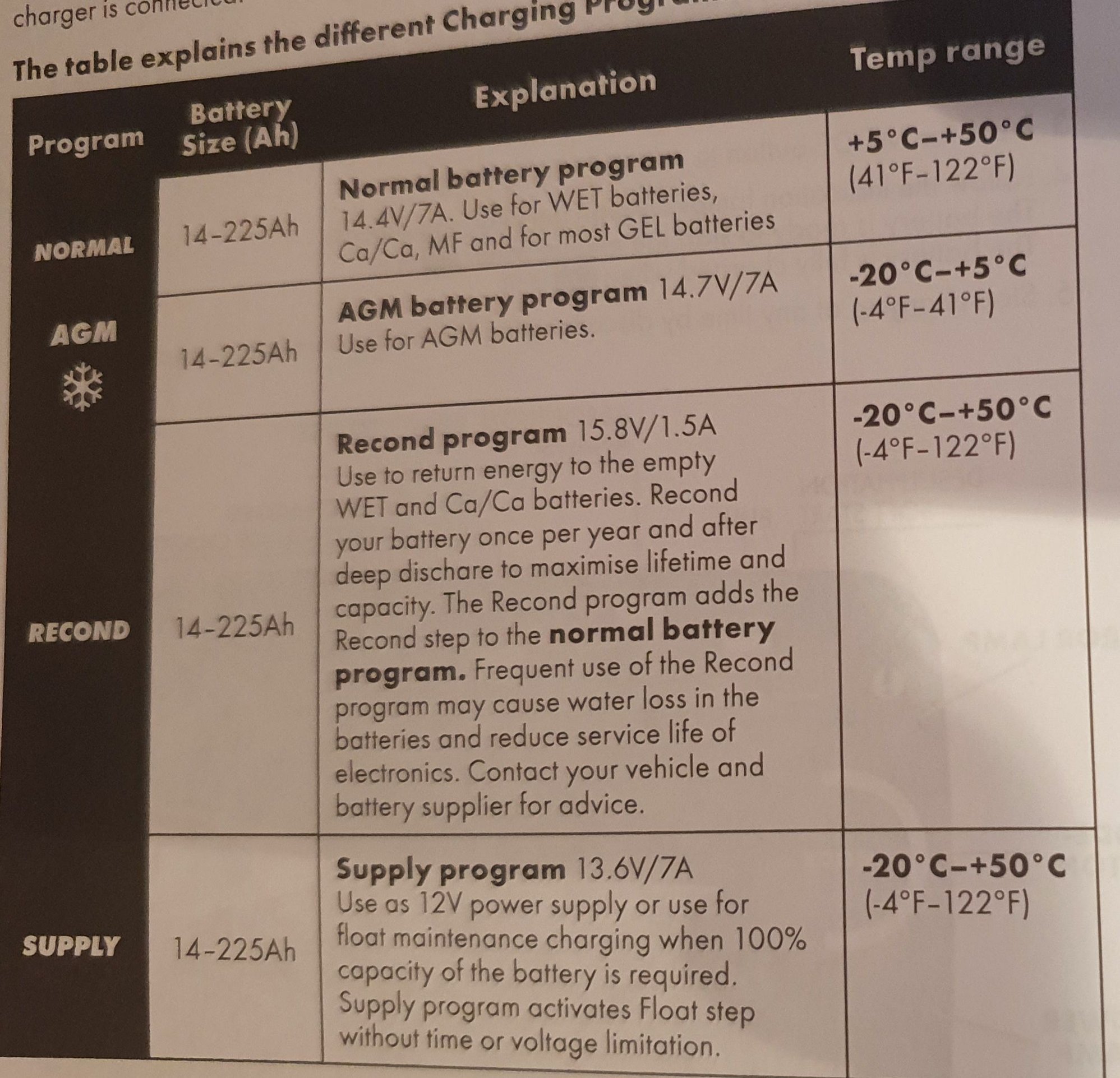

But, what I see as far as your CTEK setting, it is wrong, you have it on "SUPPLY" as per your picture, it should be set on normal, amg/snowflake, or recond, not supply, as supply gives straight power with no variation and would cook the battery over time, supply is only used when switching out a battery if you choose to use it, or when you have a dead or no battery in place and you want to power up some minor accessories.

Regarding Ctek, as I see in the instructions I interpreted that Supply is a maintenance load, like what is usually seen in car dealerships, or that is what I intended. Have it continuously connected to the current and from time to time it just keeps itself. My battery has not been empty at any time that I know of to put it in Recond mode.

For your C-Tek: Press 'Mode' until the light below AGM is lit and you'll be good. Well much better than you are now.

Thank You!! Can I have It plugged for weeks without a problem?
