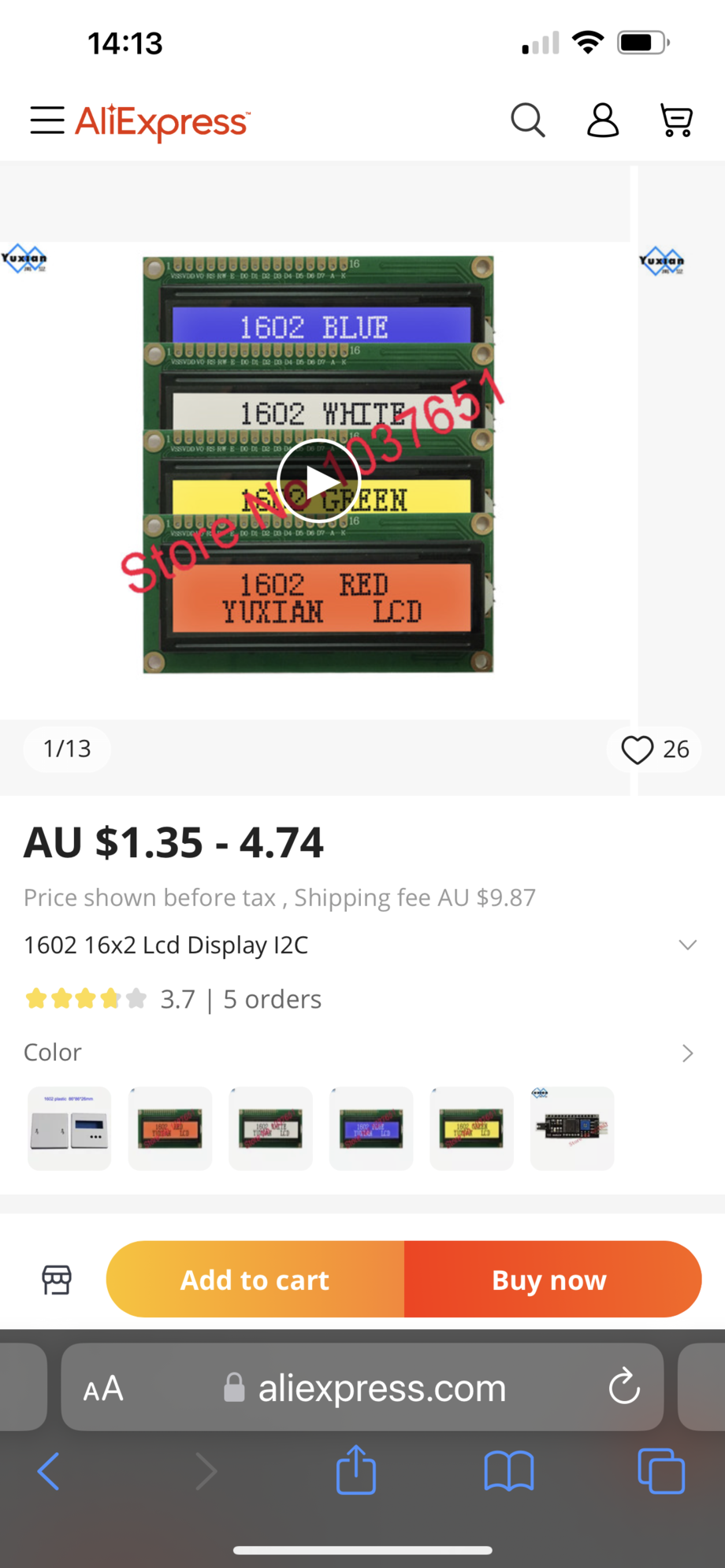

the Ben hur system has a $2 16 x 2 LCD screen. It’s Just nasty and I couldn’t justify the total unit cost based on this

Is that Alibaba link an exact fit or are you just using it as an example? How hard are they to swap
Old Oct 29, 2022 | 10:25 PM
iSteve's Avatar
Joined: Feb 2022
Posts: 19
iSteve is infamous around these parts
Just a link to show the value.
the screen itself might have data lines, I2C or serial interface.
need to see the back of it
