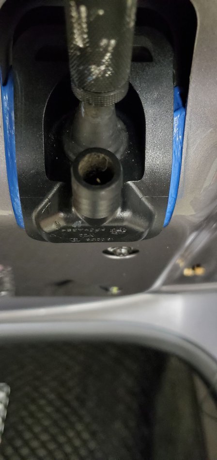

Being that you have water coming out of each drain across the bumper, I would say the each hose/tube is connected to the black plastic funnels on each side of the bootlid spoiler area, one or both my be split as mentioned, BUT, I think the issue may be the black plastic funnels themselves, as I had the same situation, but mine didn't start to leak into the boot until after I had the spoiler cable fasteners issue, which in turn broke the clips on the top of the right side funnel, my drain tubes were intact and clear, as I had removed the complete spoiler assembly and drain tubes during my rebuild to clean all the areas and drains, when the spoiler cable retainers let loose, I did the repair (2 hose clamps and a piece of rod) found here on 6Speed by @flyc2c , but also saw that the bottom of the right side funnel was sticking out further than the left, so much, that I could see the white gasket/seal not seated, and also signs on the inner side of the bootlid carpet/cardboard of water, I am not sure how with the angle of the bootlid, but it was like the water that leaked from the funnel, was trapped on top of the carpet, then when the bootlid was lifted, the water came out between the carpet and the lid, not out of the spoiler and onto the rear glass.
I used the blue sealant as shown to put the funnel back in place, I did place foil tape over the funnel to hold it in place while the sealant cured, then gently removed the tape while holding said funnel in place.
See pics.

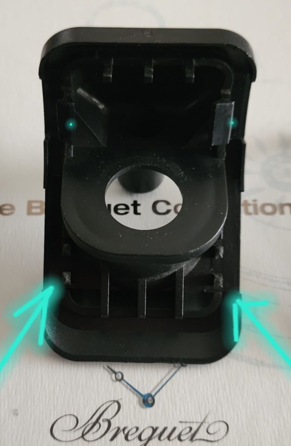

I removed the boot liner and as far as I can see, the drain hoses look in good condition. Both funnels looked iffy; the left hand one had been bodged with some kind of hard glue and on the right the white gasket was visible but also looked discontinuous. I used black Sikaflex-522 adhesive/sealant around the edges of both funnels. My attempts were slightly less tidy than Johnny's
It will take 24-48 hours for the Sikaflex to cure, at which point I can try drenching the area again and see what happens.
Bentley Continental GT 2004 LH Boot Drainage Funnel
Bentley Continental GT 2004 RH Boot Drainage Funnel
