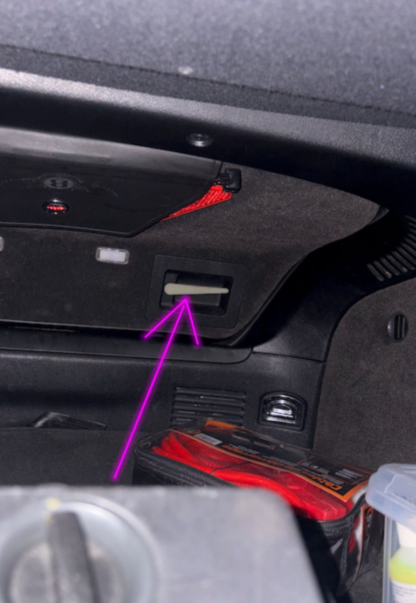

My boot closure had been playing up, but now just flashes when I try to use the key fob...... and door panel switch on drivers side does nothing either, neither does the B switch on Boot lid. Goosed basically!! Luckily I have nothing needed in the boot.
So I have looked at a few threads on here and nothing seems to work, and I thought I'd follow the things mentioned by some other users, but I can't seem to see the electrical button inside the boot only a lever when looking through the ski hatch. Is that the only way to open the boot from inside the boot? I thought I'd try a fuse check but someone said its also in the boot....clever design that! I was trying to eliminate a jam, an electrical fault before assuming its the mechanism drive thats failed requiring parts and a garage visit.
I also thought maybe to take the rear seat on left side looking out the back, but unsure how you take it off, is it the side panel first? See pic attached. Any insight much appreciated.

Hello @CUE99T ,
Is there any warning on the instrument cluster display in regards to the boot lid being open, hence the release wouldn't work if it thinks it's open, if so, try pressing down on the lid while pressing buttons for release, I remember where a member here had her girlfriend sit on the lid and bounce, actually, I think they both sat and bounced on it, it opened.
Yes, the fuse for bootlid release is in the boot, brilliant, I know.
Do you have Ross-Tech VCDS, under #46 (iirc) Central Convenience, you should be able to activate the boot release.
The escape lever in the boot as shown, is an electrical (microswitch) switch mounted to the lever, therefore if an electrical fault happens, this lever is useless, such as a dead battery, or other electrical power fault, some say, but I think it was a Flying Spur, that the newer years have this escape lever as a direct cable, so no longer a microswitch setup, not sure what your year is, but the 2005, 06, and 07 units I had, were all microswitch setups, worth a try for you with a broomstick.
The emergency release lever behind the seat is 100 % manual, and a direct connection via cable to the lock/latch mechanism lever.
To get to this lever, you pull the lower portion of the seat up, put your finger at the face of the seat by the floor carpet, then lift and remove, then you will see the torx bolt at the bottom center of the upper portion of the seat, after removing the torx bolt, the seat will slide down and out, now you have access to the emergency release lever.
No side panel removal necessary.

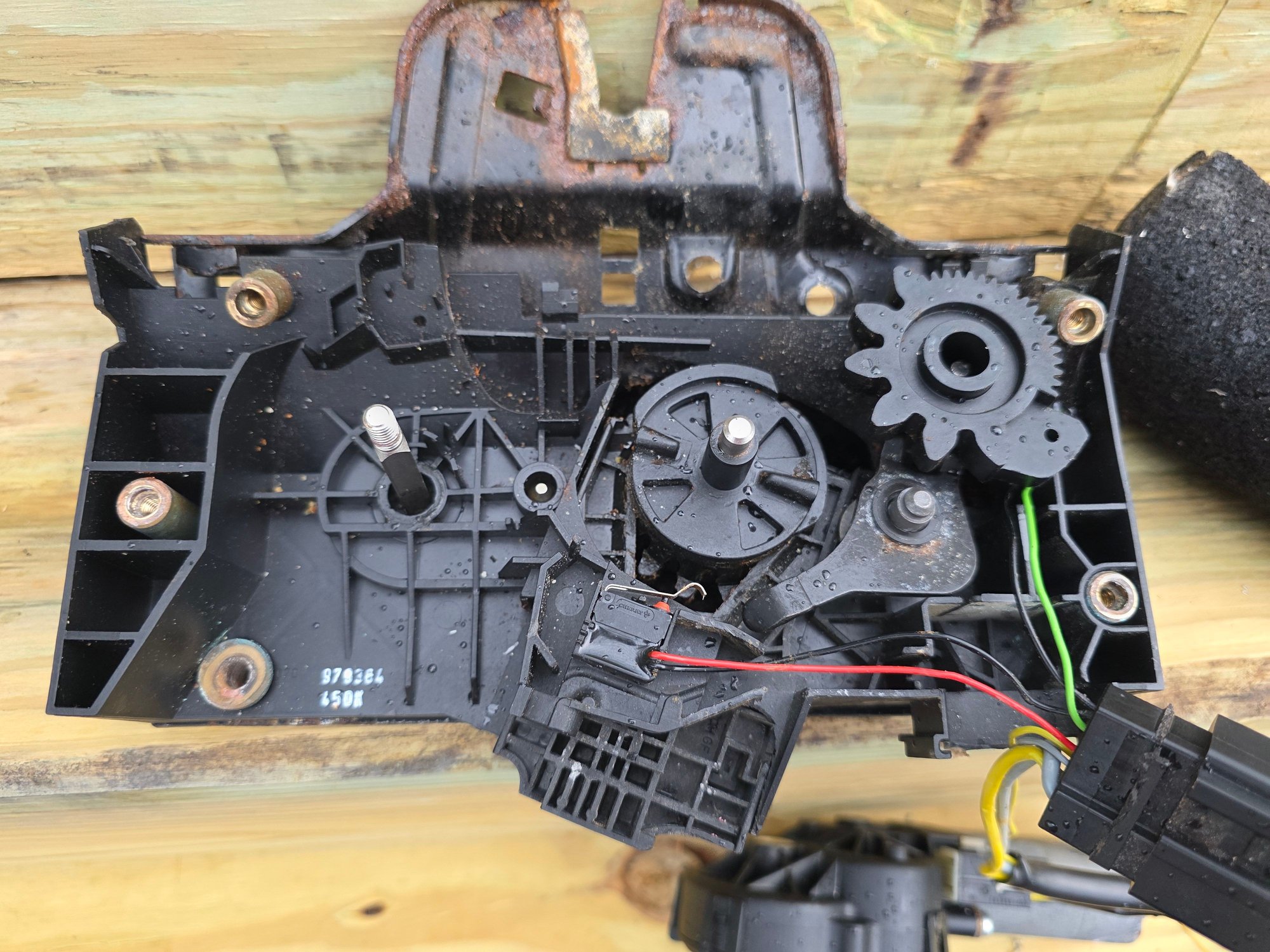

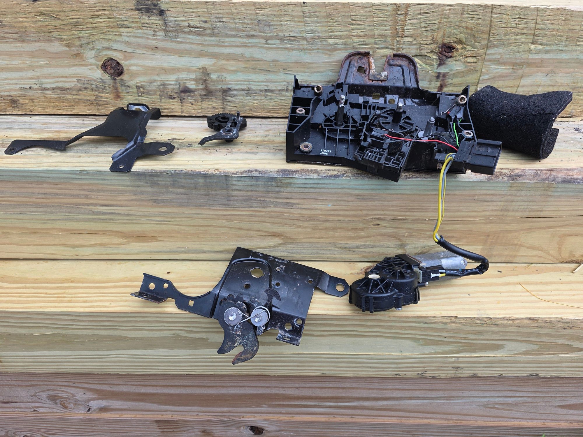

Just for clarification, does your 2004 have power lift and close, or just power latch, meaning, you have to physically lift the bootlid by hand to the fully open position, and the same for lowering it.

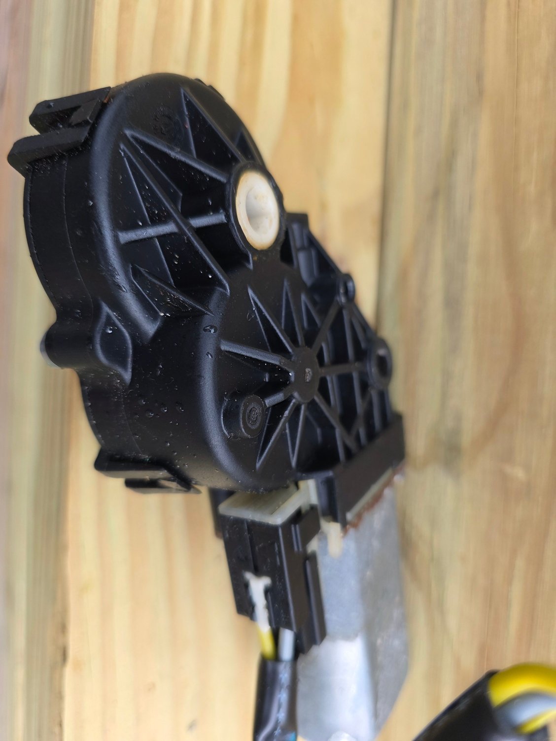

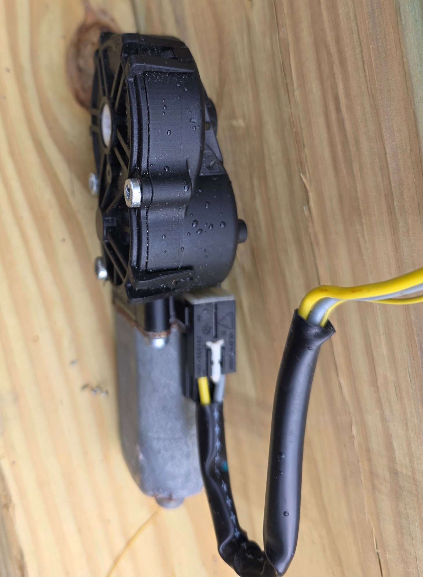

If no power lift on your 04, then you most likely would have the striker piece I show in my video from the 05 without power lift, it's the piece I show on the shelf, it has 2 connectors to plug in, it has what is either a motor or solenoid to the right that moves a rod, the other connection I believe is a microswitch, I can check tomorrow to be sure, so your issue could be in this striker piece, if you have it.
The other issue could be the power latch itself, I have one in front of me right now, and the only thing it appears to do is, is to pull the latch in further after initial close, just like the soft close doors do, this power latch assembly is really not a serviceable piece, well, except maybe for the motor and the gear mechanism the motor drives, as I was able to remove said motor and gearbox that slides over the square drive shaft, the housing will not split in two as it appears it should, I removed all 9 bolts, the are 2 hammered fasteners that would have to be ground off the split the housing, and the only reason why I would want to split the housing is, I believe that there are 2 microswitches inside said housing assembly, as the connector on this piece has 8 wires, 2 large, and 6 smaller in gauge, the 2 large and 2 of the small go to the motor, the other 4 small ones go inside where I can not see, but I am thinking to microswitches, and any of these switches could be the problem.
I may go drill those two fasteners to split the housing.

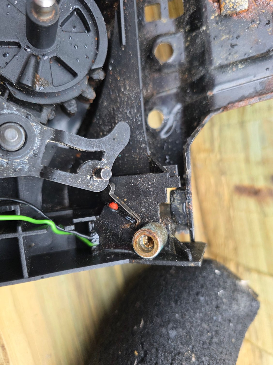

EDIT:
I drilled the two pins, took every bit of 3 minutes, I just had to know if there were microswitches in there, there are 2.
But, once the pins are drilled, the unit is pretty much, unless, maybe just grinding the heads off may lead to reuse, BUT BEWARE, when you open it, springs, gears, and a lever come falling out, I figured how to put it back together, but mine is trash, I just kept it for learning the innards one day, now it can go to the scrapyard.

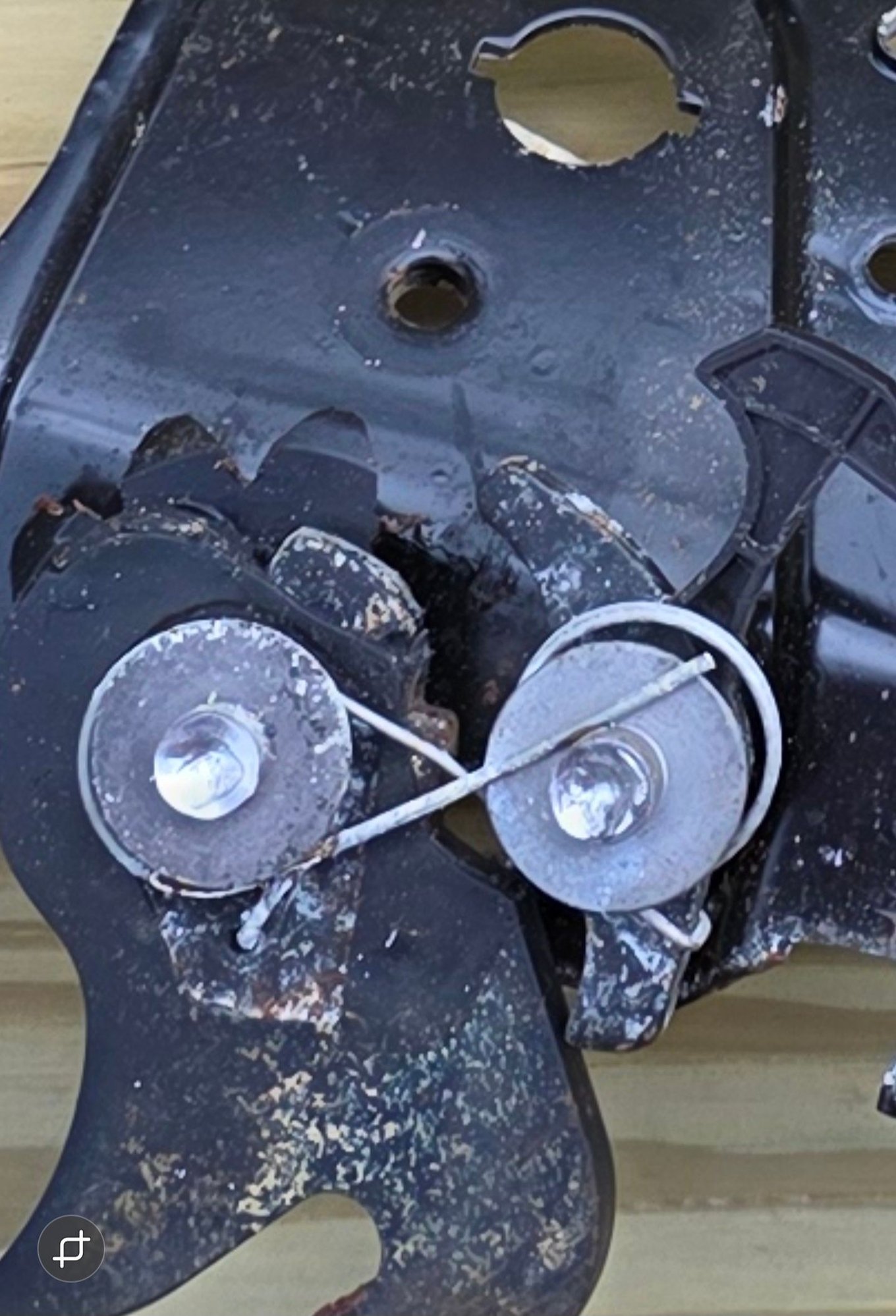

Looks like I maybe need a new top latch then. For me thats the bit that isn't catching. I can manually do it when its fully open with a push of the top part in my pic but then the bootlid won't close at all as the lock catch is rotated round into the lock position..

And @Johnny Hotspur GT so you know, the weird thing is my striker doesn't flip down either side of the middle cross bolt....it pushed down on the left and its like its fully one big plate when pushed .... will try and video it.......
its probaly why your power lift and close cycled up and down and up and down as the striker has different top latched bits......
