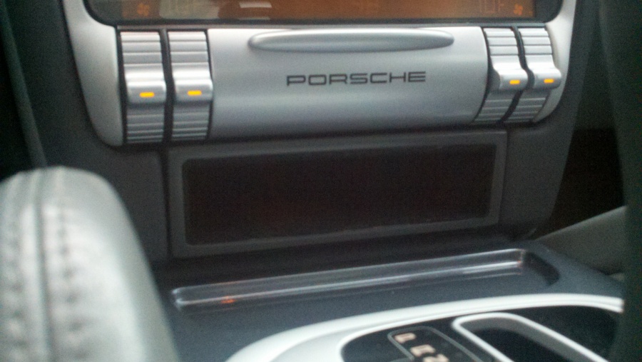

sorry to bring up this old thread, but the same thing happened to me unfortunately,, managed to drop a quarter behind the tray and the sliding tray got stuck when I closed it, once I tried to open it, it won't open, had to tap the side to pop it out.
I wonder if I can park my Cayenne on uphill and tap the side to see whether the coin would slide out or not, no need to save a quarter but just want it to be outta the way... anyone got a picture of the tray structure?

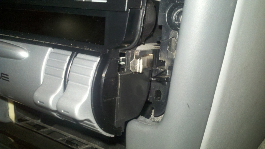

Maybe this will help you to figure out where the clips are. Mine is from an '05 CTT so I'm not sure if yours would be different. Good luck!

thanks for the pics, mine had a dime in it

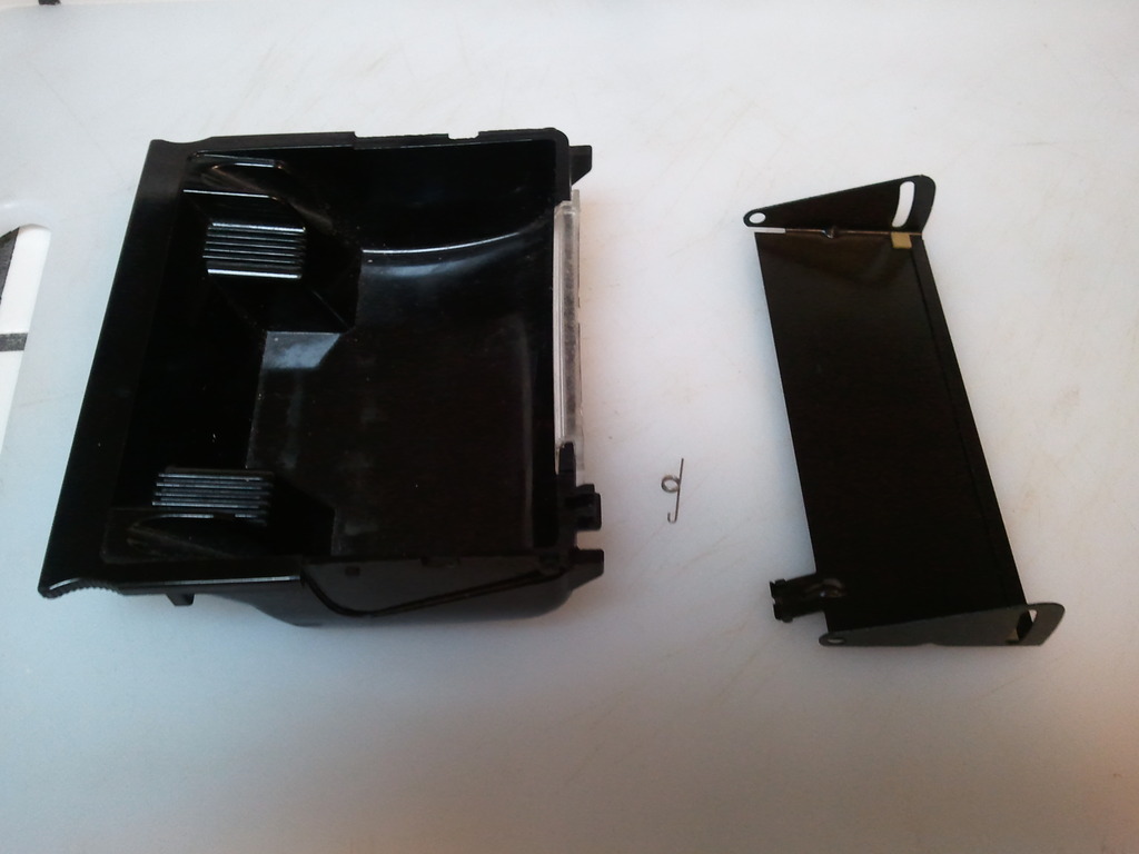

Cigarette Socket No Longer Pops-up....
I need to do this too. Anybody know how to re-assemble the ashtray insert? I have no idea how the spring(center) is oriented:
