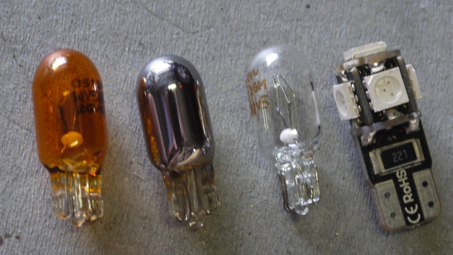

For the sidemarkers, you can't just go straight LED since it will trigger faults messages.
Here's a discussion about the side markers and some bulbs we used.
https://www.6speedonline.com/forums/...demarkers.html

for the license plate and side markers i used aznoptics LEDs (the link is in the "clear marker" thread above). i used the white bulbs for the license plate lights and the amber for the side markers, with just a bulb swap, and no error lights on the 2013 CTT.

theres led bulbs for the sidemarkers that wont trip the error light, the connector part looks like a board/chip. and they work error free, however they dont seem to last very long. i had some i put in and in 3-4 months the bulbs started to flicker and some of the leds went out. and still didnt give me an error on the dash, i just took them out and put back in stock amber ones.
