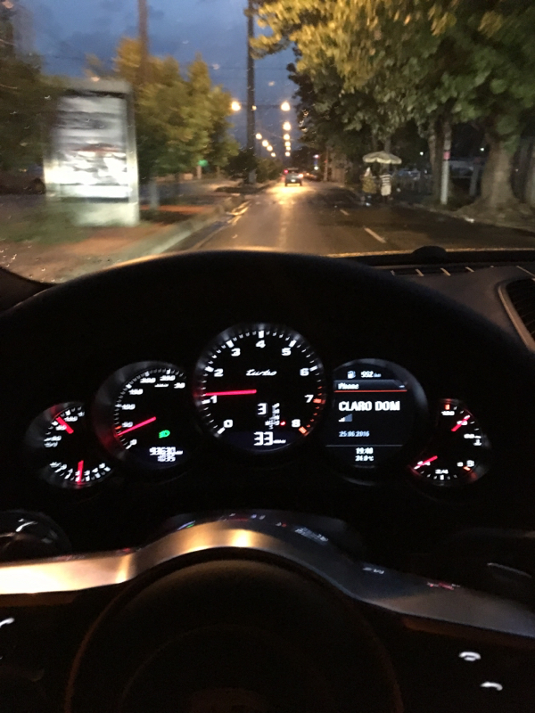

Still no PSM today
Old Jun 26, 2016 | 12:59 AM
  #140
Gtrust's Avatar
Joined: Apr 2016
Posts: 39
From: London
Rep Power: 12
Gtrust is infamous around these parts
Great to hear, I can cope with the occasional PMS fault as long as it doesn't need a PIWIS reset

Originally Posted by amablemiguel
Still no PSM today
Good! So now do you have it with the old clockspring?

now champagne!!

jejejeje will let you know soon when I turn it on today if there is PSM... Still no battery change and no rear sensors replaced...
Nope that's the 15-16 clockspring and rear unit (levers). The old clockspring will not work with the new steering wheel. You'll just have a working wheel with paddle shifters and no MF at all , plus a christmas tree on the dash (PSM, Auto Start/Stop, Etc.. Etc..).
