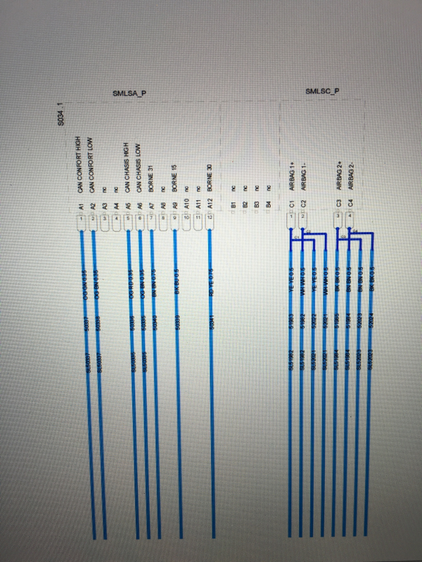

Originally Posted by amablemiguel
With my tech bailing out I'm going to do it myself and then get it coded. The only information I'm missing is the first half of the 2015 wiring for the large plug, any chance you have the rest of that picture?
I'm out of town for the weekend but I'll get it for you.

Gtrust, I have one in Russian, but I think it's easy to define the wiring even without the proper description, at least until you get the English version.
Please note that on pre-restyle cars there is no wire to be connected to point A5 (Cruise control main switch). I just left it empty, but still all functions work normally.

Originally Posted by NN.
Gtrust, I have one in Russian, but I think it's easy to define the wiring even without the proper description, at least until you get the English version. Please note that on pre-restyle cars there is no wire to be connected to point A5 (Cruise control main switch). I just left it empty, but still all functions work normally.
also correct.

Thanks very much, just need to order a tool to repin the plugs. Might end up buying a PIWIS 2 at this rate!
