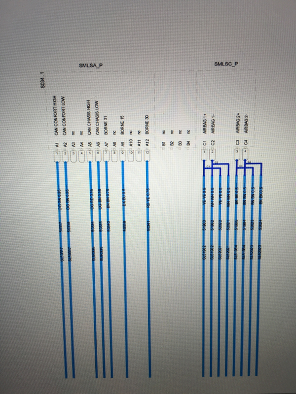

here, you'll be surprise. A guy bought a 458 and turned it over then got a 991 turbo s cabrio and crashed it the 3rd day.. Lots of lame drivers. No I haven't try yet but I have some pictures I took... Wait let me post

I suggest getting it from the PIWIS unit. I was told that it's printable but my tech does not have it linked to a printer and for the moment he can't provide me the schematics.
Reply
May 21, 2016 | 03:54 PM
  #82
try to google like I told you, you will have own program

That's great. Is the first picture the 2015? The second one has cut off the start of the wiring diagram
Reply
May 22, 2016 | 02:20 AM
  #86
My mistake, looks like the top one is 12 pins so is the old plug. If you could expand these one screen shot of the 16 pin plug that would give me everything I need I think

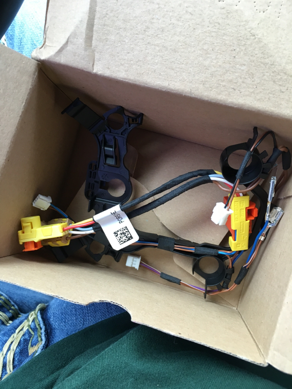

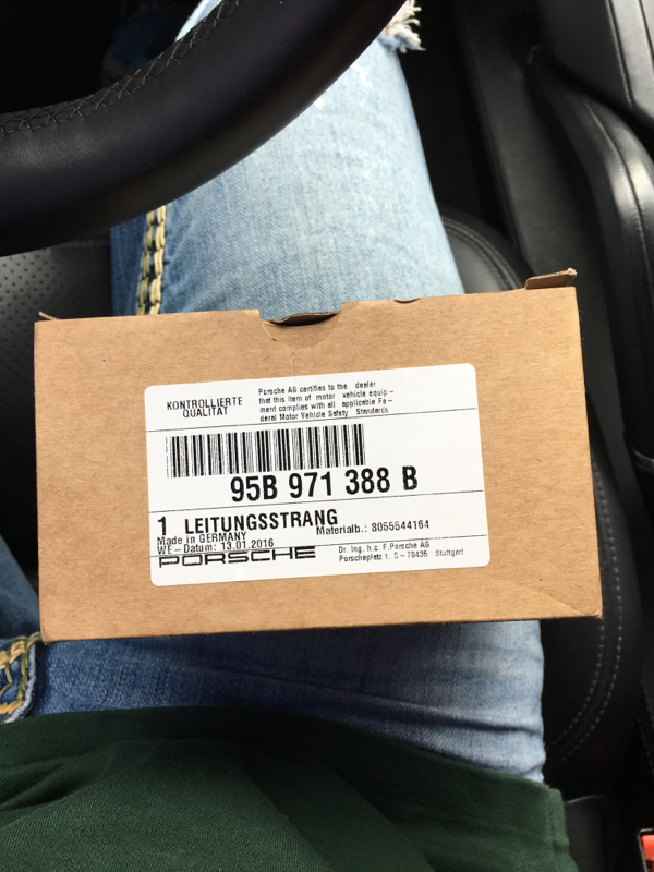

OK just got my new steering cable. The mod is now complete. I just need to install this and go get my airbag light resettled. This concludes this thread.
