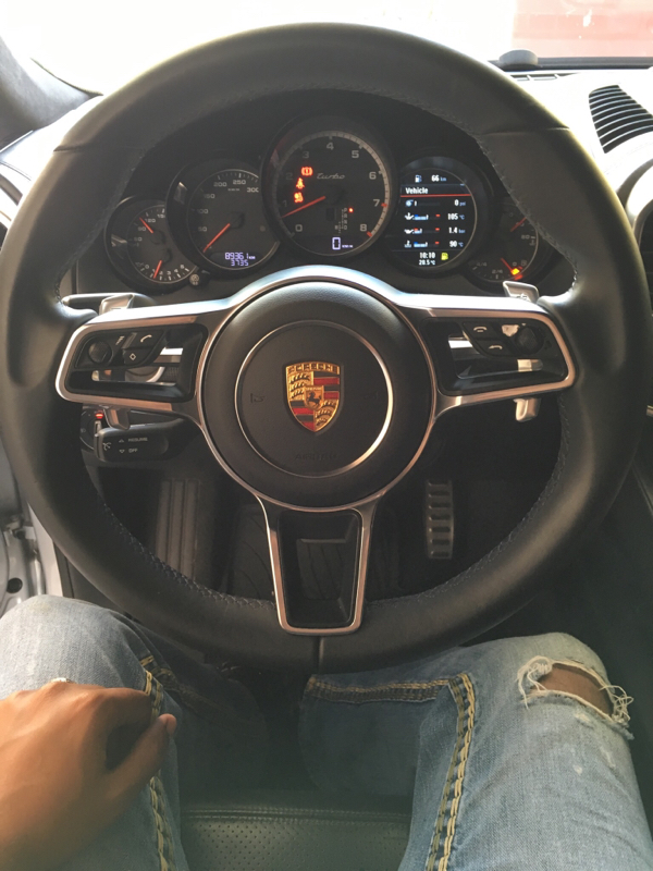

Sure. I know it's the sensors because they come on when I start the Cayenne and go off sometimes when I roll about 500 meters or so. Sometimes it stays on.

Not that I couldn't buy a heated wheel, the old wheel was a heated one. I just never used that function. The 2015-16 MF wheel I have is not new, got it for $150 from a crashed 2015 Cayenne with the levers and Clockspring. Sadly the Clockspring did not communicate while programming because it seems that the crash somehow broke something and had to get another one which I got it for free and came from a crashed macan so we just swapped parts. That fixed it for me. I just had to spend $150 on the wheel and 900 on a new airbag on eBay. That was all. I recommend you guys first check if you can get a wheel from a crashed car you'll save a lot.

hey Airbus Driver how are you? As I posted before I got mine from a salvage 2015. Not perfect, mine has a left button piece broken and right scroll wheel cover missing but is where you can start since is not a cheap wheel. I will buy the new buttons later. They cost about $220-240 the pair. Also check on eBay I saw a couple in good price. Remember you'll need a new airbag also. Mine I got it on eBay new for 900 which is way less that's its retail price. You can either get the 2014-15-16 Macan, 15-16 cayenne airbag, they'll fit.

Ya, i checked on ebay, the CF wheel is fatastic but aint cheap plus airbag itself is 1000 plus. So your wheel is working perfectly, no issue/warning lights at all ?

lucky you. Search this Ebay listing (162107939092) is the exact wheel I have. He says it has an imperfection on the leather but I saw the picture and is barely noticeable. This is better than mine. Everything is fine, IT EVEN HAS HEATED FUNCTION. You'll need the new airbag, a new clockspring, the 2 plugs, a pin removal tool and take it to the dealer for programming. That's all and you're all set.

to be honest I had the carbon steering and I don't miss it. Is nice looking but it's slippery on wet/sweaty hands on a hot day. I love the all leather wheel. Better grip and thicker. And no, no lights related to the wheel.
