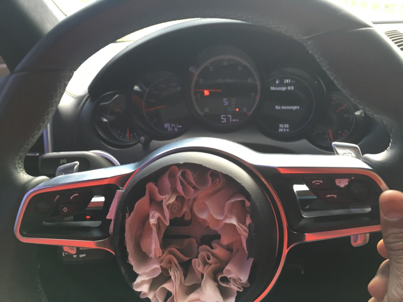

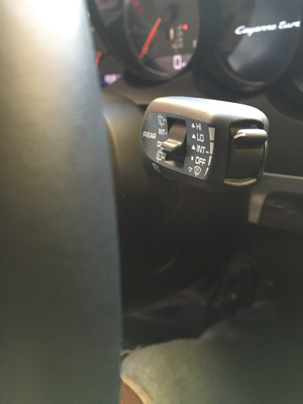

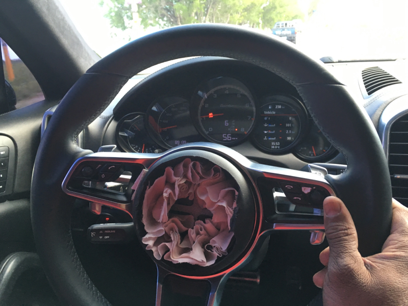

Originally Posted by Serg124
absolutely. never understanded this adapter ideas... when it will be needed and what for? Miguel, thank you on high beam tip! is everything OK with errors, none apperared again?
Serg how are you my friend.. Yes.. On the highway back home right now... Just airbag light. Yesterday I had PSM on but I figured out it was the old steering cable that was causing the issue since I left it with a broken connector hanging. Already fixed it and light went off as soon as I restarted the cayenne. Remember, my wheel came off a crashed 2015 Cayenne that's why I don't have the airbag yet but it already arrived at home.. Just waiting for the new steering cable. One of my employees is driving. Name:  image-3653268873.jpg
Size:  484.9 KB Name:  image-3642211087.jpg

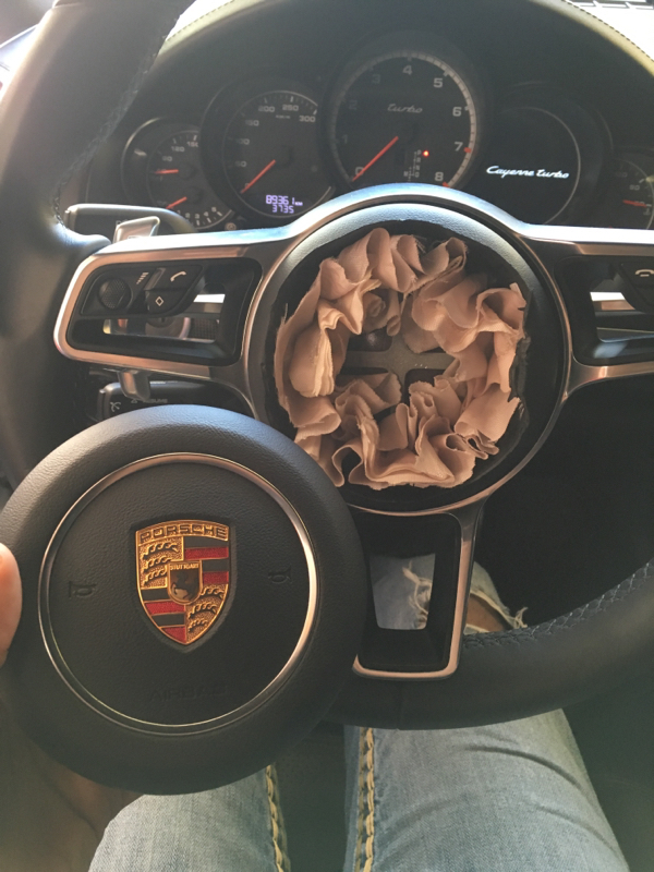

Originally Posted by Gtrust
It has headlamp wash, heated wheel, std cruise (not radar), radio and telephone control, no voice recognition. Thanks
ah same as me. I'll give you my part number, will work for you.Name:  image-637788923.jpg
Size:  419.5 KB Name:  image-3963418316.jpg
Size:  444.2 KB Name:  image-942671458.jpg

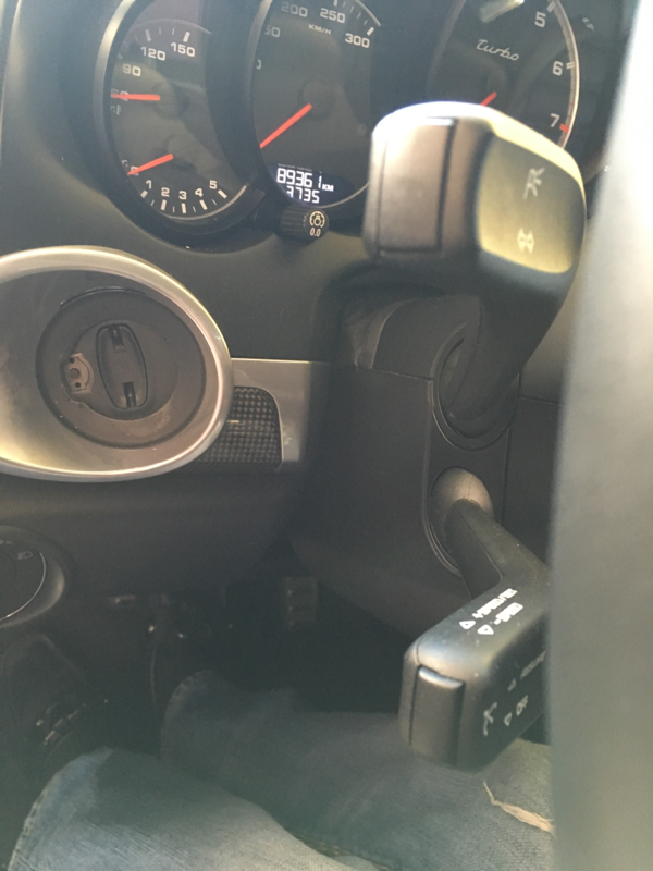

Gtrust,
Clockspring only, non heated
Part Notes: MODULES & SENSORS, W/O HEATED WHEEL : 95B-953-568-B
Clockspring only, heated
Part Notes: MODULES & SENSORS, W/HEATED WHEEL : 95B-953-568-C
This parts are the same for the 2015-16 Cayenne and Macan.
REMEMBER... REMEMBER... REMEMBER
DO NOT THROUGH AWAY YOUR OLD LEVERS, check my recent posts to know why. You'll need to swap the old high beam lever with the new one. Otherwise you'll lose high beam function. 2011-2014 Cayennes do not have electronic high beam.
