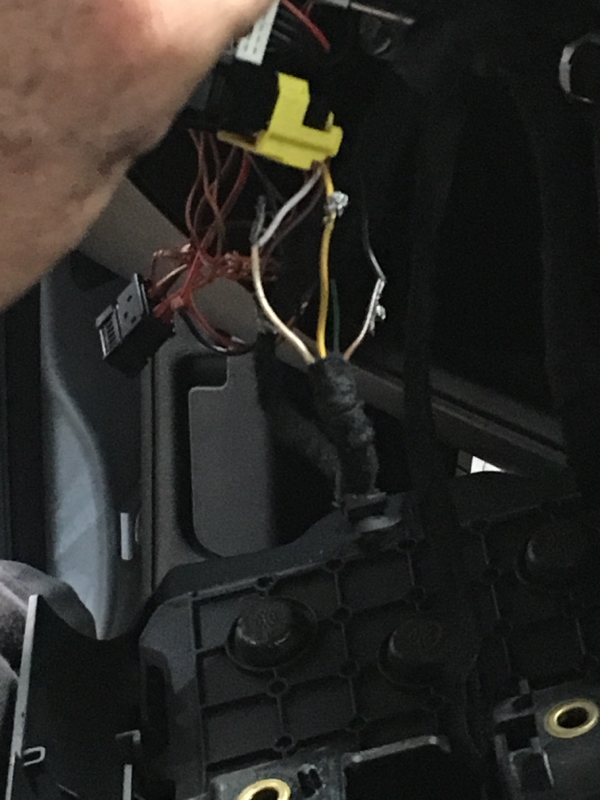

Also people need to know that they'll have to cut, splice cables. This is not a DIY mod.

(((( why that way??? are your dealers didnt hear about crimped pins connectors??? and pin unlocking tools? sorry man but thats awful...
yes I know.. When I got here was too late
it was stupid yes...
